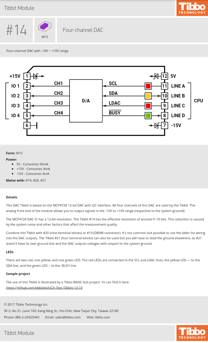

Only bringing this up as a FYI.
I did a search and found no mention of it but it's a cool 12 bit, I2C, 4-channel DAC. I have it doing rail-to-rail, +/-10v.
The default settings are perfect for my application and so I have no library to post at this point. Maybe I can revisit when the heat is off.

Tinine
Joined: 30/03/2016
Posts: 1646
Posted: 08:42pm 21 Mar 2021
Yeah but from one of these devices which I am kinda impressed with:

Tinine
Joined: 30/03/2016
Posts: 1646
Posted: 11:23am 22 Mar 2021
I should have mentioned that the 4728 is incorporated in a "Tibbit" module from tibbo.com.
Converter:
Yes, I have found the same characteristics with other converters as well.
It's not a problem (although I don't intend for this device to go any further than my proto board) because this is a closed-loop motion controller and my PID loop updates the DAC every 2ms to track the motion trajectory. Industrial servo drives accept a +/-10v motor command.

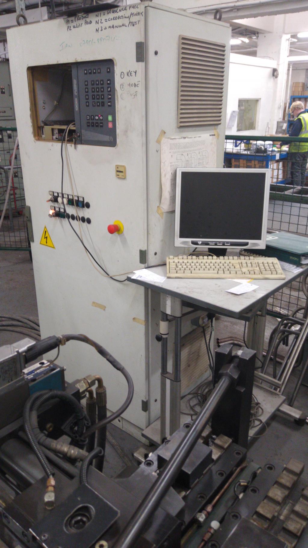

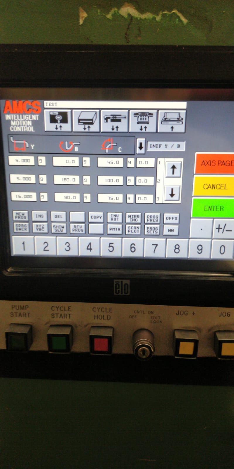

  Volhout said  A PC supplied 30 years ago ....
Must have been running MSDOS. Yes, those machines where near indestructable, only the media interfaces (floppy, maybe harddisk) might have wanted attention, and the fan (in the power supply, not on the CPU at that time). But if it had been running 24/7 this kind of lifetime is possible. The fan would have stopped 10 years ago, but the power supply would have survived for another 10 years.
It is hard to imagine, but there are still MSDOS applications running these days....
Yeah, MSDOS, puny CPU and 1MB RAM. Microtouch capacitive touchscreen and EGA (640 X 350) graphics. Hard drives always worried me so I created a RAM drive with the upper 384K RAM and stored my GUI screens there to avoid accessing the drive.
This one in Ohio got a new drive and an ELO-Touch monitor in 2019 and it's good-as-new.
Posts: 6118
Posted: 11:50am 23 Mar 2021
OK, this is for a wire bending machine (spring bending).
