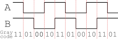

vegipete
Joined: 29/01/2013
Posts: 1185
Posted: 06:11pm 22 Mar 2021
  motogeek said  My thought is to use an analog joystick on two analog inputs (for x and y) and output a pulse stream on two pins (for the A and B signals)
  Quote  Axis selection will be done in code to determine which axis will listen to the A and B signals
Some clarifying is needed here.
A joystick is a two axis device.
An MPG is a single axis device.
Do you want the MicroMite to send or to receive a single quadrature signal? My impression is you want the 'mite to SEND the signal, and you want the 'mite to read the joystick to determine exactly what to send.
A picture always helps: (from the web)
This shows us that the 2 pins outputting the signal have the repeating sequence of values 0,2,3,1
The PORT command is ideal to output this.
DO
  PORT(<pinnum>,2) = 0
  PAUSE 0.5
  PORT(<pinnum>,2) = 2
  PAUSE 0.5
  PORT(<pinnum>,2) = 3
  PAUSE 0.5
  PORT(<pinnum>,2) = 1
  PAUSE 0.49
LOOP
This should output a quadrature signal on pins <pinnum> and <pinnum+1> at about 2 kHz. (I fudged the last pause command to account for loop overhead. YMMV) For the reverse direction, send 1,3,2,0.
This should be checked with an oscilloscope to confirm the signal is clean and as expected.
I would store the 4 values in an array, and step through the array.
Also, a differential signal would easy to generate by extending this to 4 pins in a row and using the sequence 12,6,3,9. (Examine the binary representation to see where these come from.)
