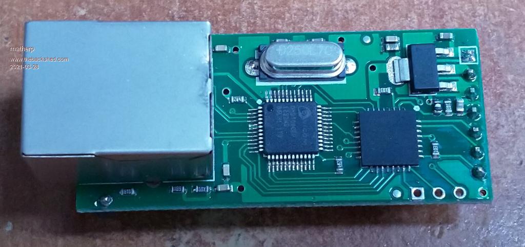

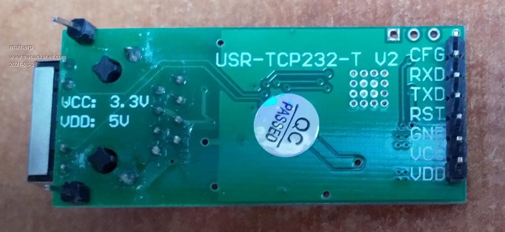

Posted: 07:26am 28 Mar 2021
  Quote  Out of interest, matherp, have you used the module you linked to above and if so, how easy(or not!) did you find it to work with?
Yes, ages ago, but I can't remember any issues. The device has been around for a long time which is good.
Lots of info here
Edited 2021-03-28 17:39 by matherp

Posted: 10:20am 28 Mar 2021
Excellent, thanks!
EDIT: So these modules want a dual supply, yes?  IE: 3v3 and also 5v?  That's what I interpret from the bottom silkscreen.
Edited 2021-03-28 20:25 by Grogster
Posts: 11512
Posted: 10:29am 28 Mar 2021
No - just connect to the one that works for you
