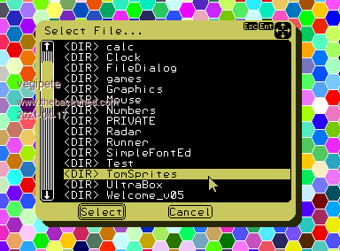

Before I get too far into the weeds, here is the current development state of my GetFile dialog box software.
This latest rendition works with a mouse if available. Adjust line 15 to suit your mouse or none. Could those with a Hobbytronics mouse interface test and report?
DIM MousePort = 0     ' mouse port, set to -1 if no mouse
For keyboard use, the arrow keys move around the directory structure, [Enter] selects an item and [Esc] cancels. Slightly unusual is that right arrow on the top item [..] goes UP one level.
For mouse use, things are pretty much GUI normal. The wheel rolls the directory list up and down, single clicks hilite items, double-click either selects an item or changes directory. The scroll bar on the LEFT isn't usable yet. (Yes, left side is weird but I have my reasons.) To select a directory, you must hilite your choice, then click the Select button.
Directory select functionality is not quite right yet. Selecting [Root] or [..] doesn't perform properly.
Comments, suggestions and bug reports appreciated. Thanks.

Hi Vegipete,
Good to see you're picking this up again.
I don't have a mouse so I set MousePort to -1.
The Dialog box opens but no directory is shown. The program hangs.
Here's the trace (after I pressed Ctrl-C):
> trace list
[733] [734] [733] [734] [733] [734] [733] [734] [733] [734] [733] [734] [733] [734] [733] [734] [733] [734] [733] [734] [733] [734] [733] [734] [733] [734] [733] [734] [733] [734] [733] [734] [733] [734] [733] [734] [733] [734] [733] [734] [733] [734] [733] [734] [733] [734] [733] [734] [733] [734] [733] [734] [733] [734] [733] [734] [733] [734] [733] [734] [733] [734] [733] [734] [733] [734] [733] [734] [733] [734] [733] [734] [733] [734] [733] [734] [733] [734] [733] [734] [733] [734] [733] [734] [733] [734] [733] [734] [733] [734] [733] [734] [737] [738] [739] [740] [742] [743] [747] [750] [751] [754] [755] [756] [759] [760] [761] [762] [763] [764] [762] [763] [764] [762] [763] [764] [765] [768] [769] [771] [772] [773] [775] [538] [848] [849] [850]
I ran it on the following directory:
list files
A:/ghost
21:34 03-04-2021       1811  ghost.bas
21:34 03-04-2021      12709  Ghost.png
21:34 03-04-2021      14506  Part02.png
0 directories, 3 files
I'm using FW version 5.07.00b23.

  epsilon said  The Dialog box opens but no directory is shown. The program hangs.
[snip]
The trace is quite useful - thanks.
The firmware version is the issue. (Fixed in b25)
If you change line 850 to
  do : loop until getscanline < 5
it should work.
If still no go, add a "MODE 2,8" command at the start of the program.
Edit: "at the start" means anywhere _before_ line 68. See Matherp's posting about 2/3 down page 4 of the firmware update thread.

Works good with my HT adapted mouse, with the added bonus, that a single click of the scroll wheel takes me to the top or bottom of the list! You have plans on allowing the up/down arrows to be clickable and the bar draggable? That would be really nice, given my wonky scroll wheel firmware!

Works well with my PS2 mouse and Ver. b27 Pete. Only v. minor comment (after a short session). Might be good to tab one or two spaces for the sub-directory list when a subdirectory is displayed; leave the top 'root' at full left.

The workaround at line 850 works. Thanks!
I'm using an earlier version of Ultrabox in xedit. I added a rudimentary option to create new files in the dialog box. I'll reintegrate your version if at some point you decide to add such a feature. I doubt I'll ever add mouse support though.
