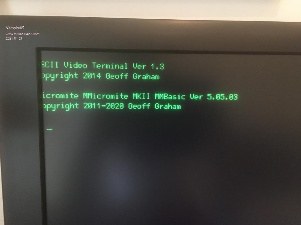

Hello people,
is it possible to resize / shift the (VGA) video image on the ASCII Video Terminal. The first two characters are not visible:
PS: My monitor has no options to adjust the image

  Vampire05 said  My monitor has no options to adjust the image
That cannot be correct, at least you should have an "auto set" button or something similar.
The short answer is no, you cannot change the video timing.
Video is generated by (mis)using the SPI interface on the PIC32 chip and that is limited in the timing that it can use - and that in turn determines the alignment on the screen.  Remember, the whole terminal is contained in a single chip costing $4, it is amazing that it can be coaxed into generating VGA video in the first place.

Hi Geoffg, thank you for your answer.
My Monitor is not a really monitor, it is a cheap tv with vga input
So, its ok. I will take an real Monitor.

A TV might have a setting for 'overscan' or 'underscan'
When used as a TV, it will be overscanning causing the edges to be lost.
Some TV's have a setting for 'PC' which is the same as 'underscan' where the image is shrunk so the edges are seen.

Also check if the TV has a "zoom" or "scaling" setting. Sometimes setting that to Normal or Full fixes it if you don't see an overscan setting.

Posted: 09:05am 22 Apr 2021
I have checked all TV Functions, no zoom, no over-/underscan. It is a very cheap TV   Now i use an old Computer Monitor. This works perfectly! Thank you for help guys.
