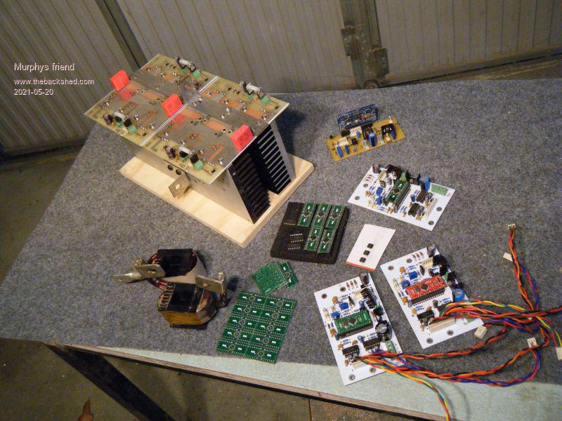

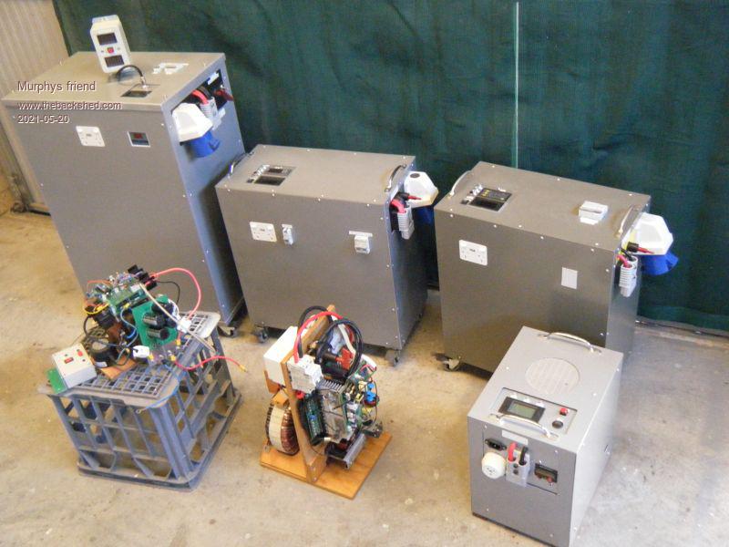

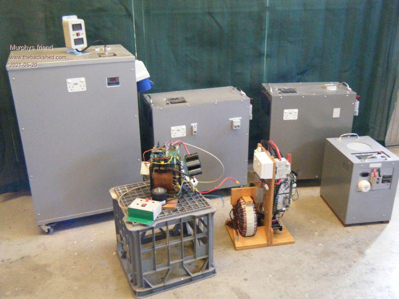

I finally got that troublesome warpinverter going again so I thought I line up all my inverters for a picture
In the back row on the left is the warpverter, a bit of a heavyweight at  over 150kg. The top & bottom covers are a recycled aerosharp box lid which gives you an indication of its size.
Next to it is my 6KW nano inverter with the opto isolated driver, as seen in a recent post here. That one weighs around 75kg with its double stack core and 90mm sq primary winding.
Then my 3KW inverter, same drive as the 6KW. Still too heavy to  lift, its also on castors .
Last in the back row is my 1.5KW inverter which also has drivers like the two bigger ones. There was a post about this one a while ago. I can manage to carry this one .
In the foreground, on the milk crate, is a small 4 mosfet test inverter I built when Poida first came out with the nano. I made that to experiment with that  idea.
Last, on the plywood frame, is the inverter that started all this craze. It is   the 8KW (Chinese KW) Powerjack inverter module that oztules et al used to make home built inverters that perform better than the factory versions.
I had used that inverter for some time, with a bigger toroid, when it was shoe horned into an Aerosharp box. But the constant fan noise eventually started me building my own inverters from scratch into suitable bigger enclosures.
I might make a suitable enclosure for it so it can be used plug in like all the others.
Having all inverters plug in makes change over time less than a minute, not that I anticipate any more blow ups , had my fair share of those.
If anybody likes to see more details, I do have more pictures .
Now I think I'm done with inverter building. After all, I have a spare for the spare now. Only two inverters are used at a time, a big one for the power and a small one for the lights of my house. Its off grid now but has the connection to it maintained.
So, there are a few freebies to be had which should get a newcomer well on the way to build an inverter. See picture below. Local pickup, Perth WA only.

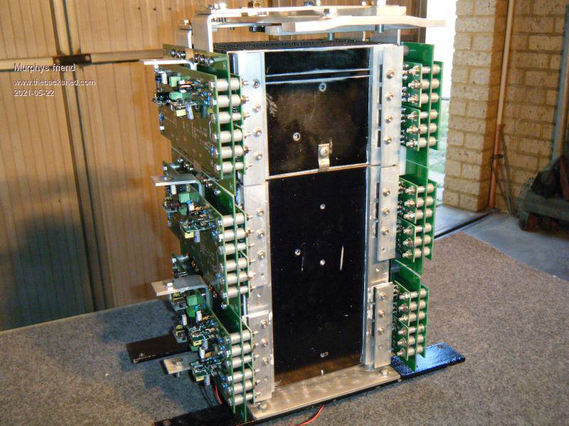

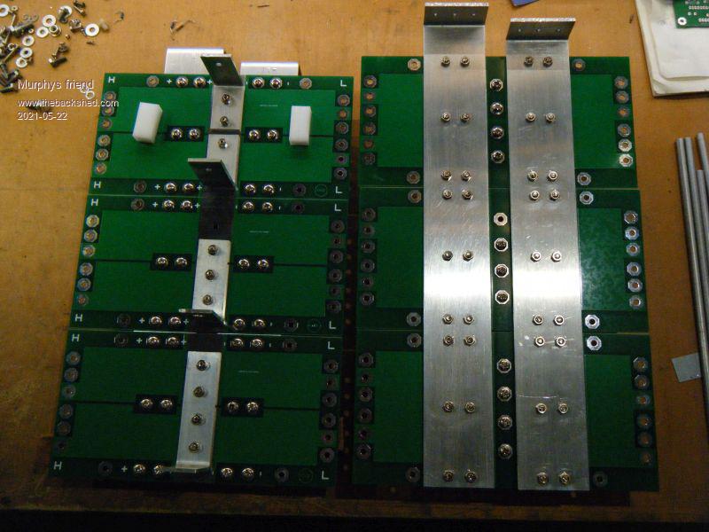

Tony, you are probably right about those connectors, I replaced them with nuts & bolts .

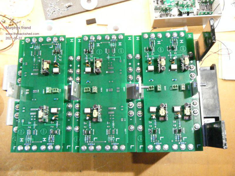

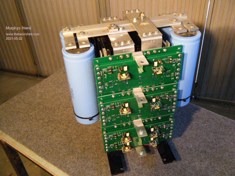

A few pictures, first the power PCB half bridges, each side shown.

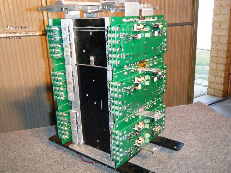

Then with the driver boards added.

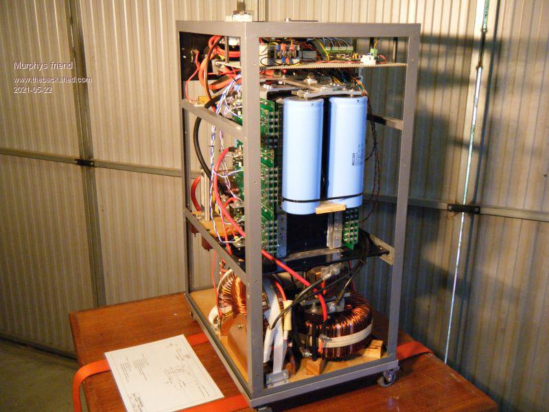

Now the rest of the guts.

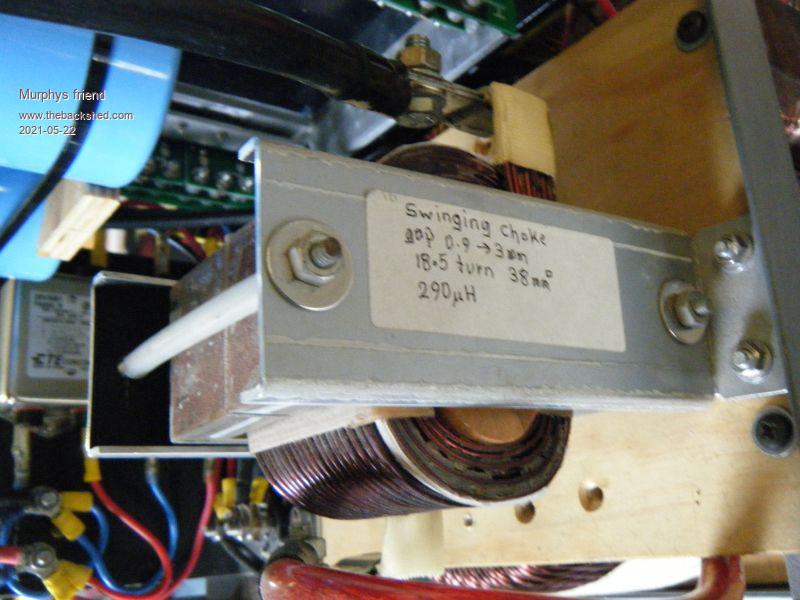

A picture of the swinging choke at the big transformer. There is another choke at the second transformer.

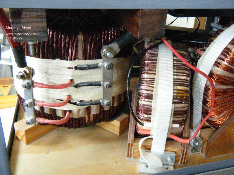

And last a pic of the big transformer
Posted: 09:39pm 21 May 2021
Those nuts and bolts certainly remove any doubt as to any intermittent gate connections !
A great effort, its very difficult to design a neat practical layout running so many mosfets in parallel.

Hi Kaus, sorry to revive an old thread but I was trying to work out what you did with the chokes in your Warpverter  ...
  Quote  A picture of the swinging choke at the big transformer. There is another choke at the second transformer.
What problem were you solving by fitting them  ... and exactly where in the circuit were they. I noticed Alston used one as well but I never understood why it was needed.

Hi Roger, you do like trolling through my old threads .
That choke was in the primary of the big transformer. This has a tremendous kick with the 50Hz square wave. Perhaps it's because I use a 48V battery bank, warpspeed says that with his 100V battery bank he does not see a need for a choke.
Anyway after feeding handfuls of HY4008's to this monster I decided a choke may help.
Building this warpinverter was an interesting, enjoyable but (compared to my other inverters) expensive task. Running it has been one frustration after another, so much so that its now in pieces again and I'm seriously thinking of using the big transformer to make an EG8010 or nano based inverter. Not that I need another one - it's just that I like building them.
