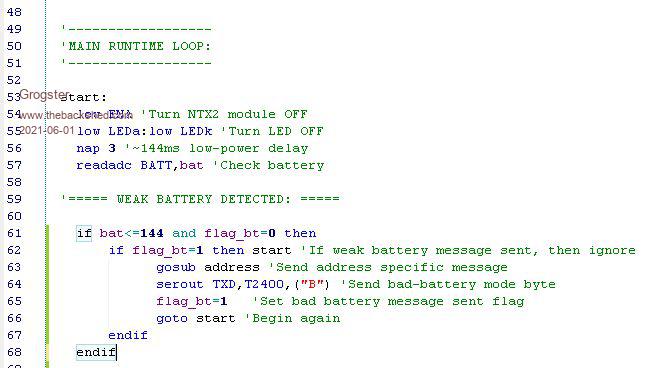

Hi all.
Every now and again, I need to revisit a PICAXE project, and this one has me scratching my head.
I tried to tidy up some old code, by making sure there were ENDIF statements at the end of all the IF's:
PE6 is happy with this - note it highlighting the IF/ENDIF section of code.

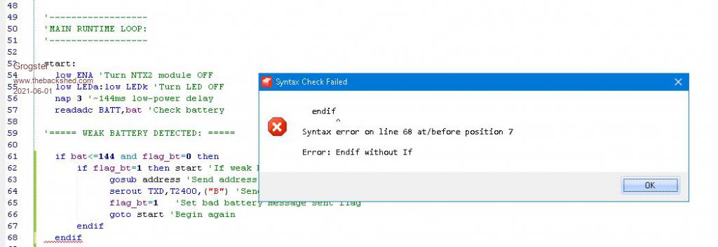

However, when I click on 'Check Syntax', PE6 moans that there is an ENDIF without a matching IF:
This section of code is right at the top of the program, and it is the very first IF/ENDIF in the code, but there are many more.
I had to COMMENT OUT every single ENDIF, before the code would pass the syntax check.
This is odd.
I am very rusty on my PICAXE code now, as everything I do is Micromite now, but I still have a few older projects using PICAXE chips, but I figured the structured code would still be the same....
Anyone here who uses PICAXE regularly who can help me understand why the IDE likes the IF/ENDIF structure, but the syntax check does not?  One contradicts the other.
Posts: 6538
Posted: 07:31am 01 Jun 2021
line 62 looks like a single line IF
try
IF flag_bt = 1
start
ELSE
ENDIF
Posts: 9975
Posted: 07:45am 01 Jun 2021
AHHHHHHH!!!!!!!
Too long away from PICAXE and too much time with MM now!!!!
Going back to PICAXE just for a little while, is quite a change!
So used to the MM now.
Thanks for the prod, that seems to be where the mistake is, cos it is now working as expected.
