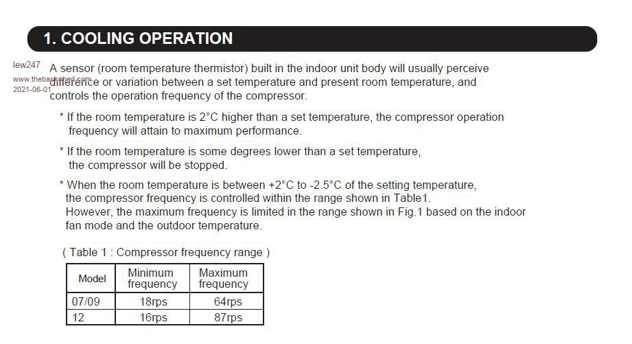

Does anyone have any knowledge of airconditioners?
I have a split unit Fujitsu and the room temperature does not go as low as I'd like it to.
The unit is a 1200BTU unit and plenty bog enough for the room it's in.
There are 2 thermistors in the wall unit indoors
One for measuring the room temperature and one for the indoor heat exchanger
I was going to try and make a wifi or bluetooth thermostat to control the aircon unit but there is no return feed from the IR so there is no way to attach it as far as I can see.
The one thing I did think of was replacing the thermistor for the room temperature with a proper temperature sensor and simulating the resistance somehow and possible being able to remote mount the temperature sensor nearer to where I sit rather than having it inside the aircon unit itself.
Does anyone have any ideas or suggestions?
I've found this

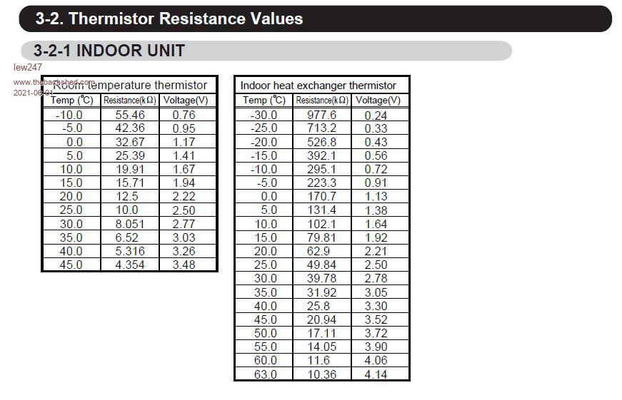

and here are the resistance values and voltages for both thermistors at various temperatures

A trick I have used is to fool the system into thinking the temp. is a little higher than the actual temp by adding some resistance in series with the thermistor.
Measure the resistance of the thermistor at both the lowest setpoint and at the temp. you want, then add a resistor equal to the difference. You will have to remember the temp. offset when changing the setpoint.

Oops! I got it backwards. You need a parallel resistor to reduce the setpoint.

Its set to it's minimum of 18C but where I sit in the room the temperature is around 21.6C
I'd like to move the thermistor externally to the unit so it measures temperature in the actual room and not at the airconditioner unit itself.
It's frustrating because I did a lot of research yesterday and other models in the same line have external temperature control displays with temp sensor inside it as an option, but my model doesn't
I'm guessing if I opened up the unit the expansion port would possibly be there but it's probably not enabled in the programming so it would be a waste of money buying one.
I think the best idea so far is to measure the resistance of the thermistor, and if it is working properly, try and move it outside the wall unit by extending the cable
not certain this would work but worth a try.
