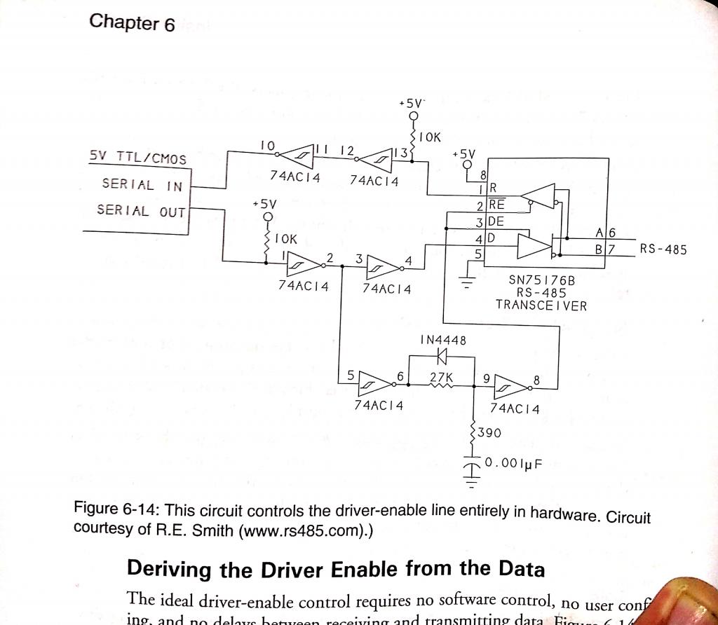

I seem to remember posting this some time ago:
Posts: 7873
Posted: 06:07pm 17 Jul 2021
That's a very neat idea! I like that. :)
Posts: 5063
Posted: 09:01pm 17 Jul 2021
The timing in that hardware circuit works only at the baudrate it is designed for. And it may not work with slaves that respond too fast.
Not saying this is no good, but it is designed for an application.
Posts: 7873
Posted: 09:47pm 17 Jul 2021
Cheaper on wire to switch it in software and use another pin. :)

  Volhout said  The timing in that hardware circuit works only at the baudrate it is designed for. And it may not work with slaves that respond too fast.
Were that an issue, it would be my opinion that the mistake was to go half-duplex.
My own systems are multi-drop 485/422; the master has the Tx enabled permanently.
All command/response and the slaves share the Rx line.
