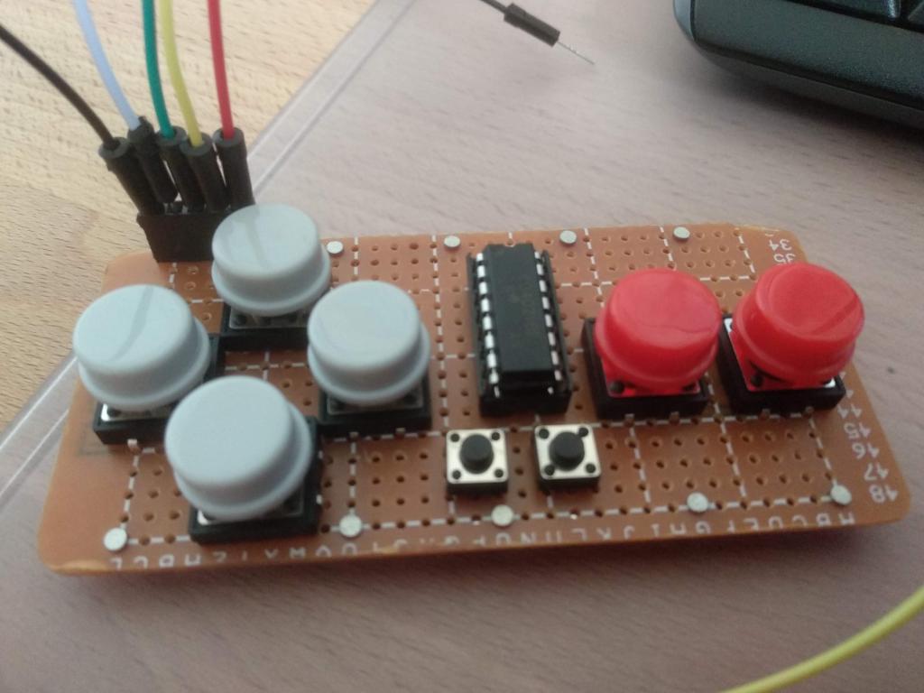

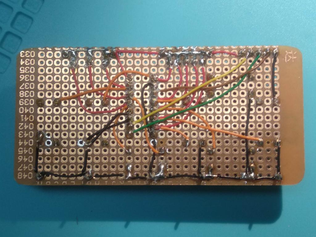

Hi folks,
As I indicate semi-frequently I'm a software guy not a hardware guy so haven't done much of this and I'd be interested in any feedback (I know that the some of the wires have bare metal tails that need clipping) or any discussion of prototyping techniques that it might prompt:
Just in case anyone wants to try and guess I won't say what it is yet other than it is for interfacing with the Picomite and there are no connections on the top surface, only components.

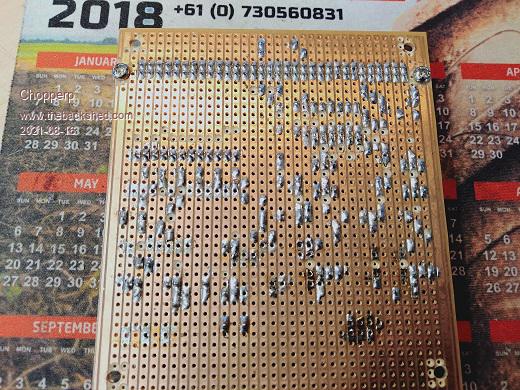

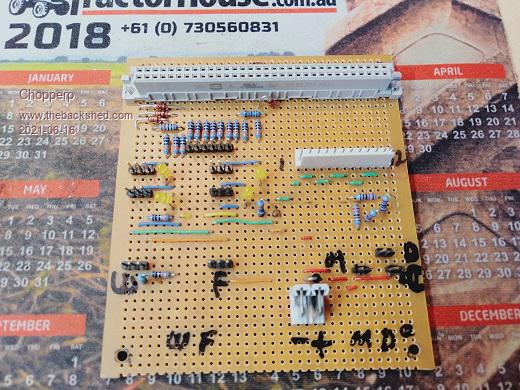

Hi Tom,
From my limited experience of using that type of prototyping board, it's not a bad effort. I don't like the stuff that much. I like at least some strips joined together.
I prefer to use the Vero or Strip board as shown in an old board below I found in a drawer. I'm used to using this type & it is a bit more forgiving with the soldering & wiring.
I also use a program called VeeCAD to help with layouts. The program can accommodate various types of prototyping boards of different sizes including the type hitsware2 has shown above.
I know quite a few hobbyist etc go from the breadboard design straight to a PCB.
We've all started from somewhere. If it works & reliable, it's good IMHO.

  thwill said   I'd be interested in any feedback (I know that the some of the wires have bare metal tails that need clipping)
Nothing wrong with that work at all. I also agree with Veroboard, once you get good at layout it's one of the fastest and neatest ways to do a quick prototype, but like everything it depends on how you use it, some people hate Vero.

It is a 16 pin dil chip with serial data in and parallel data out. I will do some datasheet checking, but my first guess is that it is a 4017,
Ahhh, no, it is a keyboard

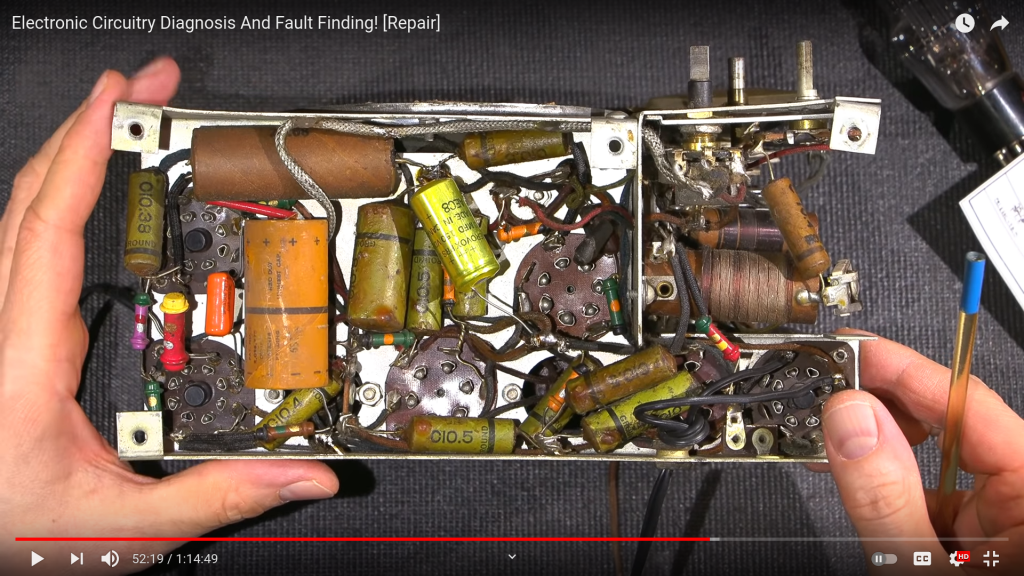

Nice job Tom
Have you seen radio circuits from the '30s or '40s? Your board is pretty organized
The following image is from Mr Carson's Lab YouTube channel https://youtu.be/LC7OjuYAOQE

Pinout doesn't look right for a 4017.
There appear to be pull-ups on pins 1,4,5,6,7,13,14,15
You might guess that pins 3,9,10 are clock, data and latch, in some order. Pin 2 could be reset or enable. Nothing obvious to me yet...
Or it's not a chip at all but a connector.
Good puzzle!

Hi Thwill,
It is a HEF4014 (or 74HC4014) 8 bit serial IN shift register connected to 8 keys (pullup, switch to ground).
The Shift-IN pin is grounded.
Parallel load and shift clock are wired to the header, as is Q8 (the last flipflop output.
As it is wired now, I expect the current consumption to be rather high, becuase you also grounded output pins Q6 (pin2) and Q7(PIN 12). Normally these are left not connected.

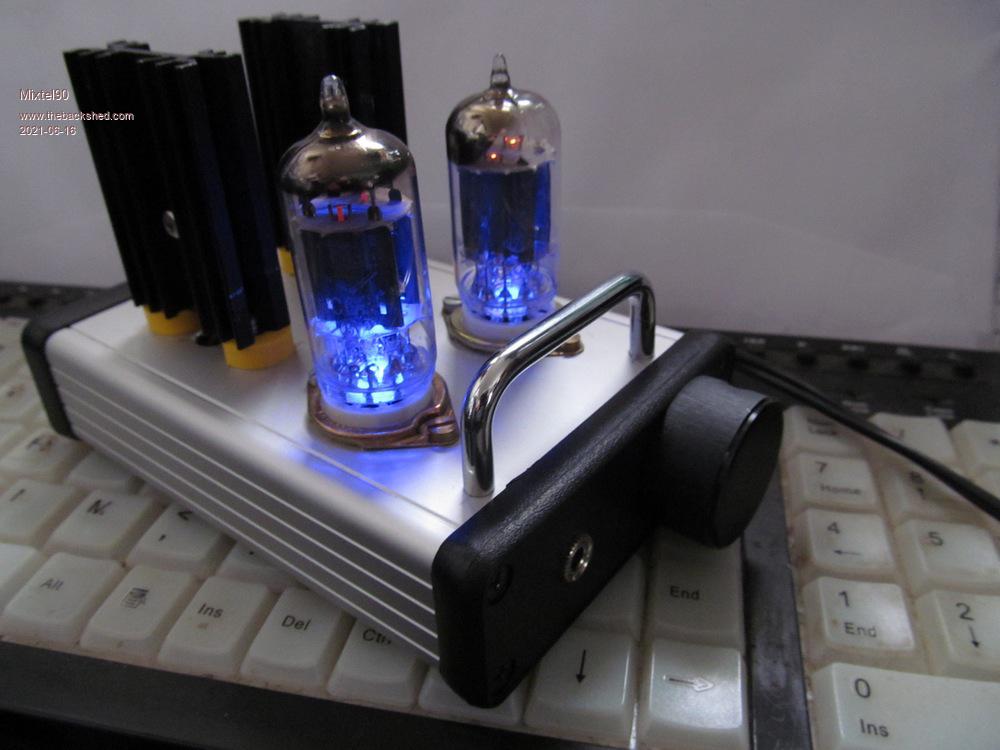

Posted: 06:50am 16 Jun 2021

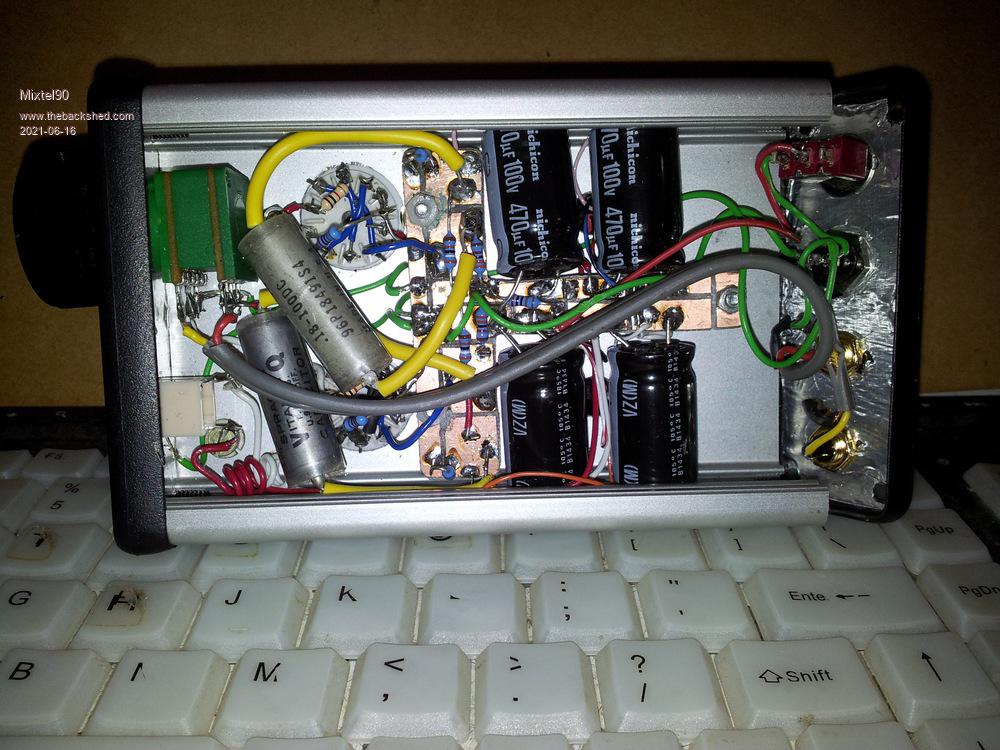

Oh yes! I've worked on stuff like that, Leo. :) Actually, I've built stuff not much better... lol My headphone amp has a couple of valves.
For the smaller stuff I usually use stripboard, but I'm using a padboard for a little auxiliary power supply at the moment - and not enjoying it very much. I think I'll make a PCB for the main board. It's more work but probably worth it in the end.

Aaaahhhhhh.... that hurts.....
A set of ECC8x's directly driving headphones.... (12AX7 - ECC81 ?)
These are pre-amplifer tubes that are designed for few mA and high impedance anode resitors (50k/100k)...
The power is Okay (they will do 0.5 watt or so) but there is no output transformer to match the headset (32 ohm / 600 ohm ??).
The build is nice. It is always hard to get a lot in a small space. But you managed to do so, and still have it "servicable". Making a PCB will not be easy, since the space is tight.
Edited 2021-06-16 17:14 by Volhout

Nope.
A pair of paralleled ECC82s as inputs, driving mosfet output stage in common source mode. The valve series heater is the source resistor for the mosfet and the headphone output is tapped off that junction. The mosfet is adjusted to pass 150mA. The beast runs from a 48v HP printer power supply. Pure inefficient class A. :)
The "T" shaped PCB was the only sane way I could think of to fit the capacitors in the case. They were a little larger and the case a little smaller than I'd anticipated. lol
Oh - I see your confusion... The PCB I'm considering making is for a bench power supply. Different project, but one that uses a MX170 and display for the controls. Which brings me nicely back onto topic. :)
Edited 2021-06-16 17:23 by Mixtel90

Posts: 9329
Posted: 08:06am 16 Jun 2021
These actually do something. The mosfet output stage, because of its arrangement, has a maximum gain of less than one. What it does do though, is convert the high impedance at the valve's anode to a low impedance for the headphones. The valve gives all the necessary gain in the circuit. Using the heater as the source resistor was a very clever idea by the designer as it dissipates about 1.9W and in this case that's not wasted heat.
The original valves went very scarce - and were never really available in the UK anyway. A later version used the ECC82/12AU7 because it's reasonably linear with only a 48v supply.
The "Starving Student" headphone amp: http://www.pmillett.com/starving.htm

Thank you to everyone for their comments.
  Volhout said  It is a HEF4014 (or 74HC4014) 8 bit serial IN shift register connected to 8 keys (pullup, switch to ground) ...
And the winner is @Volhout, specifically it is a CD4021BE - I hope one day I know enough to manage that trick:
  Quote  As it is wired now, I expect the current consumption to be rather high, because you also grounded output pins Q6 (pin2) and Q7(PIN 12). Normally these are left not connected.
Thank you, that shows the danger of having only a little knowledge ... I'm sure I read that unused pins should be grounded, or is that a different logic family, perhaps 7400 ?
  hitsware2 said  You tried your circuit on one of these first , right ?
Yes, my first prototype was on solderless breadboard, a bit unwieldy as a controller though
  Chopperp said  From my limited experience of using that type of prototyping board, it's not a bad effort. I don't like the stuff that much. I like at least some strips joined together.
I do have a big piece of Veroboard but in my very limited experience I found it rather restrictive. I think my preference would be the perfboard with power-rails, but (a) I had this Chinese krud in stock, and (b) I wanted a very specific size.
Thank you for the VeeCAD link, that looks very useful - even if it does mean more time infront of a screen. I went through several pages of paper perboard planner on this, and in the end winged much of it.
  Quote  I know quite a few hobbyist etc go from the breadboard design straight to a PCB.
I've not done any PCBs yet, though it is to come on this project. I suspect I would need the perfboard prototype to help me decide whether any given trace should be on the top or the bottom of the board ... plus I enjoyed the fine work ... though I'm not sure my eyes will be up to it for much longer.
