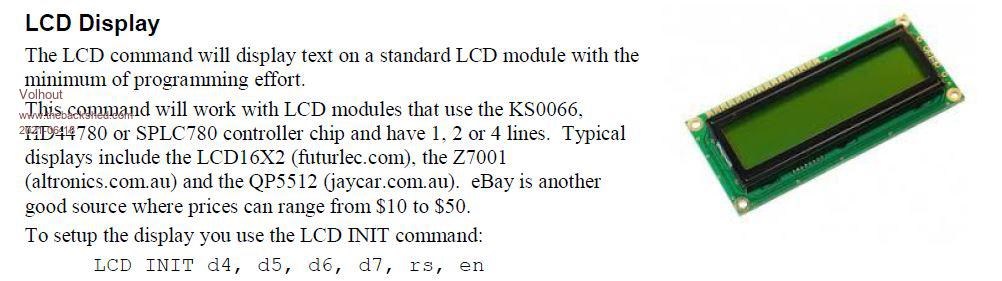

I don't think it is that easy. The ILI display will also have different mm.hres and mm.vres. You are looking at a very complex piece of code on your part (the basic stuff) and a complex piece of code on Geoff's part. (dynamic switching screens, or full dual screen support).
I guess your option to use a MX170 backpack is easiest to implement.
Another option could be is to write the text to a 1602 LCD. That could work independent of the SSD1963 since the commands are completely different, as is the hardware interface.

With the LCD display you also have the option of using the i2c version and only using 2 pins. The driver can quite happily live in the library on a Micromite and, although it doesn't share the same commands as a graphics display, is straightforward to use. If you can't find a i2c version then there are very cheap adapter pcbs on ebay.

I did read the thread you had on TBS some time back about running two identical displays with interest. They only need to be electrically identical, so I could have different physical sizes. The only modules (800x480) I've seen on ebay are 7", 5" and 4.3" with the latter having an unknown pinout.
The screen initialisation code (in MMbasic) resets the display when called. I wonder if I could have a CSUB version that does everything but - ie: sets resolution etc for MMbasic to interface with, but does nothing to the screen itself, leaving whatever pixels are on it entirely alone. It would likely work with different screen types too:
Startup code initialises both screens using "OPTION LCDPANEL ..."
Loop code switches with CSUBs 'Use_SSD' and 'Use_ILI'
Like many are saying, that is starting to get complicated. A backpack hanging off a serial port (which could be something other than a UART) sounds like the go, and wiring a serial port & power is far easier than duplicating a parallel port.
Good point about the character LCD modules, although I am looking for something with a bit better display ability (probably half a dozen text lines). And colour is definitely nice: green for normal messages, red for bad messages.
