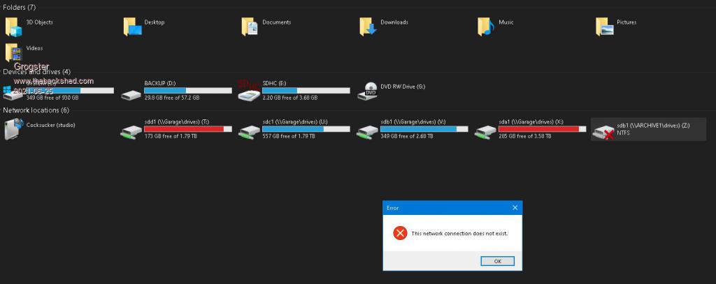

Sigh.....
THIS is why I have moved all but one of my machines to Linux:
Technically, W10 is correct - that share has been removed, and the PC running it is now offline.
So, I try to REMOVE it with right-click/disconnect, and I get the error above - which, as I say, is technically correct.
How do I remove this reference?
BEFORE I shut down the server with this share, I right-click/disconnect(ed) all shares on the box, but this one has resurfaced AFTER I successfully disconnect it - and now I can't get rid of it, cos W10 says it does not exist - WHICH IS CORRECT - so how do I stop W10 from insisting that it is there, but not connected anymore?
Sigh........
Linux does NOT have this issue.
If I remove a share using Simple SAMBA Management - it's gone as it should be.
I KNOW that you are supposed to DISCONNECT shares on Windows BEFORE you actually remove them to avoid this kind of crap, but I have actually done that, and yet W10 still insists that the share is still there, and won't let me remove it, cos it can't disconnect from it, cos the box is no longer on the LAN...........

Posts: 6538
Posted: 07:54am 25 Jun 2021
From the command line.
You may have to run as administrator to change things.
NET USE
[devicename | *] [\\computername\sharename[\volume] [password | *]]
       [/USER:[domainname\]username]
       [/USER:[dotted domain name\]username]
       [/USER:[username@dotted domain name]
       [/SMARTCARD]
       [/SAVECRED]
       [/REQUIREINTEGRITY]
       [/REQUIREPRIVACY]
       [/WRITETHROUGH]
       [[/DELETE] | [/PERSISTENT:{YES | NO}]]
NET USE {devicename | *} [password | *] /HOME
NET USE [/PERSISTENT:{YES | NO}]
so
NET USE pathname /DELETE
should do it, or has for the last ~30 years that I know about.
Posts: 9975
Posted: 08:37am 25 Jun 2021
YES - THAT WORKED!
THANKS, JIM!!!!
I should still NOT have had to jump through those hoops just to get rid of a share that I had ALREADY disconnected BEFORE I shutdown the box with the share, but I appreciate the pointer, as that worked.

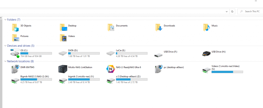

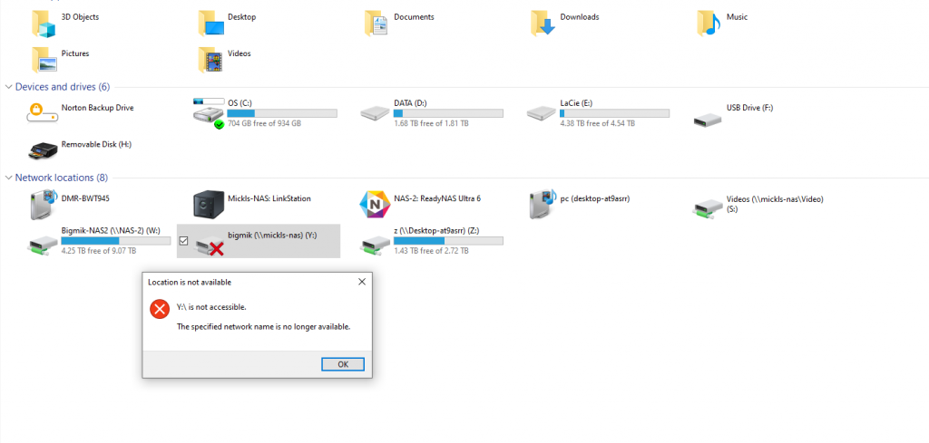

Posts: 2981
Posted: 04:28am 27 Jun 2021
Hi Jim,
My NAS doesn't get shut down only the PC.
I have had my PC on for at least an hour and I just checked. Those maps have not restored.
This image shows my Network drives and the error when I tried to open the bigmik share (mapped to Y:) the same happens to the Videos (S:) mapped share.
I cannot even RE-Map these shares but if I click on the ICON of mickls-Nas I can see and navigate to my shares.
I will reboot now and edit this post (or add a new post) to show the difference after a simple restart.
OK here it is after a Restart, as you can see the two shares are found and can be accessed, and you can also see the capacity used on each drive.
