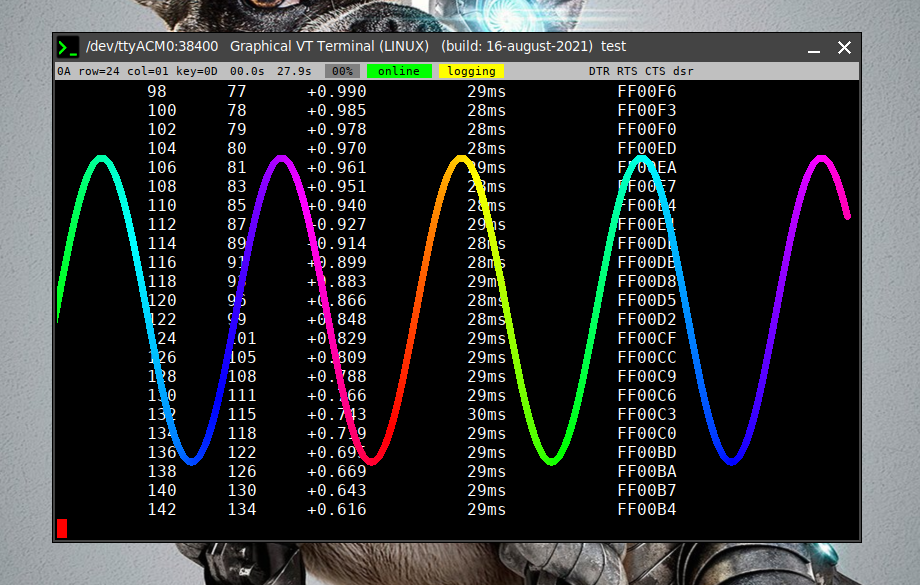

Posted: 02:22pm 15 Aug 2021
attached below, an update to GFXterm64 for 64-bit Linux:
GFXterm64 (16-aug-2021).zip
this fixes several small issues:
1. under Linux Mint 20.1 and 20.2 the screen could end up being 2 pixels per character cell too short, ie 48 pixels in total. this was an unfortunate interaction between Mint 20 and a bug in Lazarus, with the result of characters overlapping in the vertical direction. visible clipping would occur on lower-case characters with descenders: g, j, p, q, y, and some symbols. the fix was to obtain the dimensions of the cursor (on which all other screen measurements are based) in a different way.
2. under Linux Mint 20.1 and 20.2 the status bar was corrupted. this seems to have been caused by Mint 20 not supporting older type-1 fonts, and hence "Courier 10 Pitch" (included as part of X11) being no longer accessible to Lazarus (and likely other applications too). The fix was to switch to using the font "Monospace" instead.
3. the window 'fade-in' effect at startup has been fixed to remove a visible flicker on some systems.
4. the serial system has been completely reworked to become threaded. the most visible change here is that when a pi nano goes toes up, it no longer freezes up GFXterm for 30 seconds or so. instead the main loop of GFXterm keeps spinning, but no connection will be allowed until the serial threads (Rx and Tx) unblock.

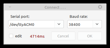

GFXterm64 can now display the pico's signon message, added especially for panky   :-)
GFXterm64 (22-august-2021).zip
to see the message, select 'CONNECT' as usual from the right-click menu, but then while clicking on the 'OK' button in the dialog hold down the 'control' key on your keyboard.
the dialog will remain open, and you should see a small countdown timer in the window:
you have 10 seconds to unplug and replug the pico, or to press the pico's reset button. when the pico is unplugged the countdown timer changes to green. 100ms after the pico is plugged back in, GFXterm64 will carry on and attempt to connect to it (assuming it reappears with the same port name).
upon the timeout reaching zero, GFXterm64 will likewise proceed with attempting to connect as normal.
this seems to work moderately reliably on Linux Mint 20.2. i also tried it on a Puppy Linux VM, but VitrualBox does not get the USB port back up quickly enough (there seems to be about a 900ms window) to catch the signon message. on actual hardware things may work better.
i've also made various tweaks elsewhere, most of which will go completely unnoticed! hopefully i've finally sorted the flicker on startup with systems such as Puppy Linux that do not support alpha blending (fade in and fade out of the window).
rob   :-)
Edited 2021-08-21 23:26 by robert.rozee

changed especially for Volhout (press alt-6 to scroll cursor and screen up), plus more reworking of timer routines to improve compatibility with Puppy Linux. the screen now keeps running in the background when dialogs (font, open, save) are displayed.
you can also press alt-8 to pause display output (incoming data is buffered). for those keyboards that have a scroll-lock key, this does the same. alt-6 is also mapped to alt-up on cursor keypad.
keyboard guide is also included as a .pdf file:
GFXterm64 (4-sept-2021).zip
PLEASE test and report back successes or failures!
rob   :-)
Posts: 5930
Posted: 08:58pm 03 Sep 2021
Hi Robert,
Works fine on Gallium OS (ubuntu amd64 bionic (18.04)) on my chromebook.
My other linux PC's are still 32 bits (older stuff doesn't run 64 bits).
Tried several of my gfx compatible programs (i.e. fft) and they all worked fine.
Also the editor in colorcode mode works fine. Haven't seen artifacts.
Thanks for the <alt>-6 combi key. Used it already few times.
