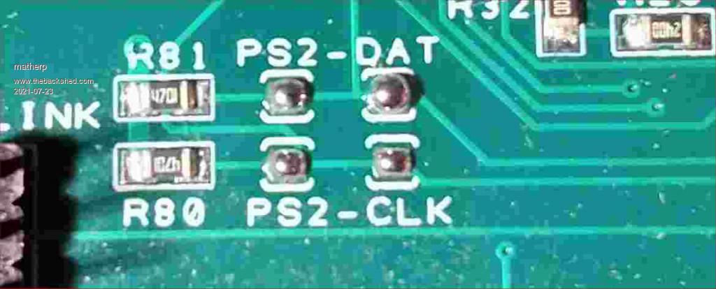

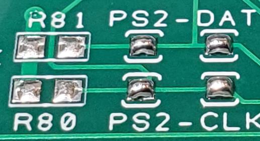

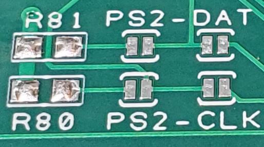

The directions say to connect all four contacts to use a PS/2 mouse with Gen 2. So one big blob of solder that touched all four contacts would work? Or did it mean to connect the contacts in two pairs?

Assuming you are talking about a standard G2 then there are 4 shorting links on the G2 board. Each of them needs a blob of solder. Two of the links connect the PS2 clock and data  lines to the requisite pins on the G2 and the other 2 apply pullups to 5V on those lines.

Note: R80 and R81 must be populated with 4K7 resistors (472 or 4701)

There are a couple of jumpers to solder for the PS2 so easy enough to undo if required.
