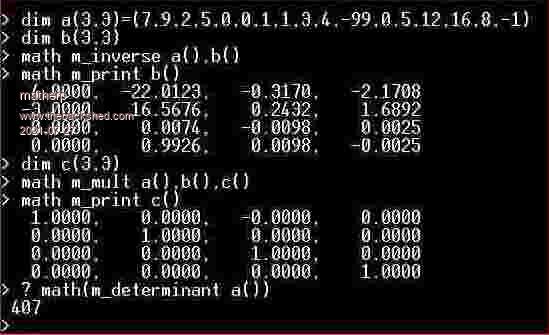

New math command
MATH INVERSE array!(), inversearray!()
This returns the inverse of array!() in inversearray!(). The array must be square and you will get an error if the array cannot be inverted (determinant=0)
New math function
MATH(DETERMINANT array!())
returns the determinant of the array. The array must be square

toml_12953
Joined: 13/02/2015
Posts: 424
Posted: 02:06pm 26 Jul 2021
  matherp said  Please download and test V5.07.01b1
Changes from V5.07.00
Full implementation of the GUI controls as per MM+ but using the mouse as the I/F (except GUI BEEP).
NB: the TOUCH function is renamed CLICK.
The mouse must be connected and working for the GUI commands to work and have been set up using the OPTION MOUSE command
Space for the controls must be provided using the OPTION MAXCTRLS n command
New math command
New math function
Thank you. This is great! For the inverse, do the arrays have to be different? IOW, would

Posts: 10181
Posted: 10:20am 30 Jul 2021
V5.07.01b4
Fixes bug when using mode 12 as the default
dim a(3,3)=(7,9,2,5,0,0,1,1,3,4,-99,0.5,12,16,8,-1)
dim b(3,3)
math m_inverse a(),b()
math m_print b()
dim c(3,3)
math m_mult a(),b(),c()
math m_print c()
? math(m_determinant a())
