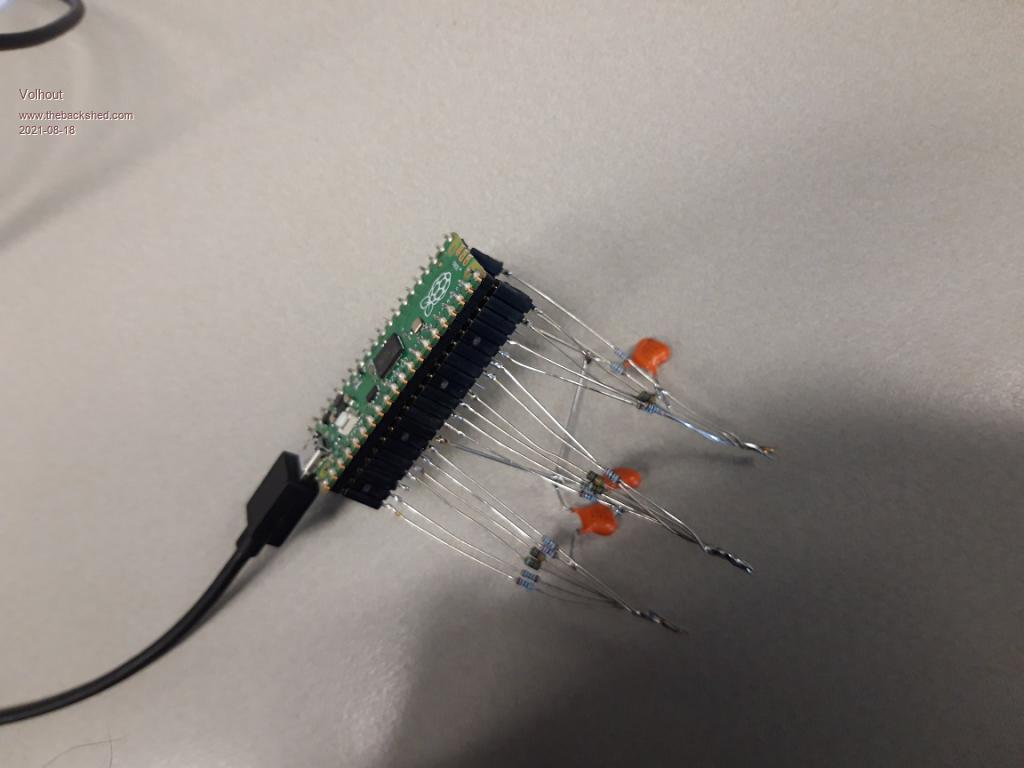

I have a quick solution in using the PORT command.
On the pico, using GP0..5 for phase 1, GP6..11 for phase 2, GP12..17 for phase 3
3x 6bit DAC's with resistors, and low pass filter cap to terminate (remove the DAC steps somewhat). The resistor DAC is particular accurate (1.1k, 2.2k, 4.3k, 9.1k, 18k, 36k), the filter caps are 1uF.
I create an array with sine, and sine shifted values.
An in a single PORT command I write the 18bits (3x6bits) to the IO pins.
Currently the program relies on the MMBasic interpreter execution speed (so any new compile may result in re-tuning). The output frequency (50Hz) is determined by the length of the array with samples. More data = lower frequency.
With default speed (125MHz) 210 samples result in 50Hz. No need to align the number of samples with a multiple of 3 (as a HW guy would do, to make exactly 120 degrees shift possible) since the sine values in the table are phase shifted with "float" accuracy...hihi.

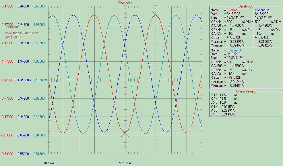

The test circuit:
The output signals measured with a 4 channel oscilloscope.
Some may wonder why I did not use the PIO to do exactly this ? Well, as far as I understood from the documentation, the PIO will output the data to the pins, but then needs new data in it's output shift register. That new data must be provided by the ARM. In our case, MMBasic. I have not been able to fidn out if the PIO can use some kind of DMA to read a basic array in a circular way autonomously.

I like that. It's got bits hanging in mid air, just as they should. :)
It seems to be working fine. If you can prove it at 60Hz it might be worth trying to get some closer resistors if you need less distortion.

The jitter is less than 1us.
// 3 phase generator
// This is a 50Hz 3 phase (L1/L2/L3) generator running on ATMEGA328
// Outputs are 3x 6 bit ports, that need an external DAC (resistor network).
// In prototype setup 36k, 18k, 9.1k, (2.7+1.8)k, 2.2k, 1.1k where used with 1uF filter cap.
// Each sine wave consists of 128 samples.
// Uses a Timer 1 polled for most accurate timing.
const int samples = 128;   // samples per sine
const int resolution = 31; // 6 bit resolution (5 bit and sine aplitude is +/- 1)
int delay_tmp = (20000/samples);  // 50Hz = 20ms = 20000us
int Count;
byte L1[samples], L2[samples], L3[samples];
void setup() {
 // set IO pins:
 DDRD = DDRD | B11111100;  // for L3 set port D2...D7 output = pin 2..7
 DDRB = DDRB | B00111111;  // for L2 set port B0...B5 output = pin 8..13
 DDRC = DDRC | B00111111;  // for L1 set port C0...C5 output = pin A0..A5
 // generate data arrays for sine samples
 for (Count = 0; Count < samples; Count++) {
   L1[Count] = (byte) resolution * (1 + sin(2*PI*Count/samples));
   L2[Count] = (byte) resolution * (1 + sin((2*PI*Count/samples) + 2*PI/3));
   L3[Count] = (byte) resolution * (1 + sin((2*PI*Count/samples) - 2*PI/3));
/*  // for debug
   Serial.begin(9600);
     Serial.print(L1[Count],L2[Count],L3[Count],"\r");
     delay(10);
 // stop all interrupts
 noInterrupts();
 // initialize timer 1 in phase correct PWM mode at 0.5us tick, due to symetry this is 1us
 ICR1 = delay_tmp;             // set TOP to delay_tmp
 TCCR1A = 0x00;                // Timer1 Control Reg A: Normal port operation, Wave Gen Mode normal
 TCCR1B = _BV(WGM13);          // set mode 8: phase and frequency correct pwm, stop the timer
 TCNT1  = 0;                   // Reset Timer Count to 0
 TCCR1B |= (1 << CS11);        // 8 prescale
void loop() {
   // in fastest possible loop check timer 1 reach bottom
   while (!(TIFR1 & _BV(TOV1))) { };
   TIFR1 |= _BV(TOV1); // clear TOV1 by writing 1 to it
   // send new samples out
   PORTC = L1[Count];
   PORTB = L2[Count];
   //PORTB = (PINB ^ B00111111); // debug at D13 for phase jitter
   PORTD = (PIND & 0x03) + (L3[Count] << 2);
   // prepare for next samples
   Count++;
   Count = Count & (samples-1);
