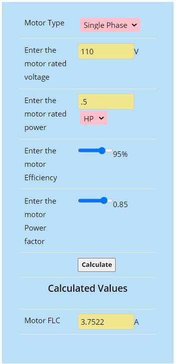

Posted: 02:39pm 19 Aug 2021
  Mixtel90 said  0.5hp = 370W = 7.9A FLC at 110V
Why does this FLC calculator say that a single-phase 110V .5hp motor should have an FLC of 3.7522A?

Posted: 02:59pm 19 Aug 2021
Ah...
Firstly, your device is reporting kWh then, not kW. :)
kW is the power drawn by the motor. You may find a motor rated in hp or kW.
kWh is the total power used by the motor over a period of time. 1kWh is 1kW for 1 hour or 2kW for 30 mins or 0.5kW for 2 hours.
The two are different things.
That calculator looks wrong. I think it's actually using a 240v setting no matter what you specify. :)

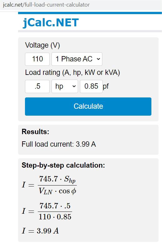

Here's another FLC calculator which gives (nearly) the same results as the other one, including the formula it used to make the calculation. Is there something wrong with that formula, or why does the result differ so significantly from the charts you link to?

Posts: 8911
Posted: 04:17pm 19 Aug 2021
I've no idea. :)
There are plenty of engineering sites that disagree with such a low current.
https://www.engineeringtoolbox.com/elctrical-motor-full-load-current-d_1499.html
Remember that the designed rating and FLC of a motor is what's written on the nameplate though. Everything else (including calculation) is a generalization. Motors vary a lot in efficiency. Efficiency varies with load, as does load current.
If your pump is very lightly loaded then it's quite possible that the current drawn is very low. The FLC is the *maximum* current that the motor should be allowed to draw.
