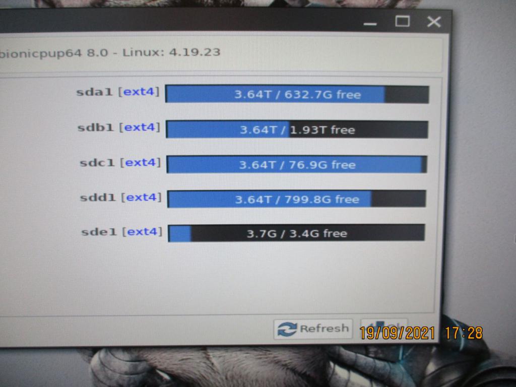

4TB WD Red drive, ext4.
76.9GB free.
Windows insists the drive has ZERO bytes available.
I tried deleting some old files on it, Windoze STILL says there are zero bytes available.

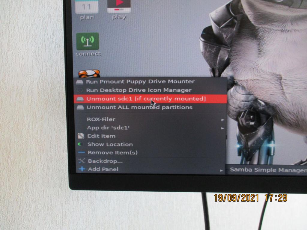

Linux reports 76.9GB free UNTIL I unmount, then remount, then even Linux says there is zero bytes available.

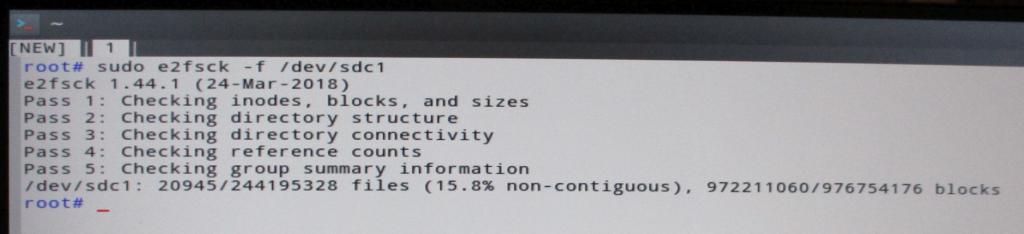

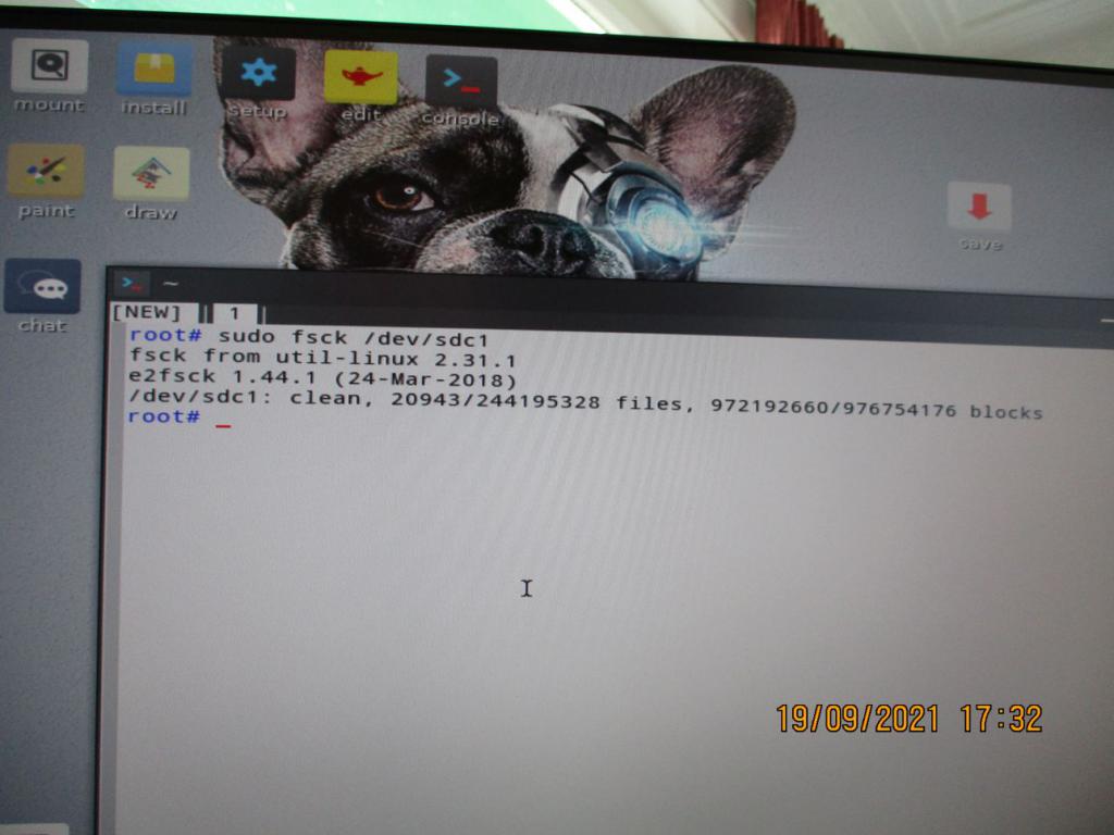

Getting suspicious at this point, at terminal: sudo fsck /dev/sdc1
Report comes back as "Clean".
I can access the files just fine in both Linux locally, or via the network in Windows, but if I try to copy anything to it, it moans(in windows) that the drive is full, which it is not.  In Linux, I can still copy files to the drive, EVEN THOUGH Linux is ALSO reporting zero space.  This is very odd.
Does anyone know a more advanced fsck command I can run to perhaps do a more in-depth file system check?  The one I run from the terminal completes in about three seconds - much faster then the old ext2/ext3 fsck checks which took ages.

  Grogster said  Getting suspicious at this point, at terminal: sudo fsck /dev/sdc1
Please try
sudo e2fsck -f /dev/sdc1
I think your existing command is seeing the drive is "clean" so doing nothing useful.
Posts: 9975
Posted: 05:43am 19 Sep 2021
@ SimpleSafeName: You can get a downloadable Linux filesystem driver thing for Windoze, which give Windoze full access to Linux drives if you were to plop one in a Windoze machine.  I forget the name, but I know you can get a 3rd-party application that will add Linux filesystem support to Windows so Windoze can read/write to them just like any other Windoze drive.
@ John: Thanks for the expanded fsck thing - I will run that now.  Yes, I've had this drive since brand new, never gave any issues before, and definitely purchased a genuine one from a reputable OEM seller.  I've never met hard-drives that were fake of any brand, but I do know of the fake USB drives that are programmed to report the wrong capacity.

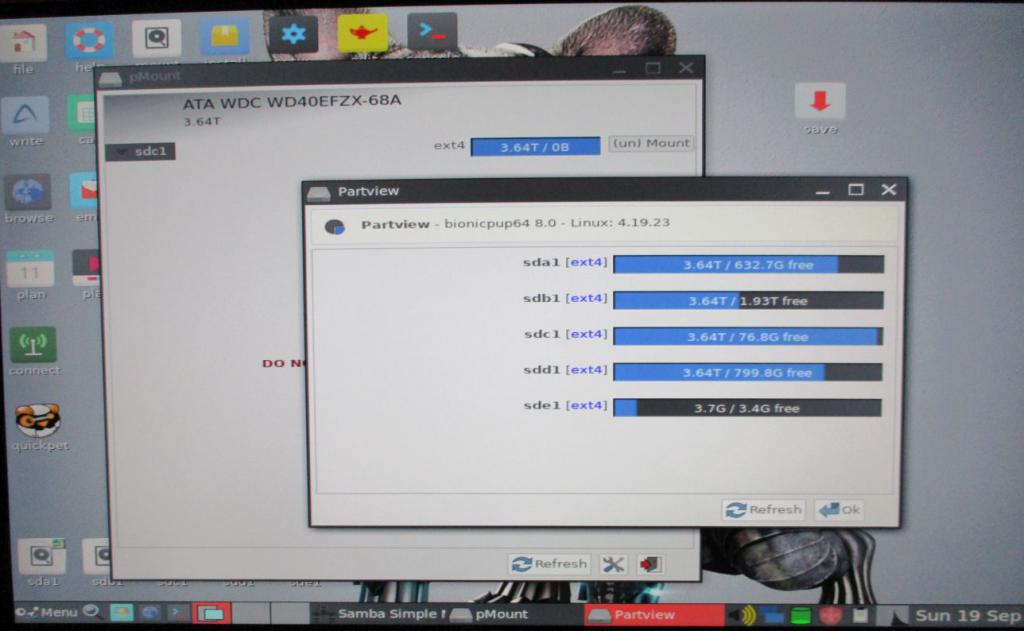

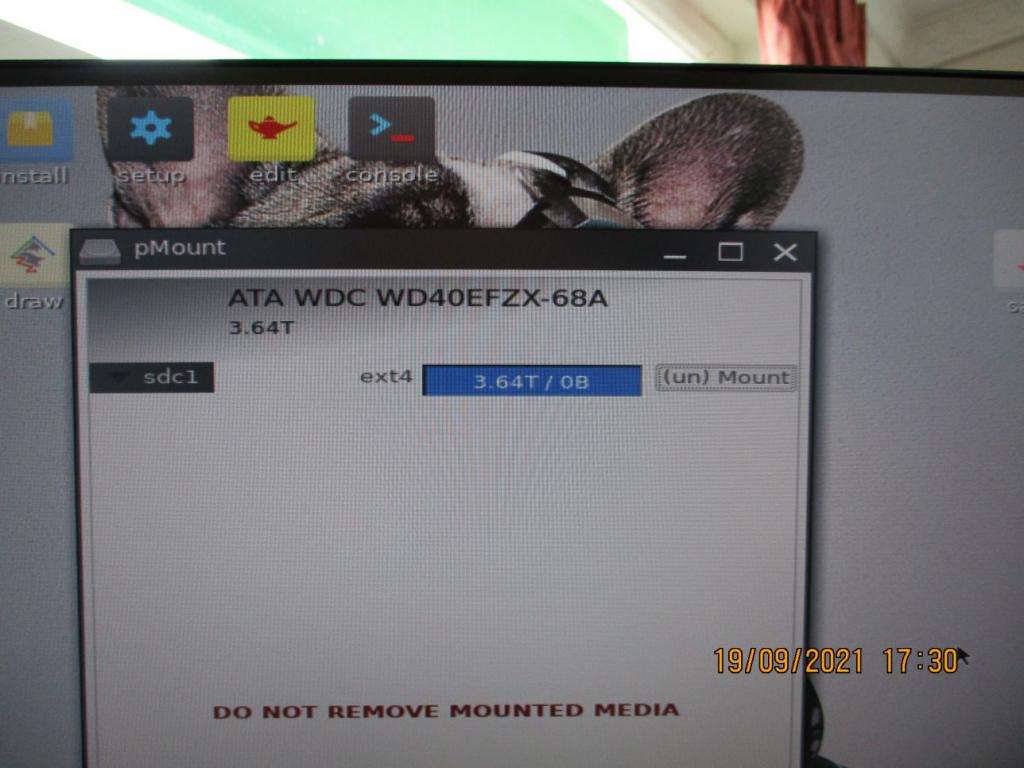

I've just discovered that in Linux, TWO different applications are reporting the change in capacity.  BOTH of them report the same, if you run them one after the other, but side-by-side, they show the difference.  pMount and Partview.
This now explains the difference in Linux, as two different applications seem to be calculating the free space differently.

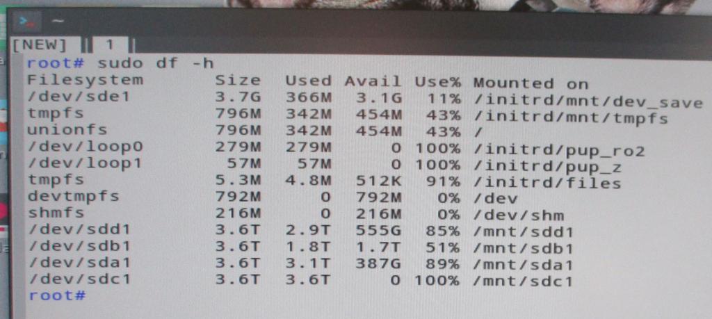

Is there a command I can run from the console, to get a report on what the Kernel thinks the free space is rather then via a GUI application?

Yup, it's called 'df':
   https://www.tecmint.com/how-to-check-disk-space-in-linux/

Results of sudo df -h:
This is ALSO reporting zero available.
I think I will do Mick's suggestion - copy everything off of this drive for the moment, reformat it, and copy everything back again.  Pit of a PITA, but I am suspicious of a drive reporting zero available, when I know there is more space there, and Linux even lets me copy files to the drive - despite some of Linux's own tools reporting zero space.

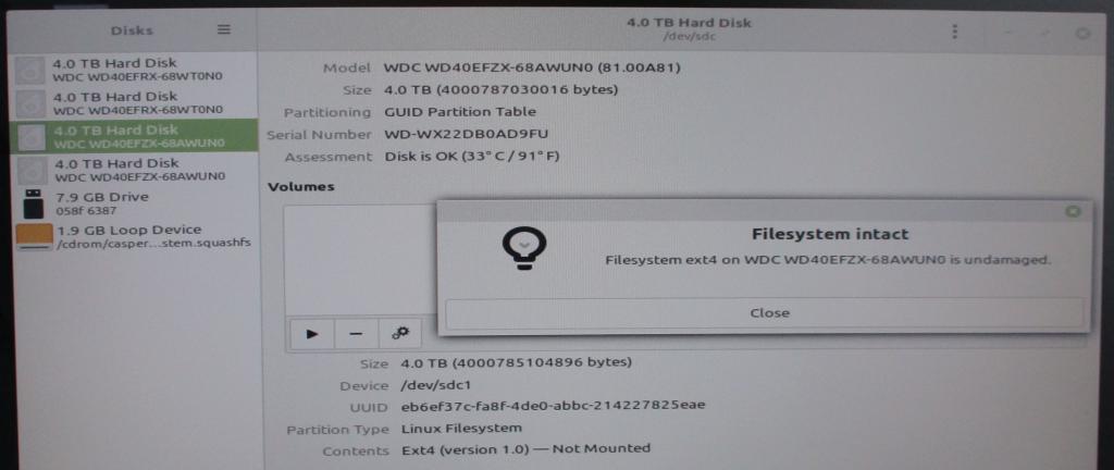

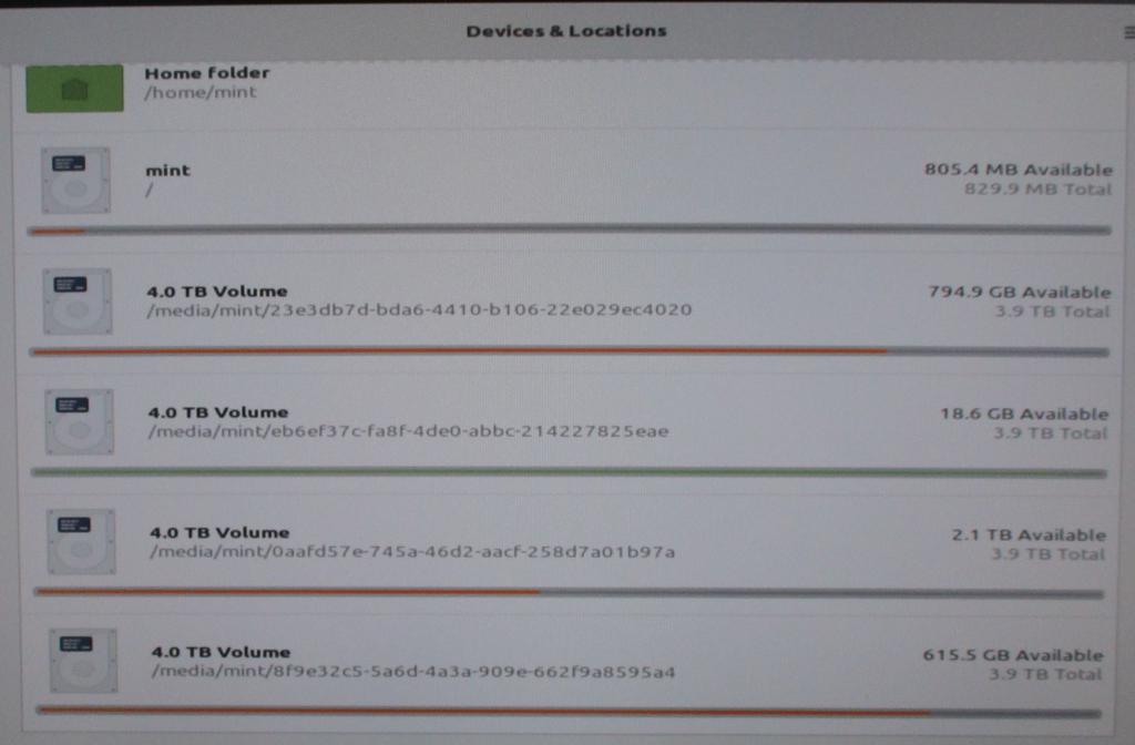

I suppose one thing I could try first, is to boot up a USB version of Mint, and see if it also is reporting the same kind of oddness, then proceed from there.
Posts: 9975
Posted: 12:57am 20 Sep 2021
Mint also reports zero - something odd going on here, so I will now proceed to remove everything from that drive, reformat it, and copy everything back.
