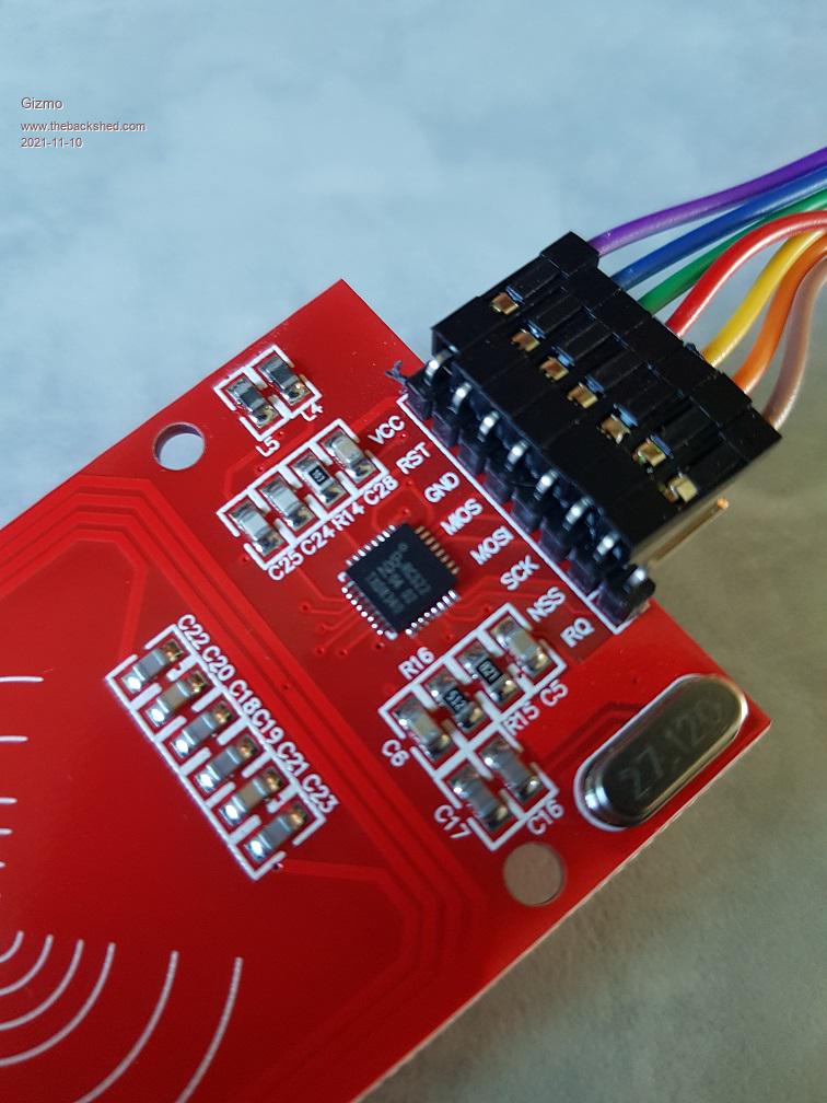

Posts: 5182
Posted: 05:16am 10 Nov 2021
Thanks Doug, might be a few clues in there.
My RFID-RC522 module seams to be a new batch, its labeled differently to every single example I've seen on the internet.
The modules and wiring examples I've seen online have the following pins -
VCC, RST, GND, IRQ, MISO, MOSI, SCL, SDA
Mine is labeled -
VCC, RST, GND, MOS, MOSI, SCK, NSS, IRQ
Which would explain why my tests have all failed.
Edited 2021-11-10 15:20 by Gizmo
Posts: 6538
Posted: 05:59am 10 Nov 2021
Apart from the pin labeled MOS (Which should be MISO), your board matches the project sheet from Jaycar
