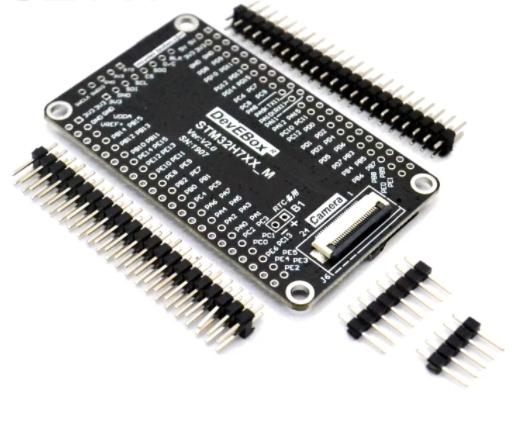

Hello, now that we have a version for the Pico/RP2040/CortexM0 and Black Pill/ST32MF411/CortexM4 would it be very difficult to make a version for the Teensy4/4.1/CortexM7 ? With 600Mhz clockspeed and lots of overclocking potential its still the fastest DIP module in existence, afaik... And... I have one lying around waiting for BASIC... |
| matherp Guru Joined: 11/12/2012 Location: United KingdomPosts: 11513 |
Difficult - no. Long and laborious - very. Different IDE, manuals etc. Overall the NXP chip looks superb but I don't like the Teensy package. Too few pins and if you are going to have such a powerful processor then you want to do powerful stuff with it., No scope for driving LCDs, cameras etc. as the needed pins aren't broken out. The ArmmiteH7 on the Nucleo-H743ZI2 already runs at 480MHz and has much more scope at a fairly similar cost. Certainly not something I will be looking at for a port but someone may want to..... |
| fred777 Regular Member Joined: 01/07/2021 Location: United KingdomPosts: 87 |
Would that run on boards with slightly different STM32H7 boards like the the cheap STM32H743VIT6 based ones from china or the Daisy Seed? |
| JohnS Guru Joined: 18/11/2011 Location: United KingdomPosts: 4335 |
Why not just use the already-supported waveshare board chosen for the CMM2 (if not the NUCLEO already mentioned)? John Edited 2021-11-29 21:37 by JohnS |
Why not just use the already-supported waveshare board chosen for the CMM2 (if not the NUCLEO already mentioned)? They are all far too big for my purposes and not DIP. Well, I guess the Pico or Black Pill will have to do ;-) |
Or you tweak the code for the board(s) you wanted, but it's quite a bit of work! John |
| knivd Regular Member Joined: 07/09/2014 Location: United KingdomPosts: 73 |
Or something like this? https://www.aliexpress.com/item/1005002293087401.html There is plenty at Aliexpress Edited 2021-11-29 23:32 by knivd |
Yes, there are a bunch of them, but all seem to have the STM32H743VIT6 cpu and the CMM2 has a STM32H743IIT6. I'm not shure what the differences are yet... |
The number of pins in the package - V is 100, Z is 144, I is 176 Point I am making - CMM2 is not very usable, except nostalgia evenings, while an embeddable module has far more possible applications . Edited 2021-11-30 02:51 by knivd |

I don't understand why the denial and hostility to everything I post... It is just a link to a module which looked interesting in my opinion. I know about the waveshare one but it has too many pins to be convenient for use in simpler applications |
The Aliexpress module looks good and it would be a relatively simple but tedious mod to the ArmmiteH7 code to support it. If anyone wants to do it I can provide the relavnt source and an explanation of how to go about it. |
Thanks, Peter. I am willing to give it a shot, although I am not massively comfortable with STM32, but shouldn't be a problem. You know my email |
