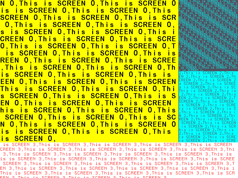

Hello,
I have just written small SplitScreen library for CMM2. It can be used for splitting the screen into different areas, where can be then either printed text into or shown image, drawn anything. I have made it mainly for me, but maybe somebody can use it also...
It's very simple, but can:
* count of areas is limited just by free memory (for every area is just needed control string with 22 bytes)
* in control string is remembered cursor position, so you can switch the areas freely
* support for scrolling, different fonts, colors
* TAB/CHR$(8) and LF/CHR$(10) is supported in outputted text
* just 5 SUBs/FUNCTIONs, so it leaves many slots for main program free
* example program is included
What can't:
* not taken care of overlapping areas
* text in areas not stored, just cursor position
Enjoy!
Jiri

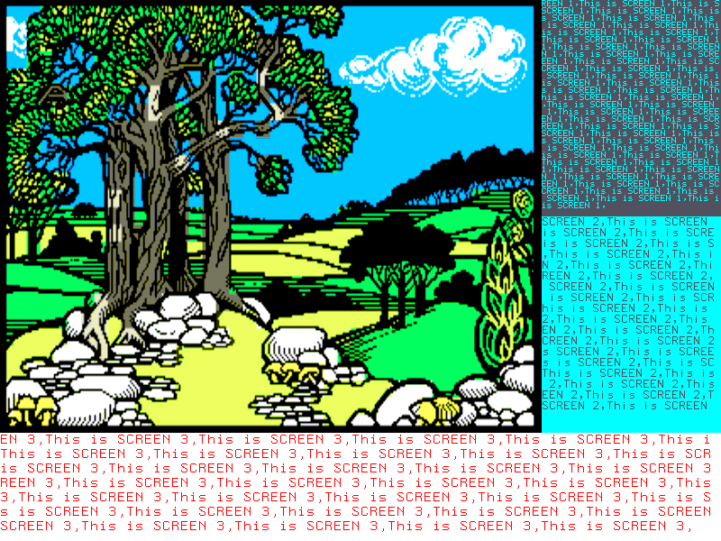

Wauw Jiri,
That is marvelous. Especially your second screenshot. Looking at this fond memories of the early adventure games (test supported with graphics). This is from a Speccie I guess.

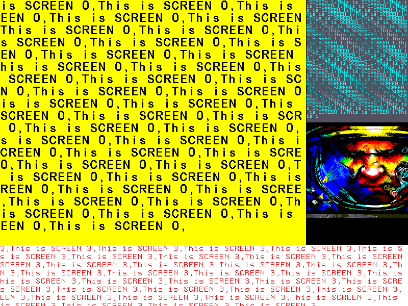

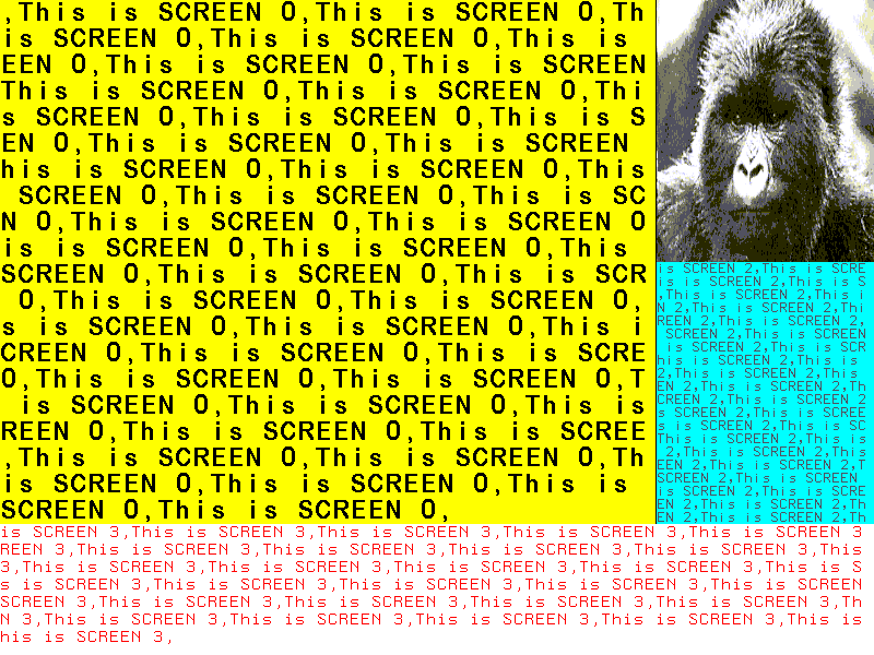

I'm preparing some improvements, this library is really planned for some text adventures, but can be also used for many more things (play with turtle commands for example )
The biggest picture is converted from C64, name is midear, but I don't know where is coming from - I used it to test my graphics conversion routines...
Gorilla is from Atari ST and astronaut from ZX Spectrum.
