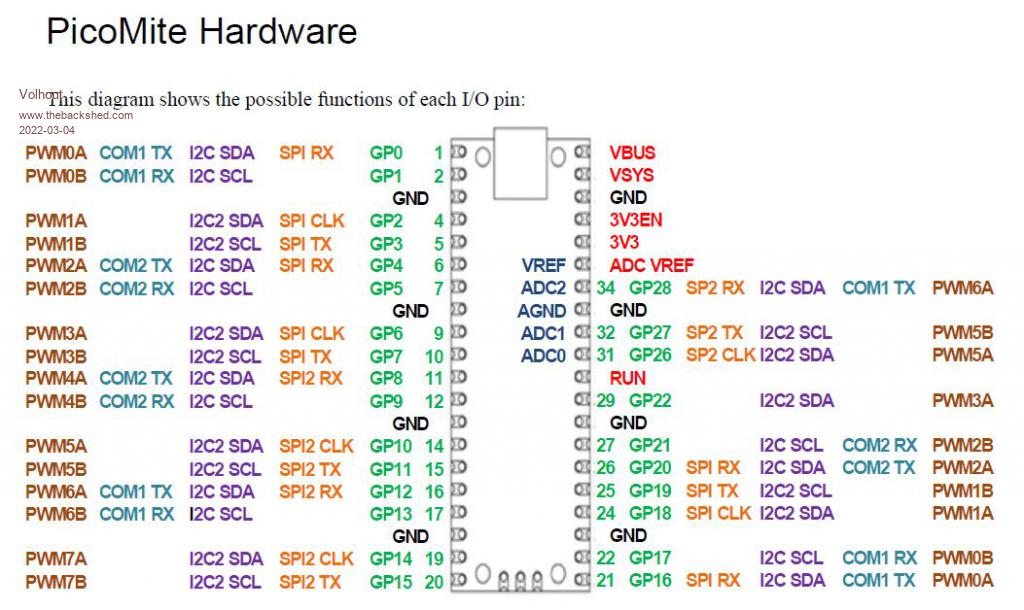

Posted: 01:13pm 03 Mar 2022
Asking this here instead of opening a new topic
Can anyone glance this over and tell me if I have it correct please?
ILI9341 display with touch and Picomite
5v    VBUS
GND   GND
CS    GP17
RES   GP20
D/C   GP21
SDI   GP19
SCK   GP18
LED   GP22
SDO   GP16
T_Clk GP18
T_CS  GP15
T_DIN GP19
T_OUT GP21
T_IRQ GP14
OPTION SYSTEM SPI GP18, GP19, GP16
OPTION LCDPANEL ILI9341, L, GP21, GP20, GP17, GP22
OPTION TOUCH GP15, GP14
Posts: 5931
Posted: 02:03pm 03 Mar 2022
According to the manual, when you declare SYSTEM SPI, this SPI bus is used for Touch, ILI9341 and SD card combined.
These devices share clock, MISO and MOSI pins, but have individual CS and INT pins (and D/C for te ILI9341).
In that case:

Touch ---------------
T_Clk = GP18 (correct)
T_CS = GP15 (correct)
T_DIN = GP19 (correct)
T_OUT = GP16
T_IRQ = GP14 (correct)

lew247
Joined: 23/12/2015
Posts: 1709
Posted: 03:23pm 03 Mar 2022
So I not need T_out connected on the ILI9341?
GP22 is PWM0B why can't I use this?
The manual says

Posts: 5931
Posted: 03:42pm 03 Mar 2022
Hi Bill,
Backlight as an additional paramter in the OPTION LCDPANEL... Never too old to learn..... Thanks. I didn't know that. Must have missed it in Geoff's user manual.
According to the PicoMite user manual, GP22 is PWM3A. I think you looked at PIN22. PIN22 is not GP22.
I think T_out must be connected to GP16 (SPI_RX or also called MISO pin) to be able to read the coordinates from the Touch controller chip over the system SPI bus.
Edited 2022-03-04 01:45 by Volhout
Posts: 8911
Posted: 04:01pm 03 Mar 2022
OPTION SYSTEM SPI GP18, GP19, GP16 'clk, mosi, miso
OPTION LCDPANEL ILI9341, L, GP21, GP20, GP17, GP22 'or, dc, rst, cs, bl
OPTION TOUCH GP15, GP14 'cs, irq
I think the above should work fine, lew. GP22 is PWM3A so I don't think PWM3B can be used for PWM. You do need T_OUT if you are going to use touch.
The backlight control was added later and isn't really in the best place in the manual IMHO. It would have needed rather a lot of messing about to put it elsewhere though, I think, as it only applies to a limited number of displays.

Posts: 3291
Posted: 11:16pm 03 Mar 2022
"So I not need T_out connected on the ILI9341?"
T_out must go to GP16 along with SDO as noted by Volhout.

Posts: 8911
Posted: 10:07am 04 Mar 2022
The SPI is a bus, lew. The way it's used on the 'mites is that all devices on the bus have connections to clock, data into the master and data out from the master (note that the names change depending on the device). That would normally mean that all the devices conflict, but each device also has its own select line (CS) so that only one device is selected at once. The ILI9341 has 2 devices (3 if you use the SDcard), each with it's own CS line. So:
These are the common bus lines
PicoMite        Display   Touch   SDcard
SDI_TX (GP19)   MOSI      T_DIN   SD_MOSI
SDI_RX (GP20)   MISO      T_DOUT  SD_MISO
SDI_CLK (GP18)  SCK       T_CLK   SD_SCK
Then each device has its own select line
GP17            CS         -       -
GP15             -        T_CS
optional         -         -      SD_CS
There are also additional signals for the display and touch devices
Sorry if I seem t be preaching to the converted, but you seem to be following the manual without an understanding of what is actually happening - which can be useful to know.
