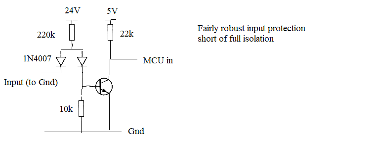

I don't think there are many controllers that have galvanic isolation on all inputs as standard (and very rarely on analogue inputs at all). At best you seem to get blocks of digital inputs isolated (typically 4 - although AC inputs are quite often isolated). If you take it to its logical conclusion then everything should be galvanically isolated, which is just stupid. You only fit isolators where they are needed 'cos the darn things cost!
A lot of external equipment is powered by its own mains transformer/SMPS and is therefore galvanically isolated by default.
The "proper" PCs are (and always have been) modular so you can fit isolated or non-isolated input and output modules to the bus. They also cost a fortune.

The issue with galvanic isolation is simple.
I design hardware for companies like Siemens and ABB, and they are strict about it. It is prescribed in standards. They manufacture equipment that is pretty fault resilient, and installers dont have to wory about details like that. No hidden ground loops, no high currents running throug common pins in I/O cards. In case of a single failure in the installation, in most cases no further damage is done. They sell their modules at premiym price, so the hardware cost can be absorbed.
If you know your system, and accept that some single failures damage larger parrs of your system (i.e mains touching 5V inputs) you can tune the isolation to what you need. Sometimes you can even work without double insulation. But you need to make a propper ground and power plan to see where you need it, an where not.
One of the tests that you can perform to see is a usb connention for keyboard or pc. That needs to widthstand 8kv contact discharge (ESD). Even with grounding close to the usb connector, this may be insufficient. Since USB is difficult to isolate and expensive. Somtimes the complete CPU subsystem is isolated including the USB.

But consider a high voltage electricity substation and/or a lightening prone situation. Earth faults and lightening strikes can cause the local earth potential to rise by many thousands of volts.
A lightening strike to that tree next to your backyard shed could briefly cause the ground potential of the shed to be thousands of volts higher than that of your house.
In those cases, good galvanic isolation is essential. SCADA equipment for electricity substations should (and usually does) have galvanic isolation on all I/O.

The systems I worked on didn't bother with opto-isolation or galvanic isolation on runs where lightning might be a problem. They don't give any protection at all at 36kV, never mind lightning so there's no point in bothering. :) (I used to love playing with the 36kV pressure tester at work!) It was multiple sets of fuses and transzorbs to a solid protective earth bar before you got out of the building. Same at the other end. Nothing protects against a direct strike on the cable. Not even the walls of the building sometimes.
The main reason for isolation is to prevent accidental operation of something due to common supply wiring being not what it says. If you can guarantee a common return rail (which should only be grounded at one point if at all) then there's no real need for isolation. Station alarm batteries sometimes float both ends of the battery and use an earth fault detection relay to sense if either side gets earthed. You'll need isolation if you are working with both one of those and an earthed supply.
Another reason is for intrinsically safe appications, where the maximum available power into the protected area is restricted to less than the point where it could cause an explosion or fire. That might mean using galvanic isolation, particularly for supplies which are typically limited to 2W maximum.
Cows sometimes die in fields near electricity pylons. If the pylon gets a direct strike the immense ground current causes a huge voltage drop through the ground. The distance between a cow's legs is sufficient for a portion of that voltage to stop its heart.
