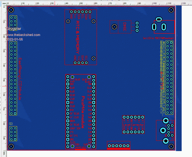

This follows on from the other thread, but I thought it would be better not to hijack that thread, and start a new one for this PCB.
This is what I have so far - just doing the major component placement at this stage:
PM down the bottom of the board to give easy access to its USB socket.
ER connector at left side, standard 4-7" TFT connector at right(both on bottom)
3940 1A LDO 3v3 regulator to power both types of screen.(won't use the PM 3v3 output)
Four-channel 5v/3v3 bi-directional level corrector(two channels for keyboard, the other two for COM1)
Standard RTC module.
Six-way PCB header for the six pins left over after all the tracks are laid.
I plan to squeeze this layout a bit more horizontally, to make it 100x100.
Once complete, I will certainly release all gerbers and drill data files etc.

Just a thought...
I don't know if both versions of the display have the same fixings, but would it make sense to make this a split board, each piece lining up on the display fixing holes but making up 100mm square before cutting? The two could be linked just by wires as there's not a lot of connections if you can put both display connectors on the same end as the PicoMite. It may not be possible if the display pins are too dissimilar in layout, but it's just an idea.
panky
Joined: 02/10/2012
Posts: 1127
Posted: 08:25am 06 Jan 2022
FWIW, I feel a SSD1963 5" or 7" form factor for the backpack pcb would make sense (eg. Explore 100 or MZ 144). There already exists an SSD1963 to East Rising 8/9 inch LCD adaptor so for the limited number of such users, spending PCB real estate for this LCD seems wastefully unless it can be used for something else.
Given the existing support for SPI displays, would you consider connectors for an ILI9341, with an i/o connector to re-use the 8 parallel data lines released by not using the SSD1963?
Also, perhaps an on-PCB SD card?
Also as this will significantly expand the usage options, I feel an analogue expander may be worth considering?
Just some idle thoughts!
Doug.
Posts: 5931
Posted: 09:47am 06 Jan 2022
@grogster
2 suggestions:
1/ add an 8 pin header for the 6 free IO pins on the pico + GND + 3V3
2/ provide a footprint for a (micro) SD card.
It is nice that the parallel display can be supported, but only 6 pins free limits the application to a terminal. Maybe that was the idea from the start ?
But if you take away 4 of the 6 IO pins by adding the RTC and audio, you are basically removing all functionality outside the terminal function. Just 2 pins remain for COM. No IO possible anymore.
This is a nice -proof of concept- but is there demand for a serial terminal with embedded MMBasic ?

Posts: 8911
Posted: 12:20pm 06 Jan 2022
How about a RTC module and a 28-pin Micromite on the GP21/GP22 I2C bus?
That way there are 17 programmable IO pins to play with and a RTC all for the sake of 2 pins - and the code for the Micromite is already in a workable form in the Micromite "Get Started" manual.
Or, GP17/GP20/GP21 as a RS485 interface to as many hundred devices you feel like hanging off it.
Or put a ESP8266-01S on it and wi-fi link to a load of remote stations.
Six IO pins is quite a lot when you come to think of it. :)

Posts: 9975
Posted: 11:18pm 06 Jan 2022
  panky said  FWIW, I feel a SSD1963 5" or 7" form factor for the backpack pcb would make sense (eg. Explore 100 or MZ 144). There already exists an SSD1963 to East Rising 8/9 inch LCD adaptor so for the limited number of such users, spending PCB real estate for this LCD seems wastefully unless it can be used for something else.
You have a point.
The ER socket is there, as that was one of the things peter suggested the PCB have, so that is where that came from.  See the other thread.
Question: Other then me and WhiteWizard and perhaps matherp, does anyone else use the large 8" or 9" ER LCD very much?  It may well be a better idea to design for the standard 40-pin connector, and leave off the ER connector and just use the adaptor PCB as you say.  That is a very valid point.  It depends on how many people use the ER displays.  I have ONE, but I only have it for testing.  I don't use the ER displays by default, as the standard 40-pin connector is more common.
Mixtel90's idea of hanging a 170 Micromite off the I2C bus is a clever one to get more I/O pins, but I distinctly remember there being a dedicated I2C I/O expander chip already.  Would that be a better choice?  I forget the part number, but I will have a bit of a search.  It was also a DIL of around 28 pins, but then you would not need to program a 170 to do the same thing that an I/O expander chip could do natively, and you simply command it via the PicoMite MMBASIC.
...or simply have that as an add-on board, which would suit EVERYTHING - CMM1, CMM2, CMM2_G2, Micromite, Arduino, PicoMite, Pi Zero - ANYTHING with a spare I2C port....
I think I like that idea more then including on on THIS board, cos a separate add-on I/O expander board would be completely universal and could be used on just about anything.  What about that idea as a 2nd PCB?
EDIT: Come to think of it, eBay and AE etc probably already have traders selling such I2C expander boards.  I'll do a quick search for "I/O expander for Arduino" - that kind of wording usually produces results.  No point in re-inventing the wheel...
