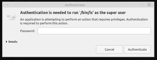

  robert.rozee said  your friend here is pkexec, that is available on many Linux variants, but certainly far from all.
I suspect su is always there & would work for what you want.
(su -c particularly.)
Posts: 2428
Posted: 02:19pm 08 Jan 2022
the advantage of pkexec is that it will generate a GUI popup window itself, asking you to enter your password:
this (pkexec ls /) works if called from a shell script, or from a GUI executable.
when using su (or sudo where the root account is disabled as it is in Linux Mint) within a script or from an application, you need to figure out how to pipe the password into it yourself, which can be quite a challenge - and almost impossible to do in a secure manner that can not be intercepted by a bad actor. for instance:
echo "mysecretpassword" | sudo -S ls /
which works, but is an immensely bad idea from a security perspective.
