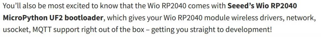

Posted: 05:46pm 17 Jan 2022
Thanks Peter
I did wonder because this is what their documentation says

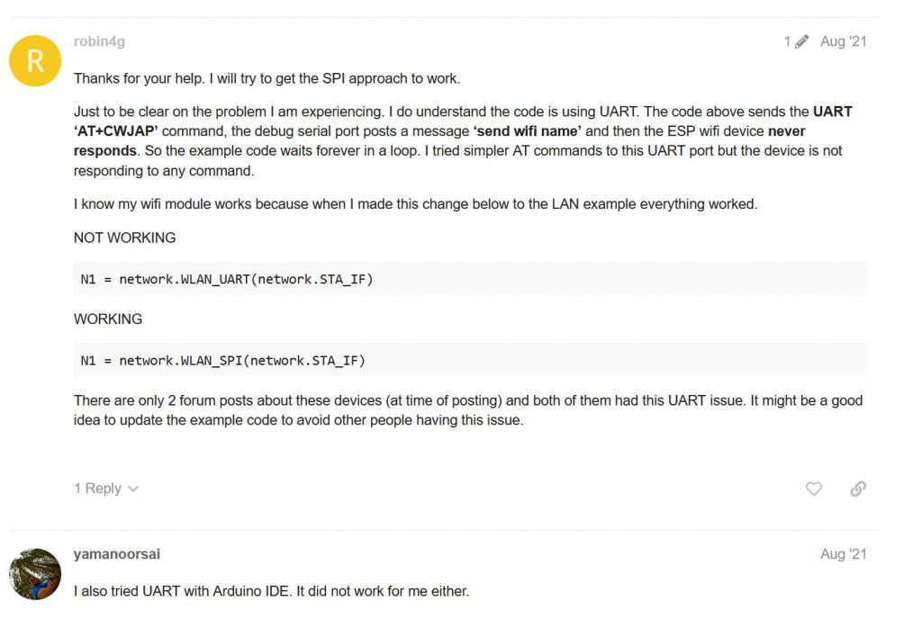

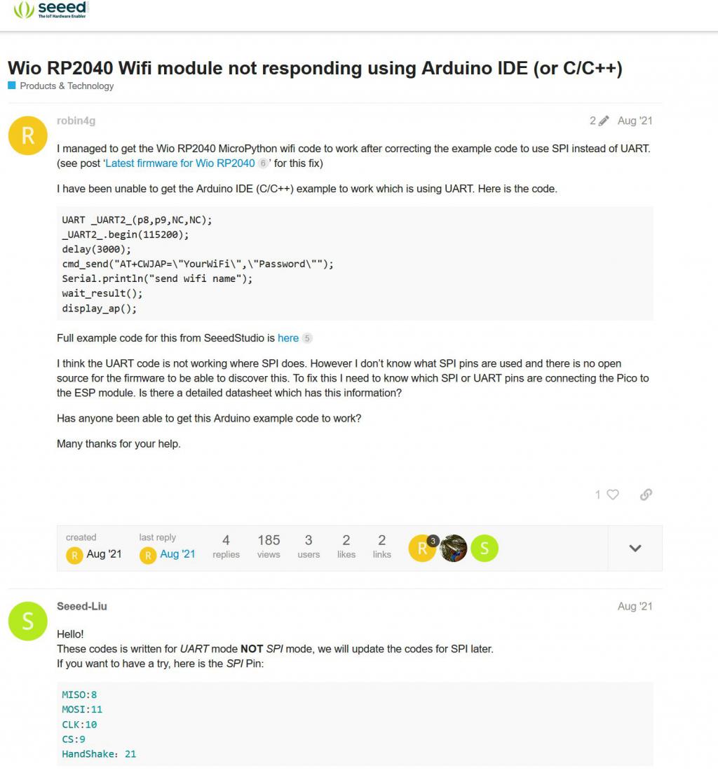

Posted: 06:16pm 17 Jan 2022
Does this make sense to anyone?
Latest firmware for Wio RP2040
but it would need someone who actually understands to confirm or not
*it uses the AT command set*
This is their WIKI on  MQTT
I still have ONE of these boards with built in WIFI available if anyone IN THE UK wants to play with it and get it working on Picomite?
Edited 2022-01-18 04:17 by lew247

Posted: 12:14pm 18 Jan 2022
I've asked SeedStudio direct how to communicate with the ESP8285 ie which uart GPIO it uses
In the Meantime I know it can communicate via SPI I've got that working
Can anyone tell me if this is correct?
SETPIN GPIO11, GPIO8, GPIO12, SPI2  'Miso GPIO8, MOSI GPIO11, CLK GPIO10
Then if that is correct can anyone tell me how to send and receive the AT commands?
for instance
if I wanted to send AT+CWL which should return a list of all available AP's
Can this be sent by SPI the same as you would using Uart? and can it be read?
or can this only be done with uart
Sorry for the stupid questions but I'm "trying" to learn

I would try each of:
1(i) use Arduino to make stuff work (looks like via SPI)
(ii) tweak code to MMBasic syntax
2(i) get 8285 into UART mode
(ii) use Peter's code for 8266
Both should work, with time & effort.
It strikes me that if there are poor or no Arduino examples the maker will hardly sell devices!
Plus, it will be very hard to use MMBasic.
