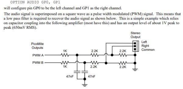

I have just noticed a possible mistake in Picomite manual 5.07.03
SOUND OUTPUT P29
Manual says:
The PicoMite can play stereo WAV files located on the SD card or generate precise sine waves using the PLAY command.
Before these commands can be used the output pins to be used must be allocated as audio outputs. This is done  using the OPTION AUDIO command. For example:
OPTION AUDIO GP0, GP1
will configure pin GP0 to be the left channel and GP1 as the right channel
The Picomite hardware diagram on P9 shows GP0 (Pin1) as PWM0A and GP1(Pin2) as PWM0B.
According to OPTION AUDIO description above, GP0 should be the LEFT channel.
But the Sound output diagram shows PWM A as connected to the RIGHT channel:
1. Which one is correct? The description or the diagram? Is PWM A the left or right channel?
2. Also, the description for OPTION AUDIO on P75 does not indicate Left/Right channels.
Edited 2022-01-23 04:36 by flasherror

Posted: 12:53am 24 Jan 2022
  flasherror said  I have just noticed a possible mistake in Picomite manual 5.07.03 SOUND OUTPUT P29
The description is correct.  I have updated the manual (with a revision number) to fix it and add your suggestions.
Geoff

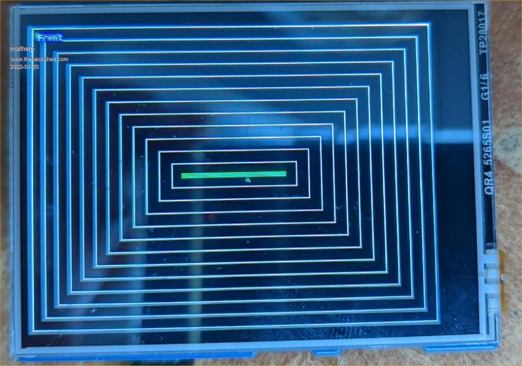

FONT 8 ISSUE
I'm trying to use FONT 8 in PicoMiteV5.07.03.uf2 but all I get is the screen erased from where the text should start to the right and down to the bottom of the screen.
It fills this part of the screen with the background colour with no text.
My command is:
Text 5, 5, "Front", L, 8, 1, RGB(yellow), RGB(BLue)
With version 5.07.01 I had a definefont #8 written in C and when I have this included the font works fine.
I'm using a Raspberry Pi Pico plugged into a 2.8" waveshare 320 x 240 screen.
Can someone help me and let me know what I'm doing wrong please?
Thanks George
Posts: 10240
Posted: 10:06am 30 Jan 2022
Works perfectly on Waveshare 2.8 check your option  set up and make sure you are using latest release downloaded from Geoof's site
  Quote   option list
OPTION LCDPANEL ST7789_320, LANDSCAPE,GP8,GP15,GP9,GP13
OPTION TOUCH GP16,GP17
GUI CALIBRATE 0, 408, 3901, 900, -646
OPTION SDCARD GP22
geobh
Joined: 29/01/2022
Posts: 7
Posted: 10:42am 30 Jan 2022
I have
OPTION SYSTEM spi GP10, GP11, GP12
OPTION TOUCH GP16, GP17
OPTION LCDPANEL ST7789_320, RL, GP8, GP15, GP9, GP13
OPTION SDCARD GP22
when I do GUI CALIBRATE I get
Deviation X = 2, Y = 0 (pix
When I run my program I still get the screen wiped out from the start point for text across to the right and down to the bottom.
My test program is
dim integer num, widt=320, leng=240
cls
backlight 80
for num = 0 to 120 step 10
box num,num,widt - num*2,leng - num*2,1,rgb(white)
next num
line 118, 118, 200, 118, 4, rgb(green)
end
Is my screen rotation the issue?
Posts: 10240
Posted: 11:11am 30 Jan 2022
  Quote  Is my screen rotation the issue?
No
  Quote  When I run my program I still get the screen wiped out from the start point for text across to the right and down to the bottom.
I don't, tested with your settings and a fresh download of firmware from Geoff's site
Edited 2022-01-30 22:03 by matherp
