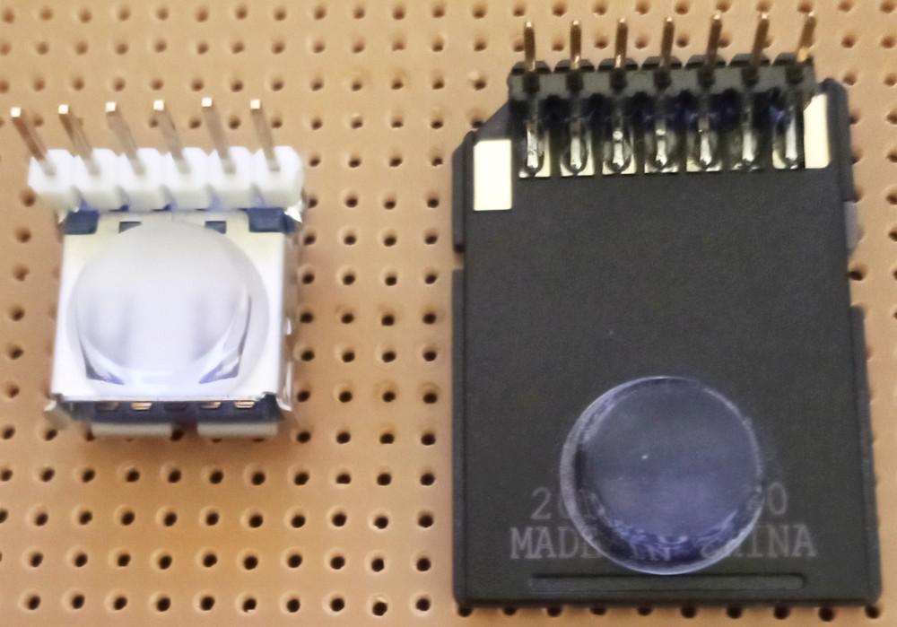

Posted: 08:11pm 03 Feb 2022
I made a thing to plug-in a PS/2 over USB keyboard.
A row of USB3 only pins has been cut out of the way.
Edge pins soldered to the shield for mechanical support.
Adhesive foot belt sanded to sit level with the pins.
If only my VGA hack was going so well...
Edited 2022-02-04 09:03 by KD5ZXG
