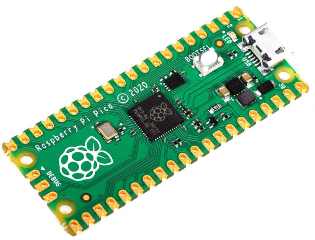

Can anyone tell me what I've done wrong?
I'm trying to get the Picomite to display everything coming from the GPS unit
but I get nothing when I run the program
SETPIN rx, tx, COM1 and according to every pinout diagram I have then GPIO1 is RX and GPIO0 is TX
I've even tried setpin GP0,GP1, Com1 but it still gives no output on the console
setpin GP1,GP0, Com1
Open "COM1:115200" AS GPS,0,1
DO
 If GPS(VALID) = 1 Then
   print GPS(date)
   print GPS(time)
 END IF
 pause 1000
I've tested the GPS module on the PC using a uart adaptor and it works perfectly and the baud rate is 115200
it receives all 4 different gps constellations and I can see the output from the GPS unit on the serial console on the PC and using the Ublox software as well.

Are you connecting Rx to tx and visa versa? You should be.

  matherp said  Are you connecting Rx to tx and visa versa? You should be.
Yes, exactly the same as I had it on the PC uart adaptor tx to rx and rx to tx
TX on the GPS to GPI and RX on the GPS to GP0

lew247
Joined: 23/12/2015
Posts: 1709
Posted: 03:02pm 02 Feb 2022
Apologies everyone
I had indeed somehow got the tx and rx on the Pico reversed, even though I was positive I had it correct
Rx the GPS goes to Pin 1 on the Pico and TX on the GPS to Pin 2 on the Pico
This code works

Posts: 4369
Posted: 03:11pm 02 Feb 2022
Great ... and I made the same mistake.
Lewis assuming that the PicoMite manual is correct you've transposed RX and TX on all the schematics for the PicoMite GPS Speedometer ... no wonder we've been having difficulty .

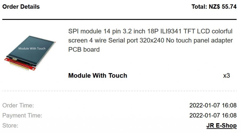

I'm still having problems
This is how I have it setup
LCD DIN GP19
LCD CLK GP18
LCD DC GP8
LCD CS GP9
LCD RST GP12
LCD BL GP15
OPTION SYSTEM SPI GP18, GP19, GP16
OPTION LCDPANEL ILI9341, L, GP8, GP12, GP9
SETPIN GP15, DOUT
Pin(GP15) = 1
GUI TEST LCDPANEL
I get nothing but a white screen

Posted: 12:08pm 03 Feb 2022
See the other thread where symptom was a white screen. Turns out the display was really an ILI9488, but sold as an ILI9341

I thought I was buying an ILI9341 but received an ILI9488 with no markings on it to say what controller it used.
Below is how mine is configured. I take the LED pin straight to the "VSYS" pin which is the equivalent of a 100% duty cycle PWM, ie. maximum brightness.I have tried a CPU speed of 133MHz and 250MHz

lew247
Joined: 23/12/2015
Posts: 1709
Posted: 09:09pm 03 Feb 2022
It was indeed an ILI9488 sold as an ILI9341
working now thanks everyone
