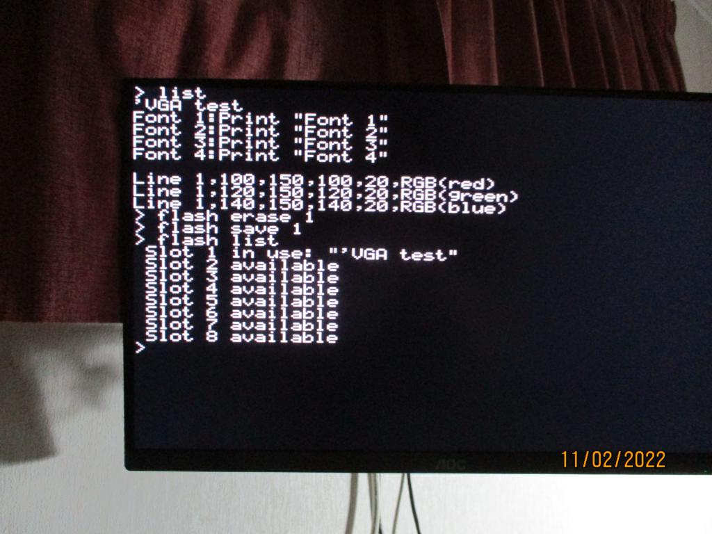

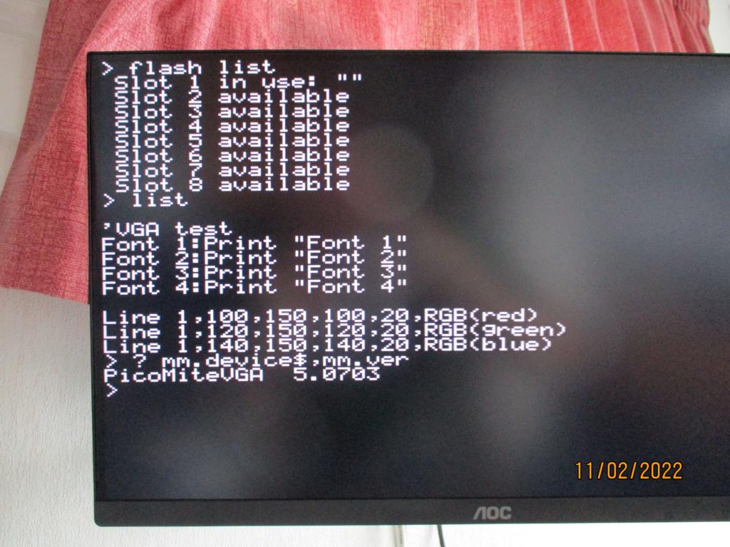

I thought that the fist line of the code for any saved flash slot, was to show up to the right of the slot number, to help you know what was saved in each slot?
Not working for me.  Anyone got any pointers for perhaps something I am doing wrong?

Did you do a FLASH SAVE 1 ?

The text " 'VGA test" is the second line of your program.
There is an empty line above it.

@ TassyJim - yes.
@ Volhout - good point.  Will check on that....

Volhout was 100% correct:
The problem was that in the COLOUR version of the PicoMiteVGA, the editor does not show you line 0.  It seems to start from line 1, and so in the editor, everything looks fine, and there IS no empty line above - but there actually is.
