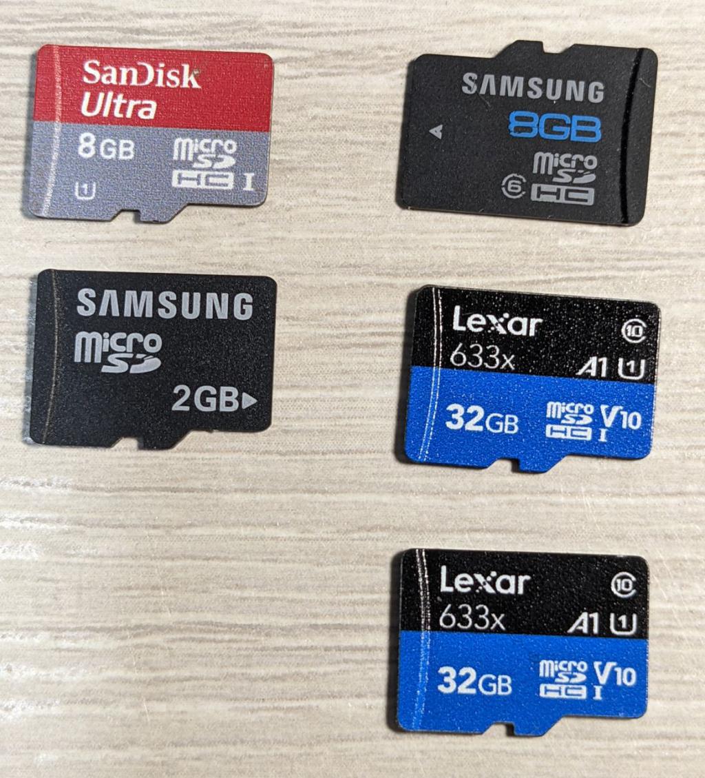

Does anyone else have this problem? I have 2 SD micro cards that always work and 3 (or more) that never work.
I am using Wishiot SD Card Module from Amazon.  I have repeated the problem on 3 of these card readers.

***** Using any card that doesn't work I get
> files
Error : SD Card not found
All cards are freshly FAT32 formatted with short text files loaded on them from my PC
The 2 cards in the left column work, the three cards in the right column do not.
Does anyone know why or can they suggest any tests I haven't tried?

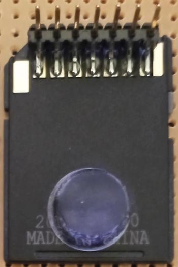

Tried this yet? Solder pins to an adapter, not a live card.
There is a slot for microSD here, though can't see it...
Edited 2022-02-15 06:32 by KD5ZXG

Wow, thanks forum.  Many things to try.  First is using the SD to SD-micro adapter as in the photo by KD5ZXG.  Looking thru the literature I think the wiring I want is
(pins labeled 9,1,2,3,4,5,6,7,8 from the notched corner to the write protect slider)
pin 9- unused
pin 1- unused
pin 2- CS  [GP15, pin20]
pin 3- MOSI  [GP11, pin15]
pin 4- VDD (3.3V?)  [pin36]
pin 5- SCK  [GP10, pin14]
pin 6- Ground  [pin38]
pin 7- MISO  [gp12, pin16]
pin 8- unused
NO in line resistors, NO filter capacitors.
I wired this up twice and neither time did I get anything but
"Error : SD Card not found".
Am I making a stupid mistake?
Posts: 3290
Posted: 12:08am 15 Feb 2022
On the photo in KD5ZXG's post the 7 header pins are, left to right:-
_1__2_____3___4____5___6______7
CS, MOSI, Gnd, 3.3V, SCK, unused, MISO
Edited 2022-02-15 10:15 by phil99
k2backhoe
Joined: 04/12/2021
Posts: 47
Posted: 01:30am 15 Feb 2022
Aaaaaaaaaaaaaand now everything works!!  Using phil99's wiring and KD5ZXG/Mitel90's modified adapter card.  Thank you all for the help. 6 of 7 SD cards work, the only one that fails is a 128GB card which should fail as this system supports only up to 32 GB (only FAT formats).
