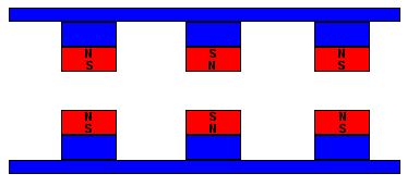

So I've been playing with FEMM a little more.
Decided to make an animation of the changing magnetic fieldlines as a function of airgap for the axial flux generators. A small, low-resolution sample is shown below. Even this one clearly shows the changing flux lines and increasing leakage flux and diminishing flux density as the airgap increases.
Links to the complete animations can be found below. I like the 2nd one better because of the absence of a sudden transition in the loop, but the price for that is a much larger file. Click on the magnifying glass (near top-right of the image) to start loading the file and viewing the animation.
http://picasaweb.google.com/motorconversion/AxialFluxFEMMSim ulations#5288197761856843090 (warning, 7MB filesize)
http://picasaweb.google.com/motorconversion/AxialFluxFEMMSim ulations#5288199885557074706 (warning, 15MB filesize)
The technical details of the generator are: steel plates 10mm thick AISI-1010. Magnets N40 2"x1"x.5", viewed 'head on' (2" dimension into the screen). Spacing between magnets is 25mm (one magnet width). Minimum airgap 1mm, maximum airgap 27mm.
Hopefully others in this forum will find these animations useful too in visualizing and understanding the magnetic fields of axial flux generators.
Peter.

So long as the magnet pole across the coil gap is closer than the neighboring magnets pole, most of the flux will go across the coil gap. A taller ( more distance between its poles ) magnet also will be more inclined to throw its flux across the coil gap, which is one reason 2 or more stacked magnets work better.
I wonder what gain would be had if, instead of two stacked magnets, we used one magnet and one same sized block of steel under it. If it means it will throw ( for want of a better word ) its flux further, for little extra cost, it could be worth considering.

I think I know what you're getting at but if you could make a sketch of it I'll try to give simulating it a run. Now that the LUA script is working properly it has taken most of the hard work out of it. All that's left now is dumb work...
In the mean time, to prove Ron wrong, I've made another one of the case without steel backing plates. It's interesting to see how, as airgap increases, the flux lines initially bend back to the same magnet (shorting over the outside of one magnet) but then later, as airgap becomes larger, start shorting to the neighbour magnets. It's also immediately obvious that the flux densities are much lower than the case with steel backing plates.
The detailed animation can be found here (warning, 19MB filesize):
http://picasaweb.google.com/motorconversion/AxialFluxFEMMSim ulations#5288870849377406322
Peter.
Posts: 5193
Posted: 11:20am 08 Jan 2009
This is what I'm thinking.
Each magnet is on a steel pillar, to lift it clear of the rotor plates. The magnet path through the steel rotor is still complete, if slightly longer. The hope is a larger gap could be achieved with the same flux density. It would be interresting to see what FEM has to say. If adding steel pillars means a increased flux density or increased air gap, than its a cheaper option that stacked magnets and better power than single magnets flat against the rotor face.
See what I'm getting at.

(Ok, let's test the bandwidth of Glenn's new server with a few MB of animated GIFs . Apologies in advance to users with low bandwidth connection).
Here are the final axial flux animations. I expect these will be the last I've made as I think all the basic variations on the theme are covered by now. I've run 5 extra cases. One where the return rotor is a flat plate, without any magnets on it. Next simulation is of a plain steel return plate but with 'dummy' steel blocks on them, the blocks having the same dimensions as the magnets. Then, an example of a triple-rotor axial flux, an idea one occasionally hears about.
But I think the most interesting simulation is this one. Instead of varying airgap, I varied spacing between magnets whilst keeping airgap constant (at one magnet thickness, 12.7mm). The results seem to suggest that spacings above about one airgap wide seem to yield little to no benefit; as spacing is increased, the flux, instead of shorting to its neighbouring magnets, starts to fold back on its own magnet or steel rotor plate.
Considering that 'normal' magnet spacing is considered to be about one magnet width (that would be 25mm in this case), there seems to be potential for improvement here in axial flux construction, at least from a magnetic point of view. It's similar to what Gordon did with his axial flux generator, where magnet spacing also was about the same as airgap. There's of course still the other matter that we need space for the coils, which also becomes smaller as magnet spacing decreases. But from a purely magnetic-circuit perspective, it makes little sense to have spacings much larger than the airgap, as there's no reward in more airgap flux:
http://picasaweb.google.com/motorconversion/AxialFluxFEMMSim ulations#5289268036848722690
The other new animations:
http://picasaweb.google.com/motorconversion/AxialFluxFEMMSim ulations#5288967311555894498 (Vawtman, the above case is nearly identical to your radial flux cartwheel generator)
http://picasaweb.google.com/motorconversion/AxialFluxFEMMSim ulations#5289043782055815058
http://picasaweb.google.com/motorconversion/AxialFluxFEMMSim ulations#5289225266561397682
The final animation is of Gizmo's idea to mount the magnets elevated on protrusions:
http://picasaweb.google.com/motorconversion/AxialFluxFEMMSim ulations#5289160456097816914
Glenn, as you can see, I ran the simulations and made a little animation of your idea to try to improve the axial flux. However, as the animation only shows the flow of the flux lines it's not easy to determine absolute value of flux densities to compare your design with the normal axial flux. So, I ran two more simulations (for the specific case of an airgap of exactly one magnet thickness, i.e. 12.7mm) to gather the hard numbers. As peak flux densities turned out to be exactly the same for both cases I did another check and integrated the flux (area of integration is 25mm wide and exactly halfway in the airgap). It turns out that even then there is no difference between the normal axial flux design and yours... Not what I intuitively expected (says more about my intuition than anything else, I suppose...). See numbers below:
Normal axial flux generator:
Average B.n = 0.67953 Tesla
Gizmo's axial flux generator:
Average B.n = 0.680348 Tesla
Absolutely no difference between the two apart from noise.
It looks like the conventional dual rotors (with magnets on both) are actually a pretty good design. One thing I've concluded from doing all these simulations and watching the animations is that it will take a pretty clever guy to make improvements to the magnetic circuit of the axial flux...
One final disclaimer of all these simulations and animations: they're only an approximation of reality and don't take all factors into account. They basically show only the magnetic flux as it is when there is no generation going on. As soon as real generation starts, the coils create their own, counter-acting magnetic fields, which influences the magnetic field the permanent magnets generate, in essence 'pushing it back'. So, anyone reading this, keep that in mind when interpreting the simulations and drawing conclusions. They show only a fraction of what is really going on inside a generator. Consider it to be an approximation (at best).
Peter.

[quote]But I think the most interesting simulation is this one. Instead of varying airgap, I varied spacing between magnets whilst keeping airgap constant (at one magnet thickness, 12.7mm). The results seem to suggest that spacings above about one airgap wide seem to yield little to no benefit; as spacing is increased, the flux, instead of shorting to its neighbouring magnets, starts to fold back on its own magnet or steel rotor plate. [/quote]
In reality, it is more likely that the airgap for that magnet size will be 19mm. The stator would be 13mm min (strength and winding room) with perhaps a few mm either side.
Using your analogy, that would put the inter magnet gap up to about .75 magnet width.... which is about the range I would expect.. (3/4 to 1 magnet width).

[quote=Oztules]In reality, it is more likely that the airgap for that magnet size will be 19mm. The stator would be 13mm min (strength and winding room) with perhaps a few mm either side. Using your analogy, that would put the inter magnet gap up to about .75 magnet width.... which is about the range I would expect.. (3/4 to 1 magnet width). [/quote]
I agree, the 12.7mm airgap is a bit on the smallish side when compared to current reality. The main reason for using an airgap equal to one magnet thickness in those simulations is for scaling and comparison purposes.
However, I disagree with you where you state a magnet spacing in terms of magnet width (though I realize I've done the same myself... Hm.); it's more correct to state it in terms of (desired) airgap. When airgap varies, optimal magnet spacing varies too, more or less independent of magnet width. I think in this particular case I would settle myself for a spacing somewhere around 2/3 magnet width, which, if I'm not mistaken, is a tad closer than is commonly suggested. Resulting in more magnetic material in the generator for a same given physical dimension, thus resulting in a more powerful generator (and one with lower resistance; you'll love that part ).
Ron, I'd suggest to put out your idea in the open for discussion and criticism, but your call. The more eyes have a look at it, the more relevant criticism you may receive. After all, it's possible that you (and I) have missed something. Unless you're too insecure for that, of course...
BTW, have you ever considered a career in politics? Your natural ability for 'double speak' (where things can be interpreted in various ways, according to how each listener wants to interpret it) would render you a natural candidate for such a career. Because I'm still not sure whether your remark was a compliment or the opposite...
