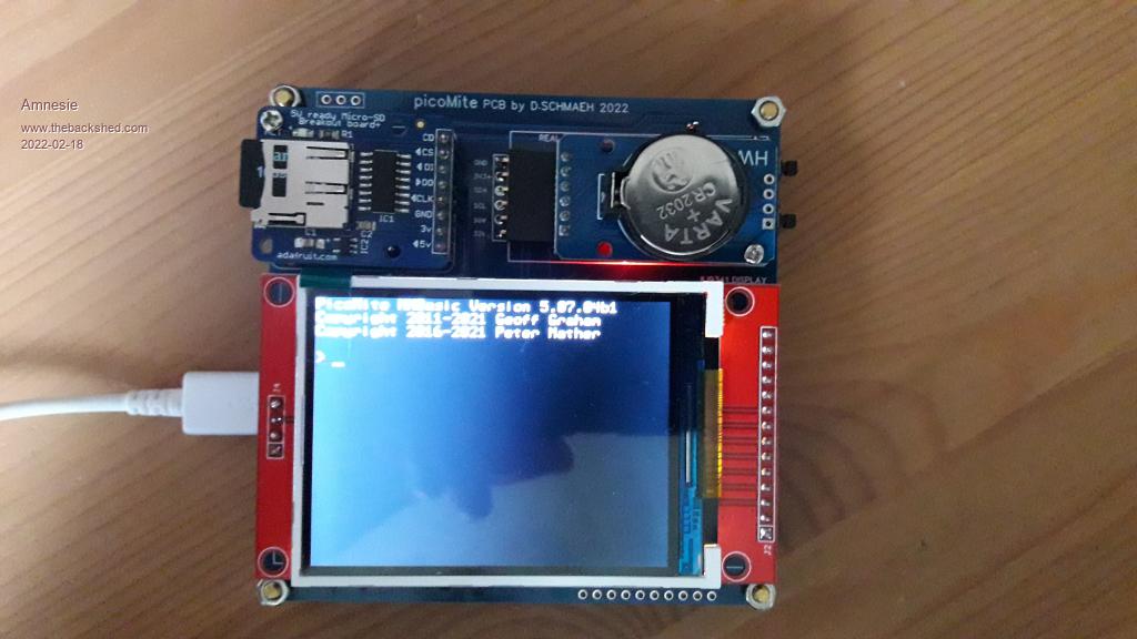

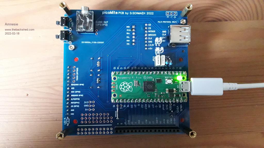

  Quote   I can imagine that this requires the ILI9341 to connect to it's own SPI bus, and not share this SPI bus with the touch and SD card.
This way all my own designed PCBs would be useless... If Peter decides to work on this I hope there is another way. Hm... but I guess this is the risk... aaaaaand design a new one .... :/
-Daniel
