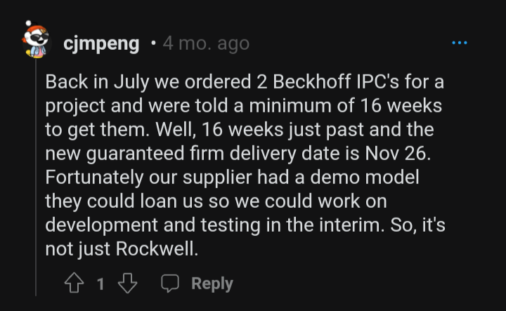

Probably directed @Volhout ![]() What is with this thing? I mean, I have been aware of it but never really got to know it. Over-priced? Over-hyped? Over-complicated? I have been studying and all I do is SMH....I would never consider using this. I have clients in deep trouble. They can't build machines because Beckhoff can't deliver. Pushing me to complete my Propeller P2 motion controller. @Volhout; is this EtherCAT just another dumb religion? I can't identify a single positive feature. It's like you can't even sneeze without the appropriate license and for this, I'm seeing numbers like $2,000 Regards, Craig |
