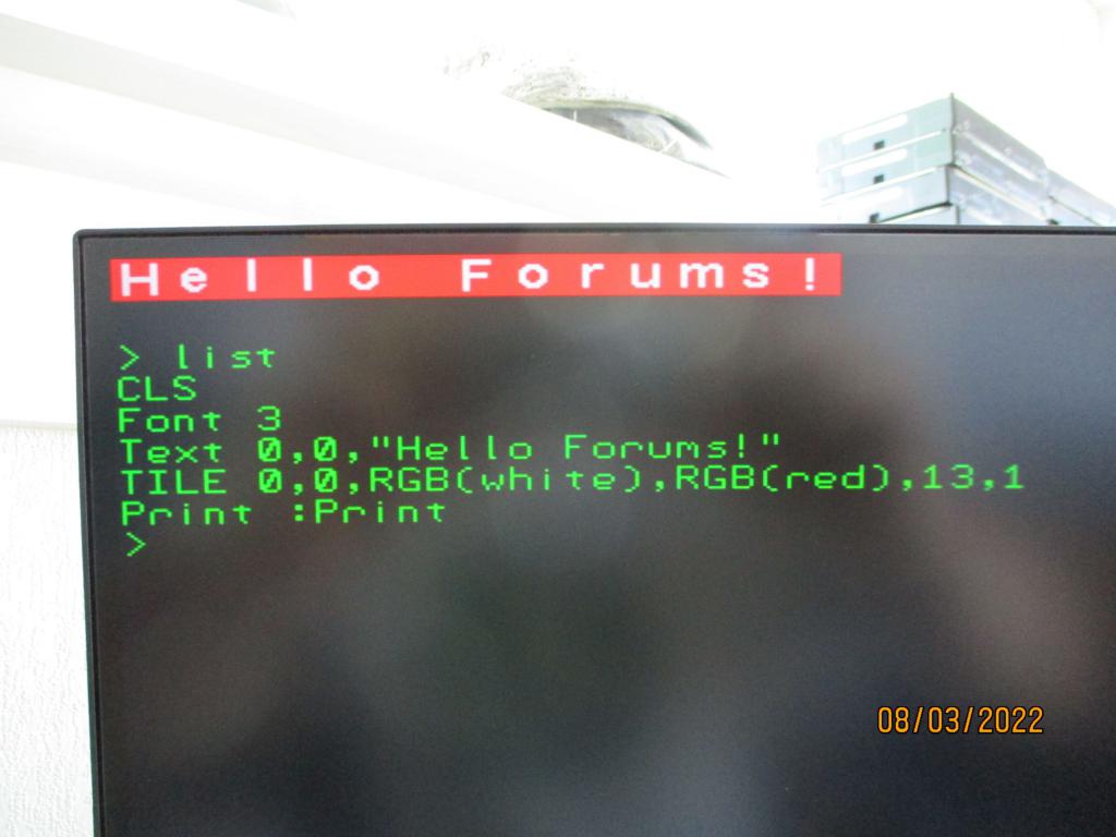

To change the colour of the text, you first write the text to the screen(after setting the default foreground/background), and then use the TILE command to change the colour of the text/background at any one point on the screen.
When the TILE command co-ordinates are the same as the text you just wrote to the display, then the text colour changes at that point, but not via the TEXT command.
That's how I understand it, anyway.
EDIT - Like this:
Edited 2022-03-08 11:00 by Grogster

I can re-create Geoff's error.  I was thinking of MODE 1 @ 640x480 and how to do the new colours.  Geoff is quite right, in MODE 2, which is standard colour VGA mode, it throws an error if you try to do as in Geoff's example at the top of this page.
EDIT: Whoops!  Our posts are overlapping!  But quite correct - I had that totally wrong, and there is an issue there.
Edited 2022-03-08 11:22 by Grogster
