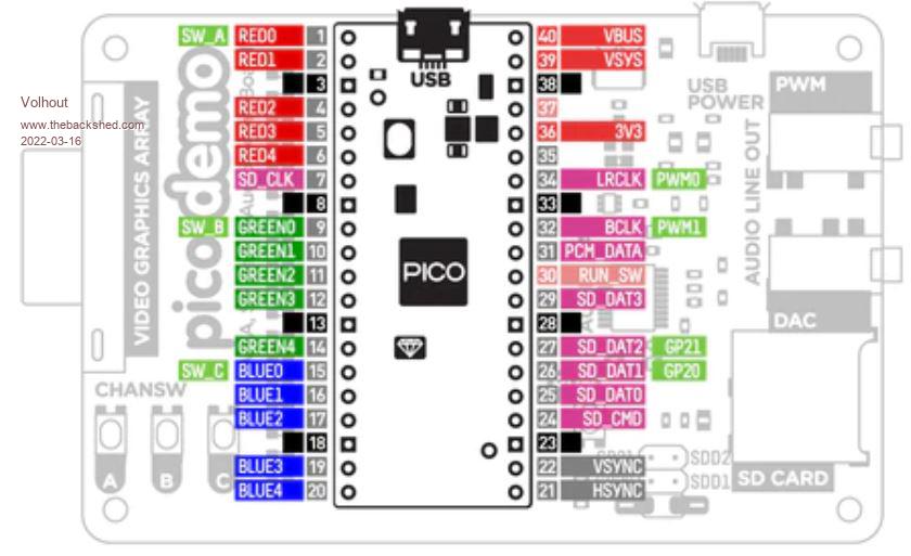

But what I find amazing is that their website spends a lot of time talking about how they built the game but there are no practical details.  For example, what are the pinouts for the VGA?  And the Audio?  Game play keys? And so on.  I could not even find a compiled .uf2 file.

  Quote  For example, what are the pinouts for the VGA?  And the Audio?  Game play keys? And so on.  I could not even find a compiled .uf2 file.
https://github.com/kilograham/rp2040-doom/releases/tag/v0.1
Designed to run on this
Note he is clocking the Pico at 270MHz so may not run on all boards
UPDATE
Load the 4Mb uf2, you need a usb keyboard connected to the PICO USB port so will need other power. I've got it up and running - very very impressive

They must use GP20 and GP21 for the I2C interconnect in multiplayer.

The board has PWM audio
Posts: 11512
Posted: 12:36pm 16 Mar 2022
  Quote  The board has PWM audio
The code uses the DAC on the board not PWM
   struct audio_i2s_config config = {
           .data_pin = PICO_AUDIO_I2S_DATA_PIN,
           .clock_pin_base = PICO_AUDIO_I2S_CLOCK_PIN_BASE,
           .dma_channel = 6,
           .pio_sm = 0,
