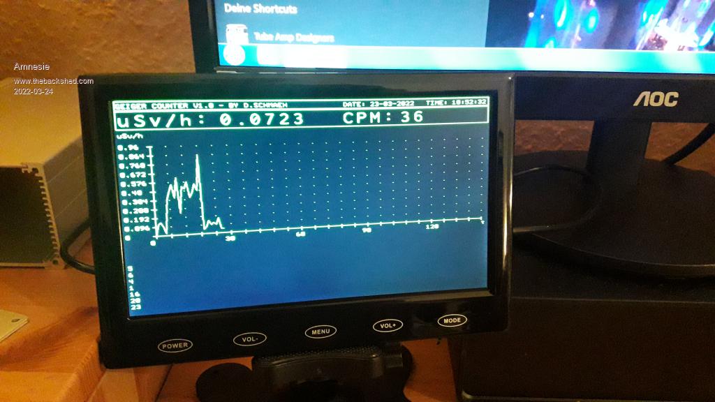

Hello again,
this time I am working on a geiger counter (yes somehow triggered by the global 'events', but I have many gm-tubes flying around anyway).
First: I am not in an age who is grown up with BASIC, so please keep in mind I am still lerning :)
PROBLEM: The interrupt works perfectly fine with a small pause (~ >= 50ms) but does not with NO pause in the main "Do Loop". Without a pause, the "count" variable will not catch every interrupt.
This is somehow counter intuitive for me, because I learned to keep everything short as possible and don't use any delay / pause since this is "bad practice".
Is this behavior normal and I don't understand some fundamentals you could eventually point me at, or is it a bug? Why is a small pause in the "Do Loop" important for the interrupt service routine to count a variable up?
Here is my full code with the remark in the Do Loop:

Posts: 4369
Posted: 10:53am 24 Mar 2022
Hi,
I'm not sure if it explains your problem, but SetTick fires an MMBasic software interrupt - you should do minimal processing within these, and your drawGraph() sub doesn't count as minimal processing.
1. Use SetTick to set a flag 'redraw% = 1' indicating it is time for a redraw.
2. Convert drawGraph() into a proper subroutine with SUB ... END SUB instead of using a labeled "GOSUB" .
3. In your main loop add:
If redraw% Then
   drawGraph()
   redraw% = 0
EndIf
Hope this helps,
Plasmamac

Posts: 5931
Posted: 11:43am 24 Mar 2022
Hi Amnesie,
Your program is the "school-example" why the majority of software developers hate Basic.
You use GOTO inside a loop to jump out of the loop and re-enter.
drawAxisGrit:
min = 1
'MAIN LOOP #################################################
 If xProgGraph=626 Then GoTo drawAxisGrit 'If End of Scale redraw
 Pause 100 'EXTREMLY IMPORTANT WITHOUT, THE LOOP IS SOMEHOW TO FAST TO REACT?!
I am abolutely not sure if this relates to your problem, but it is better to change the section of code that is in drawAxisGrit into a sub.
sub drawAxisGrit
end sub
and then remove the "GOTO".
to initialize, you simply remove the ":" (=colon) behind the label, since that will execute the sub.
Edited 2022-03-24 21:45 by Volhout

Amnesie
Joined: 30/06/2020
Posts: 757
Posted: 12:06pm 24 Mar 2022
  Plasmamac said  whats your device? and MMB version
MMBasic Version 5.07.04b8   (VGA)
as far as I know the latest...

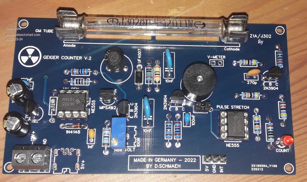

Amnesie
Joined: 30/06/2020
Posts: 757
Posted: 12:11pm 24 Mar 2022
  Plasmamac said
whats your device ?
where do you get   0.0241 ?
neat idea , are the ebay things ok or must i build my own also ?
gefaellt mir,gruss
Danke!
I get the 0.0241 (conversion factor) by testing it with our official local radiation counter in our city and I do have some weak radioactive probes. Sadly I have no datasheet for this kind of tube...
you can get gegier counters on eBay, but the shipping is slow from China and it is way overpriced so I built my own version of it, which works perfect. You can get the parts and tube in germany for really cheap!

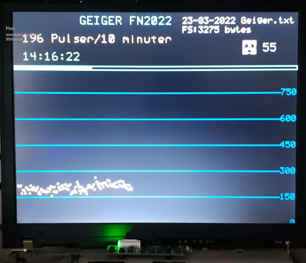

I have a similar kind of Geiger-meter (RadiationD v1.1 CAJOE from AliExpress) connected to PicoMiteVGA. My initial problem was to have Pico to recognize the pulses.
The pulse out from Geiger is a short dip to "0V" and 5V between the pulses. I tried with serial resistor on the input to Pico; many pulses were missed. The final solution was to put a 47k potentiometer across the Geiger output and connect the wiper to PicoMite's input and adjust the idle voltage to about 3V. That seems to allow Pico to catch all pulses.
I am counting pulses over a 10 minute period before plotting and saving to SD-card. Normal level is about 200 pulses/10minutes.
Only recording nbr of pulses; No calibration to real radiation level. Tested by keeping a Americum radiation source from a smokealarm close to the tube and there was an enormous increase in pulse rate. I hope to never see that under normal (abnormal) measurement conditions!
/Fred

  Pluto said  I have a similar kind of Geiger-meter (RadiationD v1.1 CAJOE from AliExpress) connected to PicoMiteVGA. My initial problem was to have Pico to recognize the pulses.
/Fred
WOW This is so cool to see someone else is also interested in this and built something upon this.
I dealt with the same "problems" with the 0 .. 5V pulses, I came up with exactly the same solution, just a voltage divider and it works... BUT ONLY WITH THE PAUSE in the Loop, I am wondering all the time... Since geiger counter (even the china ones) are really expensive I built my own version for about 20Euro and ordered some PCBs...

This is my Geiger-code:
'MMEDIT!!! Basic Version = Pi_5.05.01
'MMEDIT!!! Port = COM28:38400:10,300
'MMEDIT!!! Device = Pi_5.05.01
'PicoMiteVGA. Displays Geiger-counter data on VGA-display.
'Counts the Geiger-pulses over 10minutes and displays data.
'Stores data on SD-card for each 10 minute period.
'RadiationD v1.1(CAJOE). Output from Geiger via headphone jack.
'47k potentiometer used as voltage divider for input to PicomiteVGA.
'GP6 is used for pulse counting.
'RTC module for time. DS3231M module (note: diode not removed.)
'Fred 15.3.2022.
'setpin GP0,GP1,I2C
RTC GETTIME
cls
TEXT mm.hres/2-30,10,"GEIGER FN2022 ","CM",1,1,rgb(cyan)
dim Colors(9)=(RGB(yellow),RGB(RED),RGB(magenta),RGB(cyan),RGB(green),0,0,0,0,0)
i=1
j=0 'For changing graph color when x-axis goes back from 320 to 0.
Period=10*60*1000 'measurements collected over 10 minutes.
'Period=60*1000 'For debugging
Ygrid
OldPulCnt=0
'GUI LED #1,Puls,mm.hres*7/8,50,10,RGB(red)
Circle mm.hres*7/8-15,40,10,1,1,RGB(red),rgb(bLACK)
load JPG "Radiation2.jpg",mm.hres*7/8-22,32
'Circle mm.hres*7/8-15,40,5,1,4,RGB(red),-1
'Circle mm.hres*7/8-15,40,20,1,0.35,RGB(red),-1
'open "Geiger2.txt" for append as #1
DataFileName  'Create a name for the file where data is stored
do
 timer=0
 setpin GP6, CIN 'GP6 is one of the default counting pins.
 do
   text 10,50,time$,"LM",1,1,RGB(green)
   ProgressBar 'Shows the progress of the 10 minutes measurement period.
   NewPulCnt=pin(GP6)
   IF NewPulCnt>OldPulCnt then
   OldPulCnt=NewPulCnt
   Circle mm.hres*7/8-15,40,10,1,1,RGB(red),rgb(RED) 'indicator for rcvd pulse.
   text mm.hres*7/8,40,STR$(NewPulCnt)+"  ","LM",1,1,RGB(white)
   Pause 100 'Just to keep the indicator briefly on.
   Circle mm.hres*7/8-15,40,10,1,1,RGB(BLACK),rgb(BLACK)
   end if
   'pause 500
 loop until Timer>=Period
 OldPulCnt=-1
 timer=0
 Pulser=PIN(GP6)
 BOX i,(mm.vres-Pulser/5),2,2,1,Colors(j),Colors(j)
 TEXT 10,30,str$(Pulser)+" Pulser/10 minuter  ","LM",1,1,rgb(Yellow)
 open NewFileName$ for append as #1
 print #1, Date$+","+Time$+","+STR$(Pulser)
 Close #1
 FS$=str$(mm.info$(filesize NewFileName$)) 'Size of present data-file.
 Text 190,20,"FS:"+FS$+" bytes  ","LM",7,1,rgb(white)
 i=i+1
 if i>320 then i=1:j=j+1
 IF j>=4 then j=0
 pin(GP6)=0
loop
'close #1
end
sub DataFileName
NewFileName$=Date$+" Geiger.txt"
Text 190,10,NewFileName$,"LM",7,1,rgb(white)
end sub
sub ProgressBar
IF Timer<1000 then BOX 0,60,mm.hres,5,1,RGB(cyan),RGB(black)
box 0,60,mm.hres*timer/Period,5,1,RGB(cyan),rgb(Cyan)
end sub
SUB Ygrid
xres=mm.hres
yres=mm.vres
'line 0,yres,xres,yres,1,rgb(gray)
'line 0,yres/8,xres,yres/8,1,rgb(gray)
'line 0,yres*2/8,xres,yres*2/8,1,rgb(gray)
line 0,yres*3/8,xres,yres*3/8,1,rgb(BLUE)
line 0,yres*4/8,xres,yres*4/8,1,rgb(BLUE)
line 0,yres*5/8,xres,yres*5/8,1,rgb(BLUE)
Line 0,yres*6/8,xres,yres*6/8,1,rgb(BLUE)
line 0,yres*7/8,xres,yres*7/8,1,rgb(BLUE)
 PAUSE 10 'pause for making the whole gr
'text xres-60,yres/8,"3.5","LM",3,1,rgb(Yellow)
'text xres-60,yres*2/8,"3.0","LM",3,1,rgb(Yellow)
text xres-0,yres*3/8,"750","RM",7,1,rgb(BLUE)
text xres-0,yres*4/8,"600","RM",7,1,rgb(BLUE)
text xres-0,yres*5/8,"450","RM",7,1,rgb(BLUE)
text xres-0,yres*6/8,"300","RM",7,1,rgb(BLUE)
text xres-0,yres*7/8,"150","RM",7,1,rgb(BLUE)
text xres-0,yres*8/8,"0","RM",7,1,rgb(BLUE)
'text xres-0,0,"4.0","LM",1,2,rgb(Yellow)
'for k=0 to xres step 200
'for m=0 to yres step yres/40
'text k,m,"+","CM",1,1,rgb(gray)
'next m
'next k
end sub
When the graph has reached the right end of the screen, it will jump back to start and plot the next set of data with an other color. In that way there can be a quite long datatrend visible and it is easy to see if there is something else than background scattering.
Just above the graph is a 10minute long progress bar. Just to see when following datapoint is to be expected.
I bought the Geiger-board several years ago and it has kindly rested in a box on the shelf until recently.
Yellow dots and blue grid came just by "accident", but I recognize now that these are also the Ukrainian colors!
/Fred
