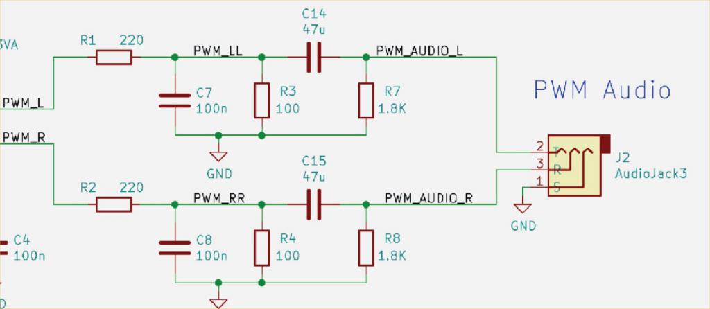

  Quote  https://geoffg.net/Images/Maximite/SchematicLarge.png
The caps create a low pass filter, they do not decouple the output. The other resistors form part of the filter and also a voltage divider. Component values are not critical. My board copies:
Here is the recommended circuit from the RP2040 H/W manual
Posts: 8911
Posted: 08:52am 29 Mar 2022
That's a good circuit in that it takes any DC bias off the output using C14 & C15 (+ end towards R3 and R4 if polarity conscious) and makes sure the caps are discharged using R7 & R8 so there is less of a switch-on pop. Output is set by the ratio of the first two resistors - about 1V.

Since the PicoMiteVGA board has a 3 pin header for Left, Right and Ground, I'll need to attach the 3.5 mm stereo jack on a small plug-in board. I'm wondering if I should wire a pair of 47 uF to 100 uF caps in series to the outputs. Would it also help if I reduced the 4.7 K resistors to 2.2K resistors and added another pair of  2.2K resistors in series,  on the stereo jack board?
Edited 2022-03-29 22:25 by al18
Posts: 8911
Posted: 01:21pm 29 Mar 2022
It all depends on what you want to connect the output to. :)
For headphones I'd try a 680R upwards resistor and nothing else. The combination of the resistor and the inductance of the headphones will create a filter to smooth out the PWM. If it's too loud then increase the resistor value.
For a line output where having DC on the outputs doesn't matter I'd use either of the original or VGA version circuits.
For a line output without DC on the output the circuit that Peter has just posted is as good as any.
Reducing the 4k7 resistors to 2k2 without making any other changes will just about double the output voltage. The values aren't critical. Put some bits on a breadboard and see which you prefer. :)

Swapping the 4.7K resistors for 2.2K has improved the volume thru the headphones. I'm happy
