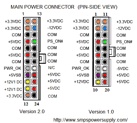

Hey Graeme
I just happen to be looking at ATX power supplies because I have used the ATX-Pico type with my mites. They provide everything that I need; 3.3v, 5v, +12v, -12v.
A couple of the pins...I'm not absolutely sure what they do but it might be worth checking before going-off on a tangent.
Craig
Posts: 8904
Posted: 08:20am 01 Apr 2022
I've seen this a lot, using PC power supplies as general purpose ones. It's not something I would recommend unless you need the current for stepper motors or something as there is no current limiting. It's either there or not - and it takes quite a bit of load to shut down the supply.
Having said that, I have one with terminals on it in the shed just in case...  :)
The extra four pins on the V2 connector are often on a 2x2 connector that fits on the end of the 20-pin one.

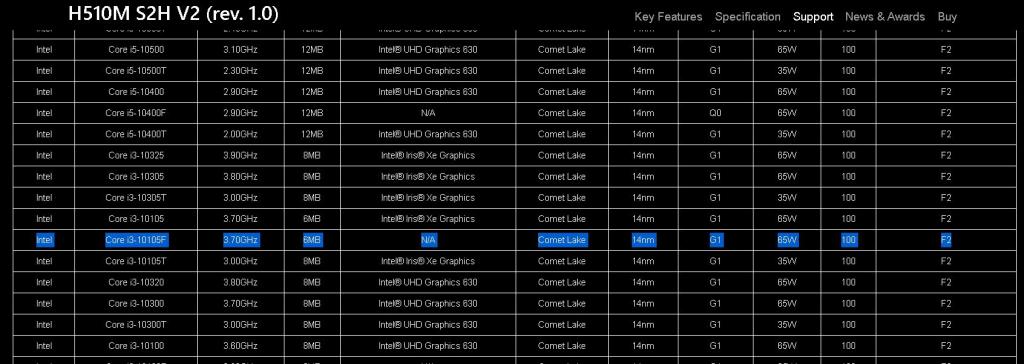

Posts: 9975
Posted: 11:29pm 01 Apr 2022
Thanks for all the replies chums - I appreciate it.
I looked up the Gigabyte supported CPU list here.
The CPU they are using is an Intel "i3-10105F, 3.7GHz, 6MB Cache, LGA1200"
According to the list, this CPU is not supported without an add-on graphics card?
The "N/A" in the graphics column is defined at the top of the list as "Not support", so I think I need to add a graphics card before the board will start, as this processor appears to JUST be a processor and has no integrated GPU so the video sub-system cannot be started, therefore....CPU error.
Failing that, I think I need to get a CPU that HAS an integrated GPU, and that will probably solve the problem I think.  I expect they got the i3 they have, as it was the cheapest i3 they could find new, but that might have caught them out there!
Stay tuned for more updates.

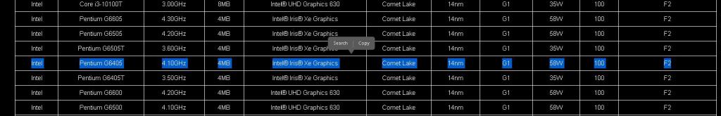

EDIT: I can get an Intel Pentium Gold processor in LGA1200 for about the same price as the i3 they got, but the Pentium Gold DOES have an integrated GPU, and it IS on the supported CPU list, so I think I might just try plopping one of those in the board instead.
Thoughts?

Posted: 12:49am 02 Apr 2022
Grogster, I think you nailed it. I googled that chip and found:
Does Intel Core i3 10105F have graphics?
This processor does not have integrated graphics, you will need a separate graphics card.
Edited 2022-04-02 10:50 by al18
Posts: 9975
Posted: 06:39am 02 Apr 2022
YES - have the CPU power connector in place - 2x4 pin yellow and black wires for CPU power.  Has always been connected, all I get are beeps.
More research confirms that the i3 CPU they put in it, does NOT have an internal GPU, so the system probably is complaining via beeps, as it cannot find a video sub-system to start.
As there is no PCIe card, the board defaults to expecting a GPU as part of the CPU, and as there is no GPU on the i3 F suffix, I am getting the "CPU error" beep code, although, it is technically a 'I can't find a video sub-system to start' error code in this case.
With that in mind, I have ordered a GeForce GT 710 PCIe graphics card to plug into the system and see if I get lucky that way.  I found an old GeFORCE 210 PCIe card, but all I got were beeps with that one too, but I have a feeling it is simply too old a graphics card, but it was all I could find on the shelf.
If the board still refuses to POST with the new graphics card in it, then I think I must definitely have a dead motherboard.  I welcome any comments on my logic to this point, but I have tried everything else other then a different CPU that does indeed have an embedded GPU as well.
