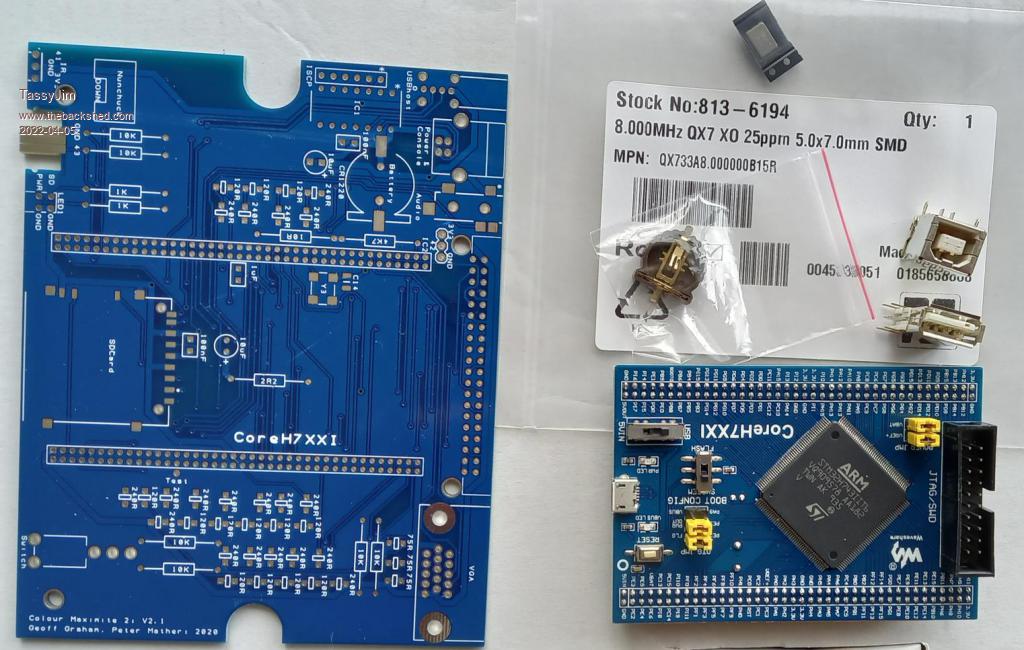

I have surplus CMM2 parts for sale.
This is the CMM2 Generation 1
Waveshare module. New with the latest CMM2 firmware loaded. It has a V revision chip so will run at full speed.
Circuit board V2.1 This board has the provision for the 8MHz oscilator mod and mainly through-hole components.
8MHz oscillator module
Both USB ports.
Battery holder.
2mm pitch sockets for the Waveshare module.
Will not split and prefer ship to AUS due to postage rates for overseas.
Price $75 express postage included.

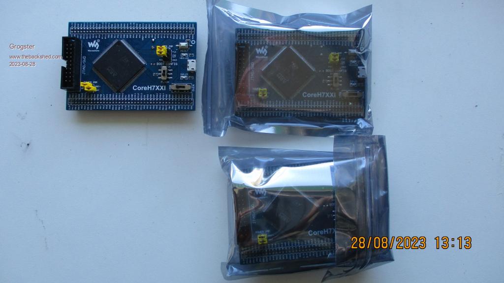

If Jim cannot help, I can:
I have three, two still sealed in their original bags.
The one out of the bag, will have some version of the firmware in it already.
I never bothered to offer these on my website, or even here on the forums, as I expected no-one wanted them anymore, with the all-in-one PCB design being the default standard, and the gen1 design not really desirable - up until the chip shortages during COVID.
If you or anyone else is interested, send me a PM and we can make a deal.

Those pics have made me quite nostalgic, with memories of soldering those 2mm connectors and having to do the clock mod later. :)

The latest PCB has provision for an external 8 MHz crystal oscillator to replace the 8 MHz crystal on the Waveshare CPU board. This may be needed in some rare cases where a monitor has difficulty with some VGA modes (such as 800x600 pixel 16-bit colour).
Most people will not need this modification however, if it is required, it can be implemented by installing the external oscillator and a capacitor on the motherboard (under the Waveshare CPU board). The 8MHz crystal on the Waveshare board does not have to be removed.
The parts required are:
1 SMD 1206 100nF ceramic capacitor
1 8MHz oscillator in 5.0 x 7.0 mm SMD package (QX7 XO 25ppm). Eg, RS Stock Nbr 813-6194.

As shown in the photos, the board I supplied has the pads for the oscillator and I have supplied the required oscillator.
I would strongly advise that the oscillator is used.
Posts: 8904
Posted: 08:28am 01 Sep 2023
Oh yes - It hadn't dawned on me that it was in the pic! - Need to clean specs more often. :(
+1 It's almost certainly easier to install before the adjacent connector!
