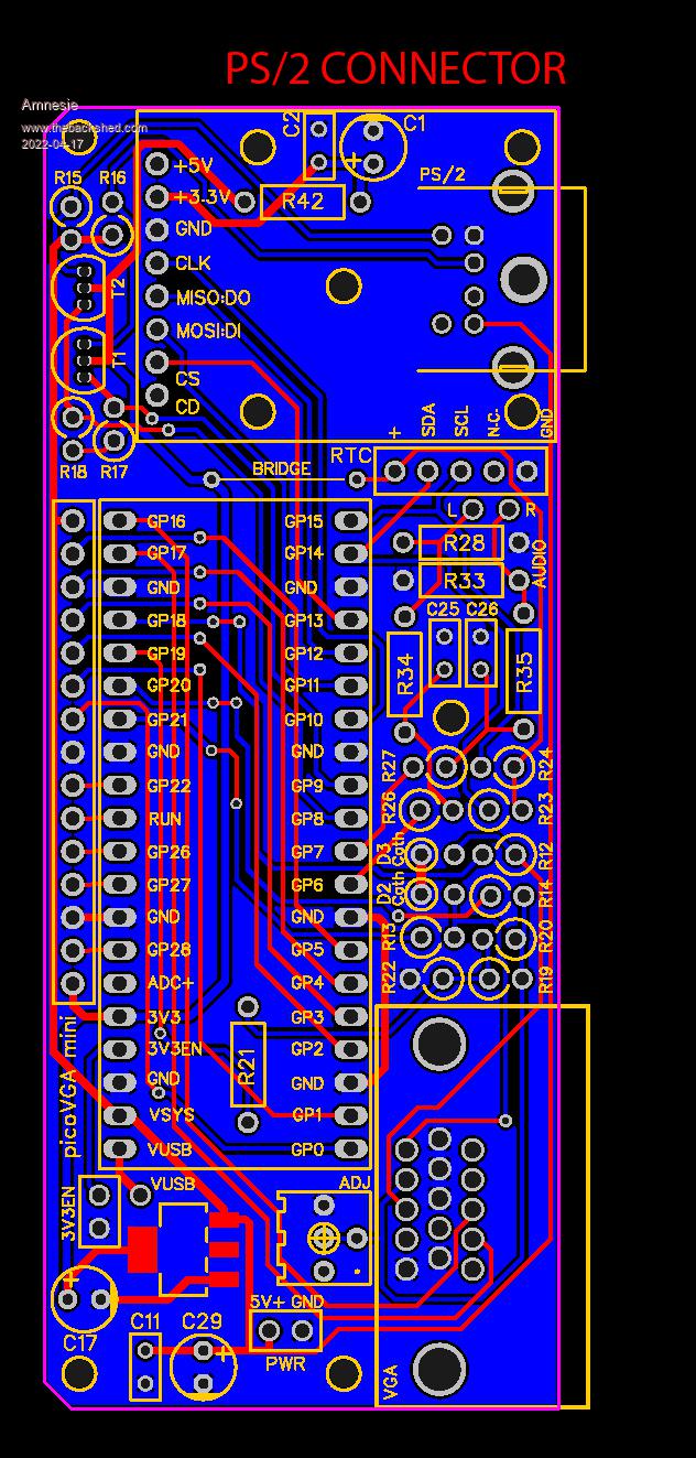

Hello everyone,

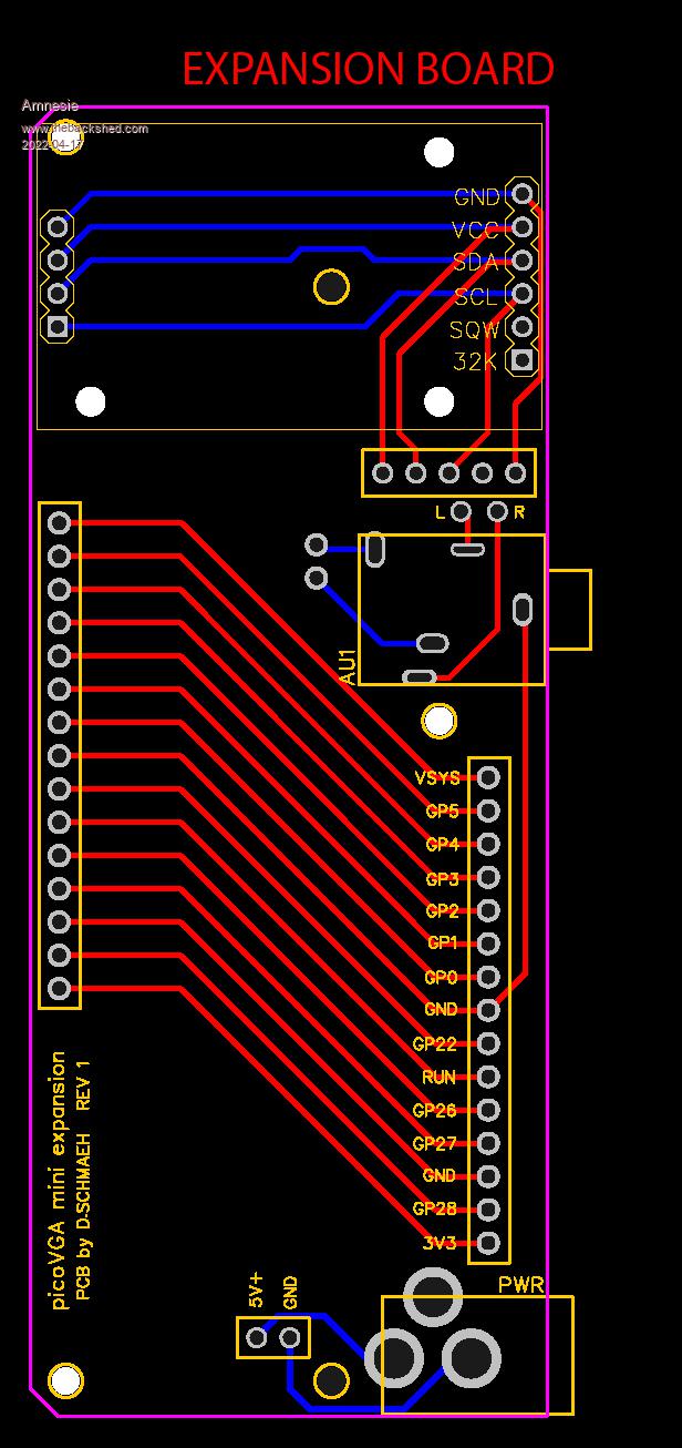

I am opening a new thread for this, because I decided to release a simple and plain "mini" version of the picoVGA, which you can expand with an expansion board by utilizing the female / male headers on the board to connect them properly. The expansion board offers a bigger Real Time Clock, not the mini version, which is more common and you can change the battery. Also the GPIO is lead to the external this way and a barrel jack can deliver all the juice :)
I decided to give you two versions of the picoVGA mini, one has got a PS/2 connector, the other has a normal USB connector. Why? Because I have only one single keyboard with a PS/2 connector, all other keyboards are equipped with USB-connectors which support the PS/2 protocoll, too. This way you don't need an adaptor and you don't need too big standoffs / spacers for the adafruit micro SD breakout. Speaking of that, it uses the blue one, that is "5V ready". I have really great experience with the superior quality of adafruit and not the cheap ones (gold contacts etc.)
Important to know is that the silk screen orientation of the level shift transistors on my version appears to be turned 180 degree, this is because I am using the more (at least where I live) common 2N7000 transistors. So this is not a fault, keep in mind that you can use other transistors.
The board is double checked and I am ordering some tomorrow at JLCPCB. I am publishing here my Gerbers and "raw" EasyEDA design files, so you can do what you want with it.
Use it as inspiration for own designs :)
The original intention was to create an "as small as possible" board to fit in a keyboard, but more and more I realized, that it is not possible without pure SMD technique (at least to make really sense). A pure SMD version will come at a later point in time.
PS/2 Version:
USB Version:
Expansion board:
Gerbers & "raw":
Gerbers.zip
Have fun with it!
Greetings
Daniel

Fantastic...Just what I was looking for!  Only 1 problem, it appears as though the gerber file for the USB version, is actually the PS2 version.
 In my excitement at seeing this design, I uploaded the "USB" to JLPCB, only to realise when it was too late, that it was in fact the PS2 connector version.
 I also checked the PS2, version - same (PS2 connector).
 Can you pls repost with the USB connector version, so I can do another order (I hate those ps2/usb adapters).  :-) Many thanks, and great work!

Ah, sorry! I don't know how this could happen, here are the correct USB Gerbers!

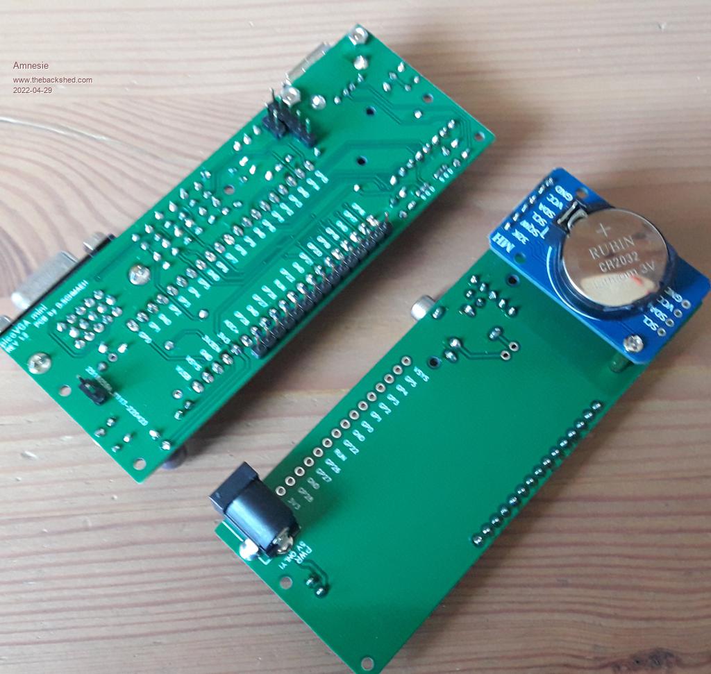

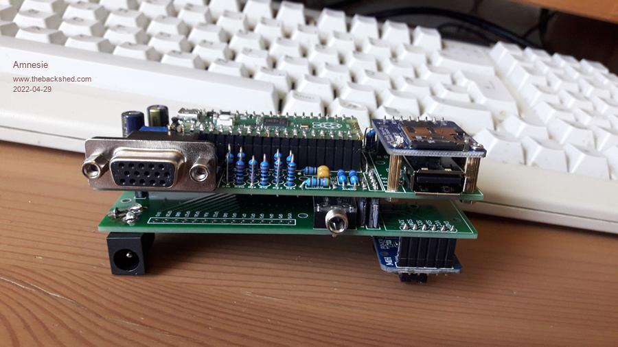

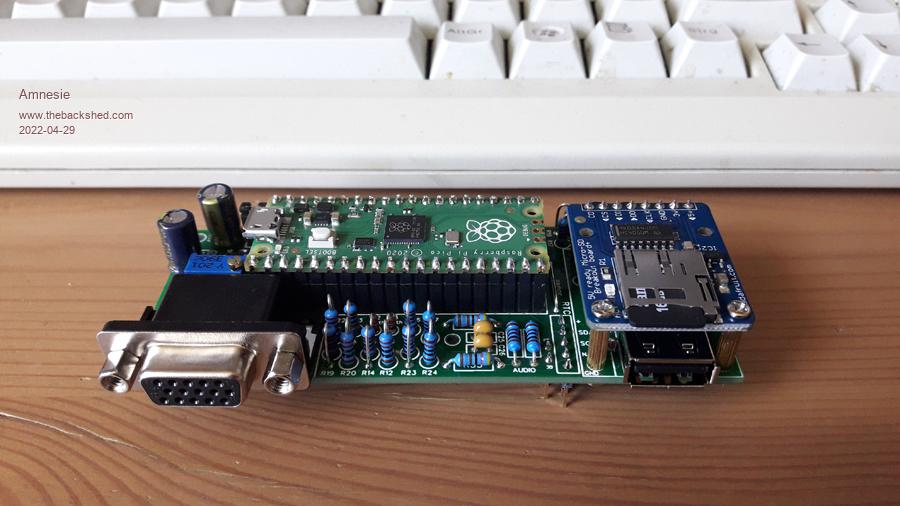

It's all done and tested; here are some pictures and new Gerbers for exactly this version:
Gerber_mini picoVGA_expansion_2022-04-28.zip
Gerber_mini picoVGA_usb.zip
Posts: 3784
Posted: 04:16pm 28 Apr 2022
Nice work. Congratulations.
TheRockGod
Joined: 01/04/2022
Posts: 8
Posted: 09:34pm 28 Apr 2022
That is a work of art!!!   My boards haven't arrived yet, but tracking indicates they are close (in Australia)...hopefully, within a few days :-)
Rickard5
Joined: 31/03/2022
Posts: 463
Posted: 04:58am 29 Apr 2022
GOD I love that, Looks like an IBM Model M Keyboard is going to be sacrificed. as soon as I can get those off to get boards made I'm building a few :)
Posts: 5931
Posted: 05:32am 29 Apr 2022
Realty love to see this mounted inside a keyboard. Stacked together thee are pretty high.
