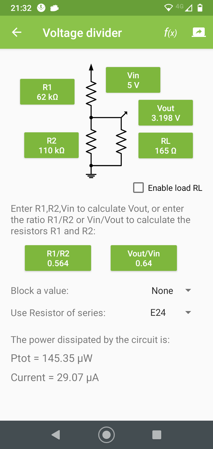

Hello everybody I'm trying to figure out how to hookup the HC-SR04 o the Picomite and the only info I found was from the manual :
  Quote  Using a HC-SR04 ultrasonic sensor and the DISTANCE() function you can measure the distance to a target.
Any PicoMite I/O Pin
On the PicoMite you use the DISTANCE function as follows:
    d = DISTANCE(trig, echo)
The value returned is the distance in centimetres to the target.
Where trig is the I/O pin connected to the "trig" input of the sensor and echo is the pin connected the "echo" output of the sensor. You can also use 3-pin devices and in that case only one pin number is specified. The maximum voltage on the PicoMite’s I/O pins is 3.3V so a resistor divider will be required to interface the PicoMite to the echo pin of the sensor (which operates on 5V).
my question is, so how do I build this Resistor Divider? and what pins do I use ?

This is from my Android app "Electrodoc" (nice).
Play with combinations that suit what you have in stock or whatever power dissipation you want to shoot for.

I doubt if the Pico input will load that with 165R!
Try 3.3K on top and 6.8K on the bottom to give 3.366V off-load. The Pico input is pretty high resistance but that is safe and will drop a little further.

so VCC goes Strait to 5v pin
GND goes strait to GND pin
ECHO goes straight to an input
and Trig goes through visitor ladder ?

  Rickard5 said  so VCC goes Strait to 5v pin
Thanks Guys
I feel Dumb but I don't know
TRIGGER goes straight to an output
and ECHO goes through resistor ladder to input

Getting the exact resistors isn't very important. Just make the bottom one twice the value (or a little less to be safe) of the top one.
Other examples:-
5.1k, 10k
12k, 22k
2.7k, 5.1k
The required voltage ratio is
3.3 / 5 = 2/3
So you can use any three of the same value in series to get an exact division of 2/3.

Cut 5V simply in half works fine too.
Anything over 2V is probably logic true.
You can hit anywhere from there to 3.3V.

Using 50% is borderline and there's no real need to do it. It increases problems due to noise on the signal and supply lines. e.g. you have a Pico input that happens to need 2.1v (within spec). If you use 50% then you have to guarantee an output of 4.2V. If your "5V" rail is at 4.7V then that may not be possible.
Also, don't use too high a value if using a potential divider for level shifting into MOS logic. Inputs have a high impedance and capacitance so high resistor values will slow the logic down. That can lead to all sorts of interesting bugs to find. :) You generally have plenty of current to spare so use it. Why use a 10uA divider when you can use a 1mA one?
