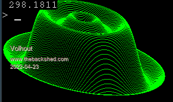

nice graph...
298ms on MMB4W under WINE on linux (between 200ms and 300ms depending the CPU load)
