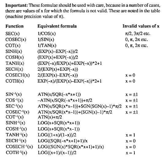

Found this in the appendices of some old reference books.
A bit niche but you never now when you might need a Hyperbolic Cosecant. Just stash it away and if you never need it, be happy
and because I am a sad case, here is the MMBasic for the first group, all tested against Wolfram Alpha. I was going to do the inverse functions too but there is something I need to tweak to get the parsing of the arguments right - it's probably too vague to matter; would anyone ever use them?

Those first 4 in the second group should be done with ATAN2 instead of ATN.

  vegipete said  Those first 4 in the second group should be done with ATAN2 instead of ATN.
I did write the inverse functions (second group) into code and they work OK when you respect the input-value ranges, but the odd 2 or 3 don't agree with Wolfram so some remedial work is required.
There is also a typo in one of them (a bracket missing) but can't remember which off the top of my head EDIT: It's Sech_1
For completeness... I would like to get them all working but I don't think I have ever used them and at my stage of life am unlikely to now. It would be a purely mental exercise.

Yes, I agree these are pretty specialist - I think I used a few of them in my radar work 35+ years ago. TBH I only put them here as it scratches my itch to have all the formulae to maths functions and this reference was the most complete I think I have seen, in some obscure book from the 80s and lost to time... perhaps I breathe on the embers to keep the knowledge easy-access. If it never gets used, no harm done.
