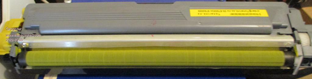

Hi everyone.
@ Rob: Brother HL-3150CDN
I use generic 3rd party toner in by black-and-white only laser printer(Brother HL-1210W) and it never gives any issues at all.
The colour laser printer is also PERFECT on black, just the colour is screwed.
I checked the toner levels, and they are still at 90% or there abouts for ALL toners, drum life is still 90%, belt life is 90%, fuser life is 90%.
So, everything SHOULD be producing perfectly fine output, but anything done in colour is a stripy-streaky mess.
Example:
Note how the gray background is not uniform, and the red has streaks of yellow in it etc.  This is unusable.  I cannot put this on a call-point, as it looks completely unprofessional.
The three colour toners, although they say there is 90% of the toner still left, are NOT giving uniform powder output.  The cyan one is pretty good, but the yellow and magenta ones have lines in the toner output roller, so that transfers to the print.
This is why I don't like or am not really a huge fan of 3rd party COLOUR toners.
YES - I have cleaned them all down with tissue paper, and rocked all the toners back and forth a few times to make sure the toner is distributed etc, and have also cleaned the corona wire thing on all drum units.
NOTHING makes it print any better then in the first horrible image, and it used to print beautifully uniform output on the genuine toners, but I am not prepared to spend almost a grand on f-ing toner - what a f-ing rip-off!!!!
I'd be more then happy to accept any suggestions from the members here, of anything else I could try.

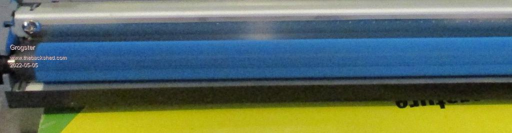

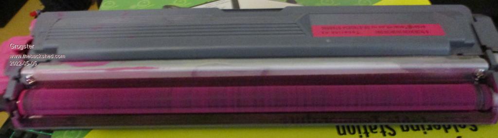

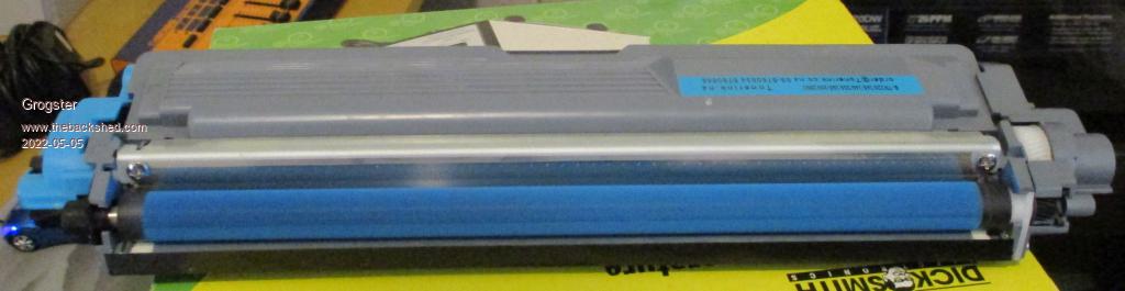

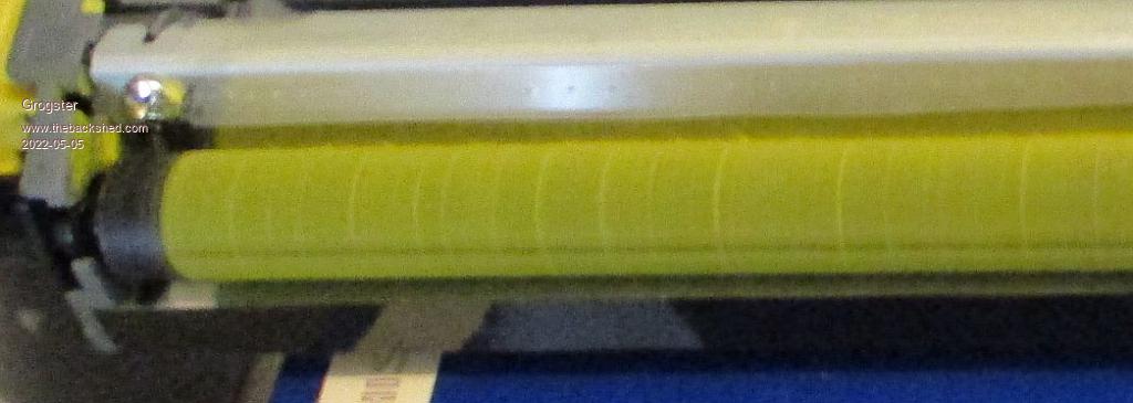

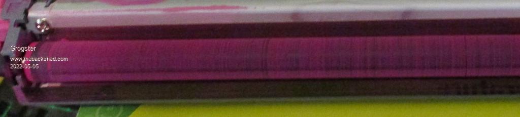

Posts: 9975
Posted: 03:03am 05 May 2022
Here are another couple of close-up shots of the colour toners:
Note how the yellow and magenta ones are NOT giving a uniform powder output, despite the printer saying they have 90% remaining on all three.
The cyan one is much more uniform.
Sorry - these are the best images I can get, as my camera does not have a macro mode on it.
EDIT: I got these from tonerink.co.nz, which is where I normally get toner and ink from.  The black ones never seem to give any trouble.  Perhaps I should try another company?  Do any New Zealand members here have a 3rd-party toner supplier they could recommend?

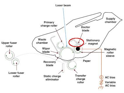

Posts: 2528
Posted: 06:04am 05 May 2022
it looks like the 'doctor blade' is gummed up, circled in red in the below diagram:
see this article, contains original diagram and may be worth a read:
http://dimasio.com/printing-theory-part-1-magnetic-toner.html
bear in mind that the above is for a combined toner+transfer roller cartridge, like what HP uses. looking at your images, i'd suspect that the screw at the left of each of your photos is holding one end of the doctor blade in place. it is also possible that you may need to lift out the magnetic roller and clean out any accumulated 'clumps' of toner from behind it.
also be sure to check (perhaps first) that the electrical connection to the roller (marked "AC Bias" on the diagram) is good. i don't know what this bias does, but it may be important to moving the toner around.
rob   :-)
