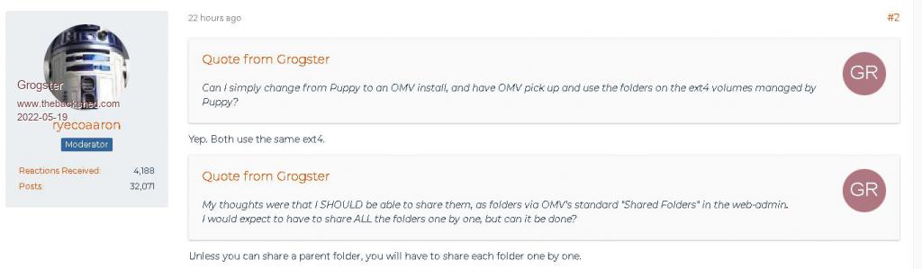

@ Rickard5 - according to the OMV forums, you CAN simply swap volumes from another Linux, so long as they are also ext4.
This suggests that I should be able to do this with no pain at all.
If I move all the folders into one parent folder before I move the drive to OMV, then OMV should only require that I share that parent folder for it to work.
