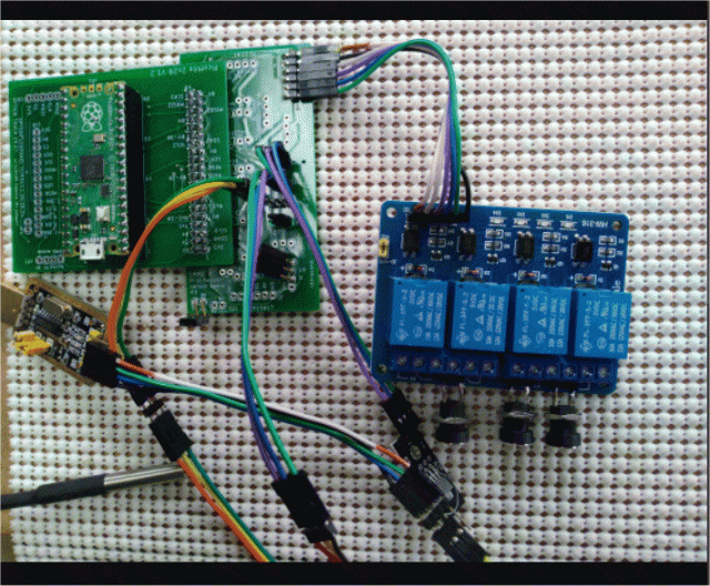

I have a picomite rigged with a 4-relay module (3 being used to turn on 12V LEDs) and two DS18B20 temperature sensors.
Here's the program which the client picomite runs:

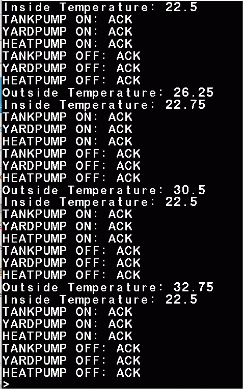

Here's the output on the MMB3W side:
Note the "Outside Temperature" changing as I held the waterproof DS18B20.
If the command sent to the picomite sets the value of s$, then that value is returned. Otherwise, "ACK" is returned for success and "NAK" for failure of the command. Here's the output on the MMB4W side:

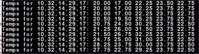

Here's a version of the Picomite client in which the MMB4W PC/serial controller can call a subroutine in which as many DS18B20 temperature sensors as one likes may be called in about one second with TEMPR START performed for each, then a PAUSE 750, and then TEMPR.
' serCli.bas evaluates serial messages
' if first character is "!", text data is to be returned, CR terminate
'   otherwise, single command is to be run with "EXECUTE"
OPTION AUTORUN ON
dim string cmd, s$
dim integer nTemps ', pTemps(12)
dim float fTemps(12)
pause 2000
print "Picomite SerialClient starting"
' SetPin 22,21,com1 ' setpin 21,uart0tx:SetPin 22,uart0rx
' open "com1:115200, 256, SerInt, 4" As #1 ' interrupt triggered with 4 characters
SetPin 11,12,com2 ' setpin 21,uart0tx:SetPin 22,uart0rx
open "com2:115200, 256, SerInt, 4" As #1 ' interrupt triggered with 4 characters
DO ' the program loops forever
WATCHDOG 2000 ' this will recover from errors
LOOP
SUB SerInt ' received a message
  pause 20 ' allow all characters to arrive (11,520/sec, ~230 in 20 milliseconds)
  line input #1,cmd ' cmd=input$(255, #1)
  s$="NAK"
  print cmd;
  on error skip 4
  execute cmd ' e.g., "s$=tempr(17)" for function, "pin(16)=1" for command
  if s$="NAK" then ' EXECUTE didn't fail and s$ not set by command
    s$="ACK" ' returned if "s$" not set by execute and command succeeded
  endif
  xx$="" ' throw away for error
  print #1,s$
  do while loc(#1)>0: cmd=input$(255,#1): loop ' flush the input buffer
END SUB ' return from the interrupt
SUB readTemps ' controller sends, e.g., "nTemps=5" & then "redim pTemp(5)=(10,32,14,29,17)" & then "readTemps"
' ?"readTemps: nTemps="+str$(nTemps)+": ";
 if nTemps > 0 then
   for i%=1 to nTemps
'      ?str$(i%)+" "+str$(pTemps(i%))+"; ":
     if pTemps(i%) > 0 then: tempr start pTemps(i%): endif
   next i%
   pause 750 ' allow DS18B20s to read temp
   s$=""
   for i%=1 to nTemps
       fTemps(i%)=tempr(pTemps(i%)): s$ = s$ + str$(fTemps(i%),0,2) + " " ' : ?fTemps(i%)," ";
     endif
   next i%
 endif
'  ?" "+s$
END SUB
Here's the controller program:
' testSerCliTemps.bas ' test serial client picomite from MMBasic for Windows
const nTemps=5
dim integer pTemps(5)=(0,10,32,14,29,17)
open "com14:115200" as #1
pause 500
print #1,"nTemps=5"
pause 100
print #1,"dim integer pTemps(5)=(0,10,32,14,29,17)"
do
 do while loc(#1)>0: a$=input$(255,#1): loop ' synchronize
 print #1,"readTemps"
 pause 1100 ' allow temperatures to be read
 if loc(#1)>0 then
   line input #1,a$
   ?"Temps for 10,32,14,29,17: "+a$
 endif
 pause 5000
loop
And the serial input returned to the controller:
You can see the temperatures rising and falling as I hold or release the sensors.

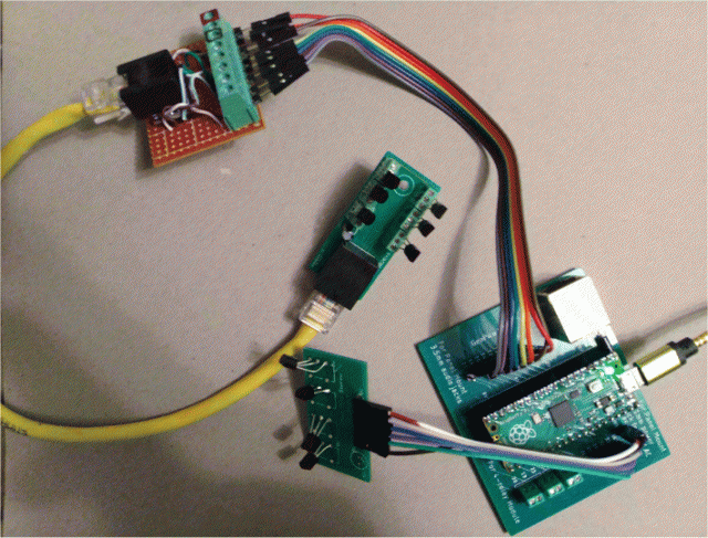

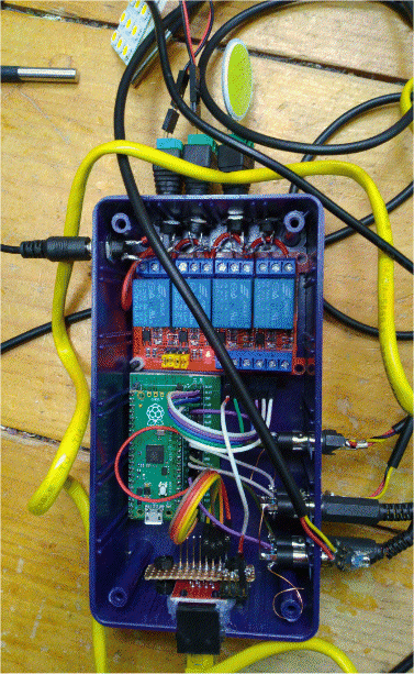

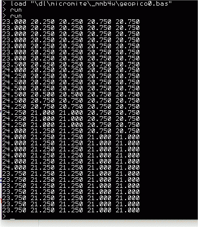

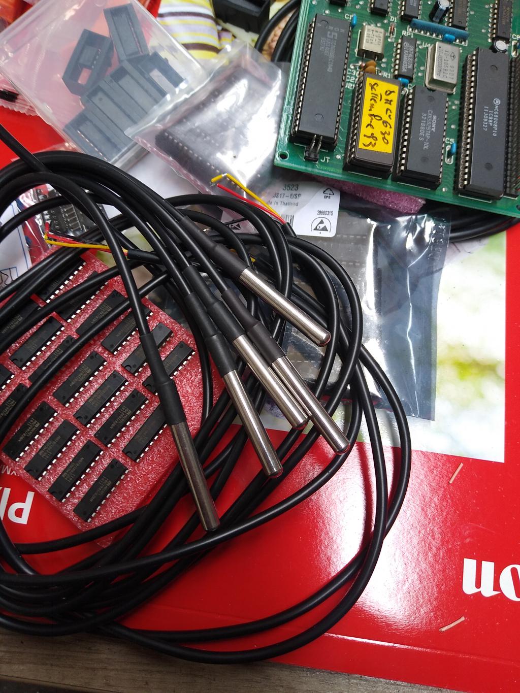

Here's another way to do this--no program at all on the PicoMite client--just MMBasic. Your MMB4W program just acts like a user by supplying commands at the ">" prompt, and interpreting the result.
I set up serial console and connected through 10' of Cat5 with a couple of RJ45 breakout connectors. I used Mixtel90's picomite with 20x2 header, cut out of his "pear" pcb:
This picomite is in a box with a 4-relay module. In addition to the RJ45 connector, the box has 4 power panel mount jack for the relays plus another for the voltage switched by the relays, and 5 panel mount 3.5mm stereo audio jacks for DS18B20 sensors.
I don't have any notable skill as a machinist, even in plastic, but it does work:
The program defines the four pins controlling the relays and sends a SETPIN command for it. Then in an infinite loop it sends a command to randomly turn on or off one of the 4 relays, and to print the 5 temperatures ("? TEMPR(pin#)") separated by a space each. With FIELD$, the program breaks out the temperatures, formats them with 3 decimal points, prints them, and then pauses for 2 seconds.
' geopico0.bas
dim string a,b,c,r,s,t,u
dim integer i,j,k,l,m,n,iONOFF,ledpin(4)=(0,19,20,21,22), temppin(5)=(0,24,29,31,32,34)
dim float d,e,f
open "com5:115200" as #1
s=""
for i=1 to 4: s=s+"setpin "+str$(ledpin(i))+",dout:": next i: ' print s
print #1,s ' +":?"+chr$(34)+"!"+chr$(34) '  "!" to provide response
pause 1000
a=input$(255,#1) ' clear response line
do
 if loc(#1)>0 then
   pause 100
   do while loc(#1) > 0
     line input #1,a
'      print ": ",a
     if mid$(a,1,1)="!") then
       'print a
       s="": for i=2 to 6: f=val(field$(a,i," ")): s=s+str$(f,2,3)+" ": next i
       print s
     endif
   loop
 endif
 s="? "+chr$(34)+"!"+chr$(34)+";"
 for i=1 to 5: s=s+"tempr("+str$(temppin(i))+");"+chr$(34)+" "+chr$(34)+";": next i
 iONOFF=cint(rnd()) ' 0=off, 1=on
 k=fix(rnd()*4)+1 ' pin number index 1-4
 t="pin("+str$(ledpin(k))+")="+str$(iONOFF)
 print #1,t: print #1,s+"" ' : print t+" "+s
 pause 2000
loop
Here's the output; you can see the temperatures change as I touch and release the waterproof sensors:
Here's a youtube video--not much action except for the relays randomly turning on and off 12V LEDs.
Picomite box 4 relays, 5 DS18B20s, MMB4W controlled
Of course, the control program wouldn't have to be on MMB4W--it could be on another Picomite or micromite, or on MMB4L, or on any device with serial output (rewritten for that device).
I plan to test this soon with 50' of CAT5. Wondering if it will still work at 3V3.

  lizby said  I set up serial console and connected through 10' of Cat5 with a couple of RJ45 breakout connectors. I used Mixtel90's picomite with 20x2 header, cut out of his "pear" pcb:
That's a really nice looking box. Just what is needed in a dusty, damp, dirty cellar!
  lizby said  I don't have any notable skill as a machinist, even in plastic, but it does work:

NOW THAT'S A REALLY FANTASTIC LOOKING BOX!!!! Have you ever thought about going into business making boxes? Maybe if you had a 3D printer up there in the wilds of Canada ....

  lizby said  I plan to test this soon with 50' of CAT5. Wondering if it will still work at 3V3.
I think I remember something about needing to send a separate 3.3v conductor to each sensor instead of using a pull-up resistor to power it using phantom power. It should work that way.

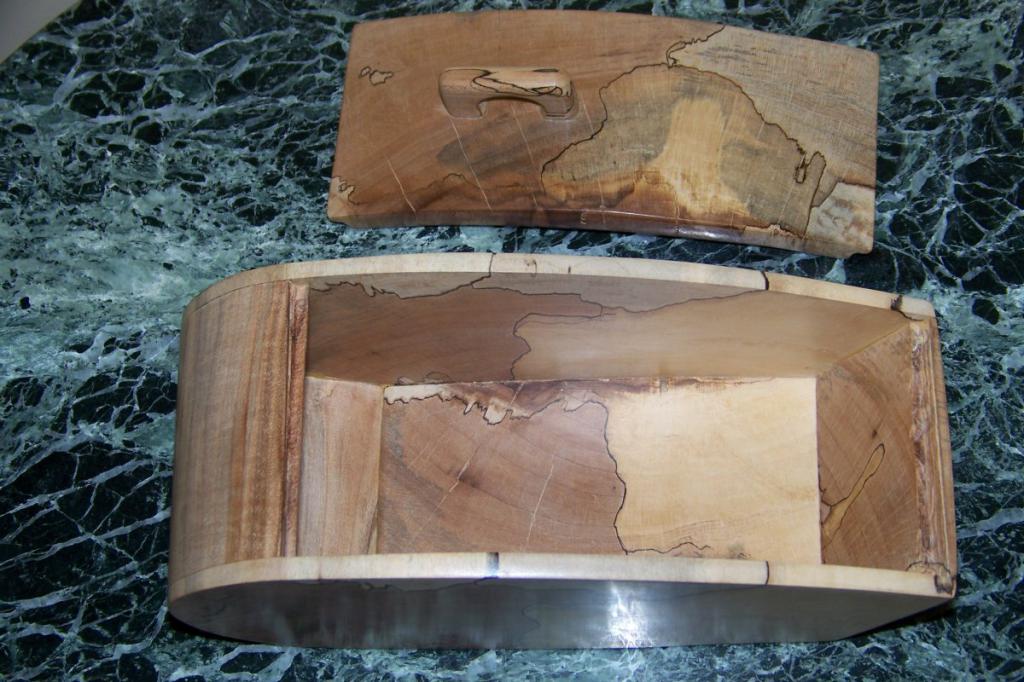

Woodworking is a different matter--I'm comfortable with wooden boxes:

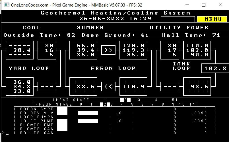

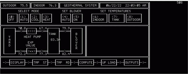

Here's the latest iteration, using Paul_L's PC graphics character display and running on MMBasic for Windows while reading 10 DS18B20 sensors on a Picomite which has no user code--just the MMBasic firmware:
(The "508" in the upper right corner indicates that the program has completed 508 main loops.)
This is essentially throttled by the time it takes to complete a TEMPR START on the Picomite (around 800ms with a resolution of 1/16 degree C), so the MMB4W code only calls on the picomite when the seconds of a time$ call changes. In practice, the temperatures update every second (all 10 sensors), but about once every 8 seconds the time (HH:MM:SS) shown on the second line of the display skips a second.
This is the hardware for test purposes. When I put a finger on a DS18B20, the changes in temperature are reflected in about a second.
I note that there's a spurious zero in the tank center reading. I suspect that's because of a reading of 1000 at some point. I will be checking for readings of 1000 (generally "not connected", but can be spurious) or 85 (probably missing pullup) and logging them.
The code is now 373 lines long--too long to be appropriate for a CODE box, so I've attached the program. The program lacks all of the control code--what to do regarding setting relays as a result of reading these temperatures.
