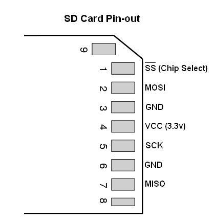

I think roaming around somewhere I think I saw some one some where put legs on a SD card and wire it directly to a Pico? does any one have any information / wiring diagram PLEASE? I'm doing some breadboarding and just want to save the hassle of buying a SD Module

I did it, but it's fiddly. Piccy
I highly recommend that you plug the PicoMite into a breadboard and buy or make a SDcard module. You can make one using a microSD adapter (the ones that come free with microSD cards. You keep them in a box in case they are ever needed). Just solder some bits of bare wire onto the pads and connect them to a bit of header for rigidity, then plug into the breadboard.
Posts: 3290
Posted: 08:20am 24 May 2022
The pads on the adapter are 0.1" pitch so the header can be soldered straight on it.

  Rickard5 said  I think roaming around somewhere I think I saw some one some where put legs on a SD card and wire it directly to a Pico?
is the below thread where you saw this? peter used a micro-SD to full-sized-SD adapter as a socket for the micro-SD card:
http://www.thebackshed.com/forum/ViewTopic.php?TID=13824
MISO, MOSI, CLK, CS are the four signal lines needed, along with 3v3 and ground. the interface is bitbanged, so the four signal lines can be connected to any otherwise unused GPIO pins on the pico.

That is it thanks Good Memory Rob. Is that a resistor across pin 5&6 (and what value)? is there a Pinout Diagram anywhere? I Literally have a Ton of those SD card adapters and it would such a good thing if I could use then instead of paying shipping every time I need a SD card slot

Hi Rick,
That component is the decoupling capacitor between 3.3V and GND
You can also use a wired component.
The values is something like 100nf

here are the pinouts on the (full-sized) SD card:
from: http://www.rlocman.ru/i/Image/2010/06/18/4.jpg
