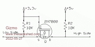

I have probably misunderstood the problem but 3.3V signals can usually drive 5V logic.
If not there are several cheap devices to boost / reduce levels.
Good luck.  Peter(B)

  PeterB said  G'Day Glenn (and Craig)
Good luck.  Peter(B)
Yup, never had a problem driving 5V but for me, the problem is the other way and I don't really care for voltage dividers. I grabbed a bunch of those level-shifters that Mick (Mixtel90) uses and they seem to get the job done. I use lots of MAX491 xceivers which were fine with the 5v-tolerant Rx pins of the PICs but with the Pico, I have to stick with 3.3v and so level-shifting it is.
