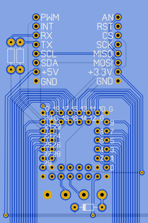

This is something else that started as a wild idea while doodling. It's a sort of design-in-progress that may or may not be attempted sometime. :)  I do these things mostly because they seem interesting. Every one is a learning exercise. lol
This is a logic controller system based entirely on standard PicoMites. A base bord holds a master controller and a number of I/O card slots (I refer to a 6-slot board as having a master + 6 I/O slots). The slots are on a SPI bus, with a CS line each. I've kept it to 9 I/O slots to give a 10-position baseboard. The base shown in the zip file is 100mm x 150mm with 6 slots, but you can get a 3-slot board in 100mm x 100mm.
Using addressable slots in this way uses a lot of pins on the master but gives fast access speed and means that there are no I/O board address switches to bother about. The SPI bus should easily be able to exceed 1MHz, with 10MHz not being unusual - I think that's quite feasible. SPI is handled very neatly in MMBasic so I think it's a good choice.
The master board also carries a buck converter (TBD) to convert the 24V board supply to 5V to feed the I/O modules from the bus. There isn't a lot of current required from 5V, and it means that you can't attempt to run the system without the master card. It has two LEDs, Fault and Run which are fed out to the base, where Fault drives a mosfet with the drain available to connect a beacon or something. The Run signal operates a small relay with a changeover contact giving Run and Off status. COM1 is fed to a connector that could be used for external monitoring or whatever. The master can also monitor the 24V supply to ensure it is within spec for modules sourcing 24V to external loads.
Each I/O board is 100mm x 50mm high and carries pluggable I/O terminals along the top. So, you can get a fully loaded 6-slot PLC into 150mm x 100mm x 50mm.
The number of I/O per board depends on complexity. At the moment I have:
5-way : Opto-isolated input, Monitored IS switch input
8-way : High-side 800mA digital out
10-way : Non-isolated low side digital out, Non-isolated digital in
A 6-slot base could, if you stick with just the 10-way boards, have 60 digital I/O. This is hardly earth shattering for the PLC world, but anything more would have needed bigger PCBs. The advantage of 100x50 is that you can get 2 out of a 100x100 "bargain price" pcb. :)
Note that nothing plugs in apart from the I/O boards into the base and the I/O terminals. This is for reliability. Also, there are no special chips used other than the Pico boards. This is important at the moment as delivery times for even simple relay drivers is silly if you want them from reputable sources. It makes the board much more complex than it needs to be, but hey - it's repairable and this is a hobbyist project anyway. :)

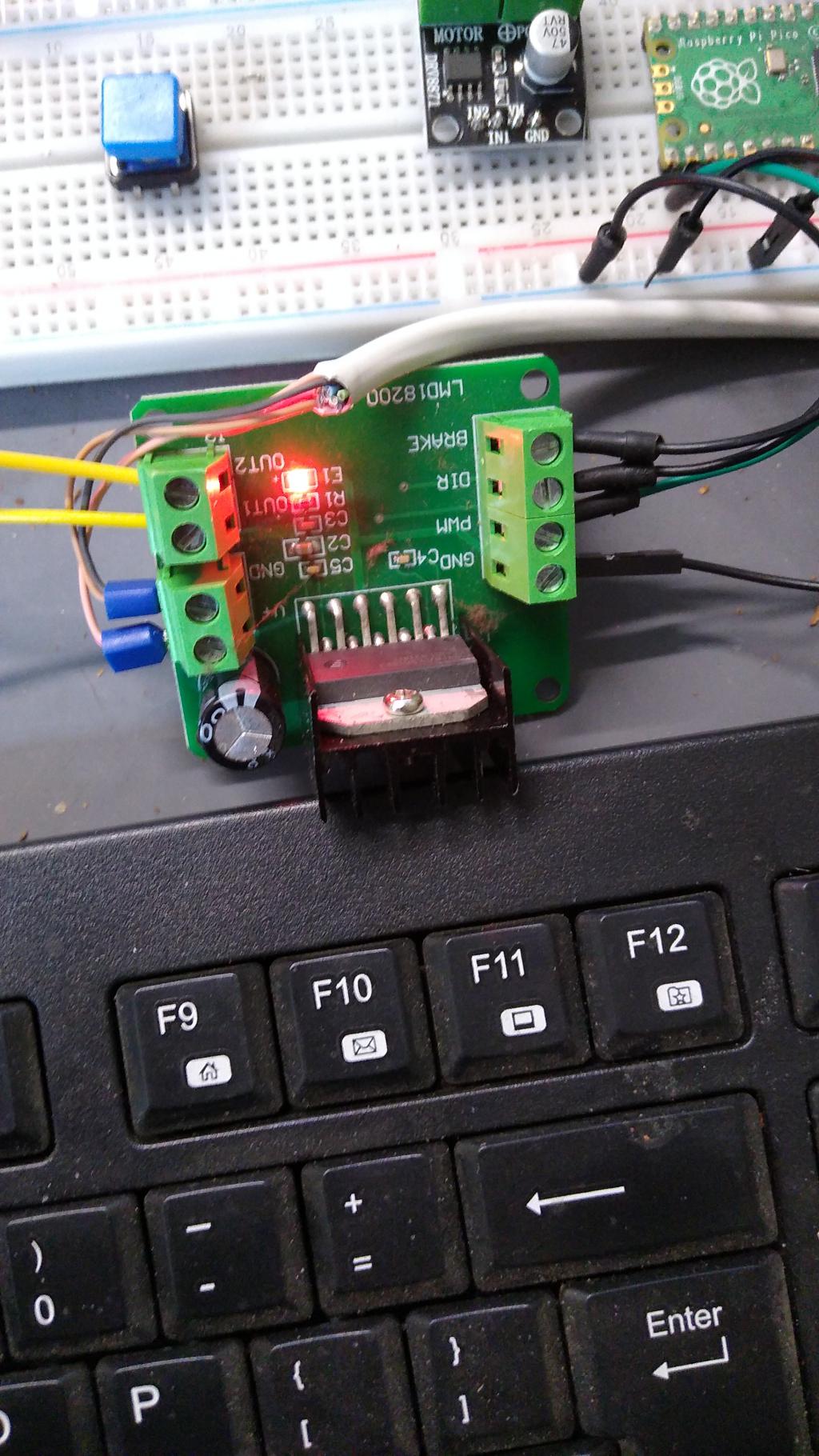

Posted: 01:31pm 02 Jun 2022
I'm messing with the seat-heater that we discussed elsewhere.
Using the Picomite PWM to drive a LMD18200. Every time I would try to change the PWM value from the terminal, the USB would be dead. Everything is hunky dory with the other PSU
